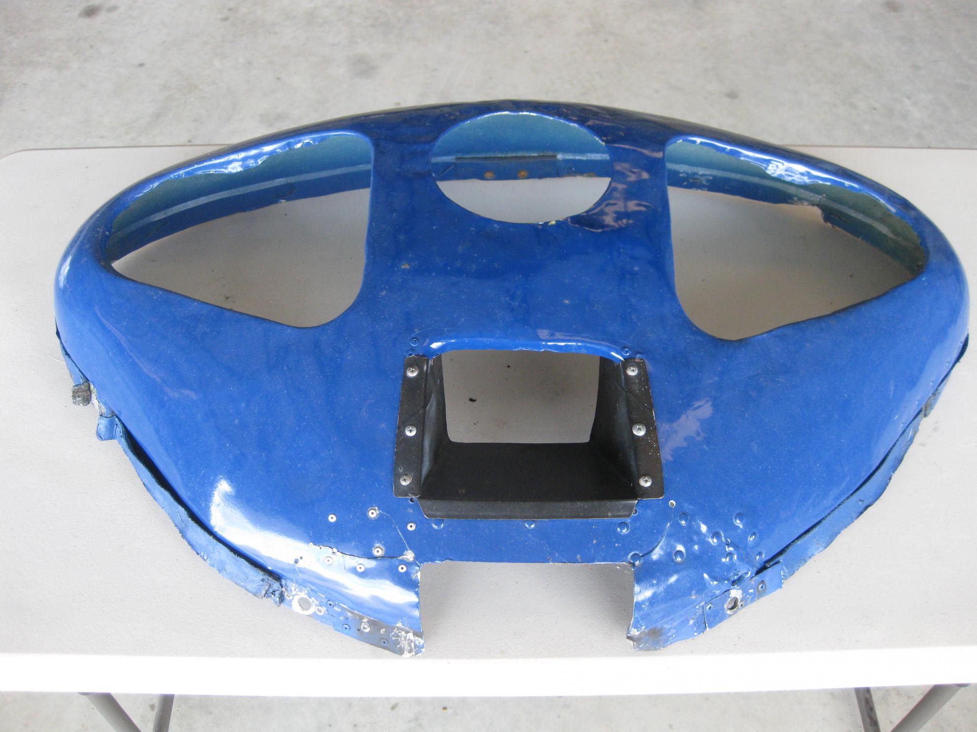

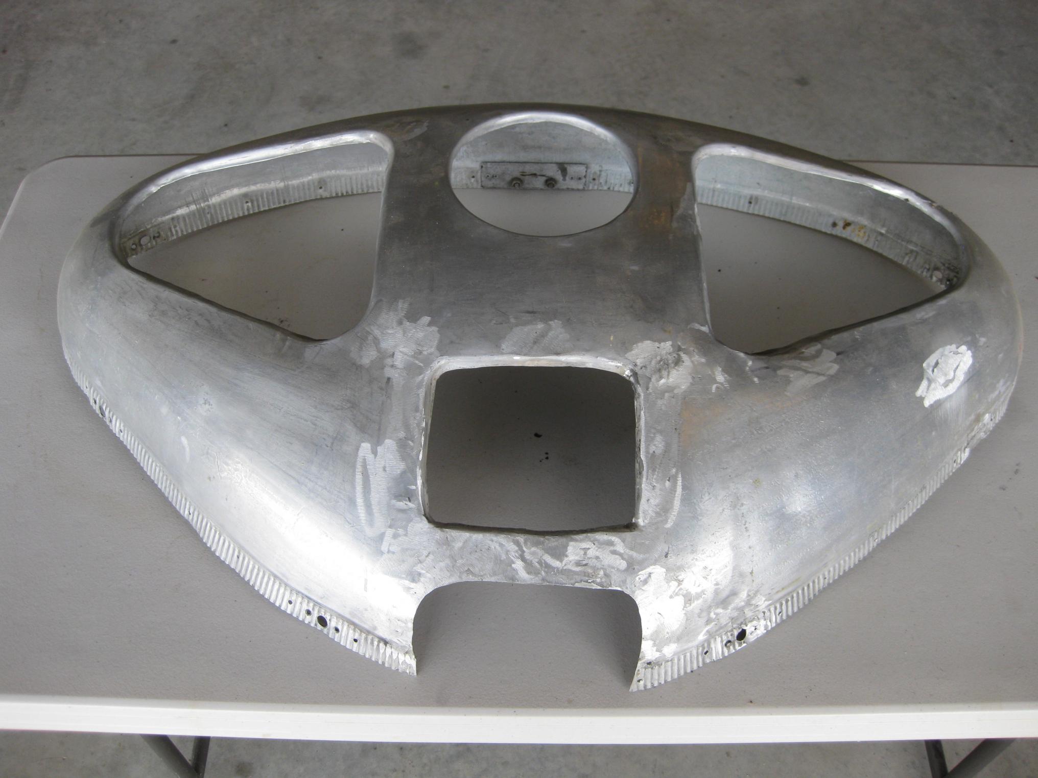

            Carrieve,
            I have a couple of used nose bowls I was getting ready to put on barnstormers or ebay. One was on my Tcraft and has a few repairs and cracks. The other is used and was purchased to replace my original. It has some repairs but could be a good replacement. After I found the one I just mentioned I was lucky enough to find a N.O.S. nose bowl and used that one. PM me if you are interested. I also have a full set of baffling available.
            Greg
            Greg House
            Brookshire, TX
            TF #1089
            BC12-D
