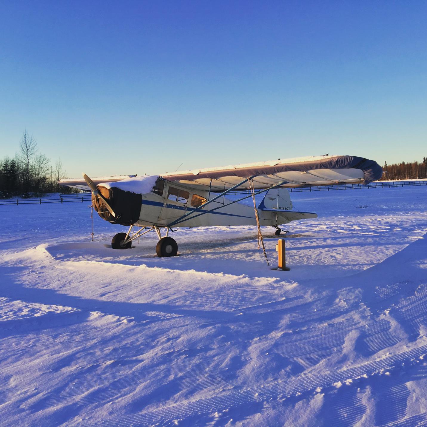

I picked up a nice little F-19 over the summer, got some bushwheels for her this fall when they went on sale, now I need hydraulic brakes. Does anyone have a favorite A&P or IA in Anchorage or the Valley for this mod or Taylorcrafts in general? Also, about how much does it cost?
