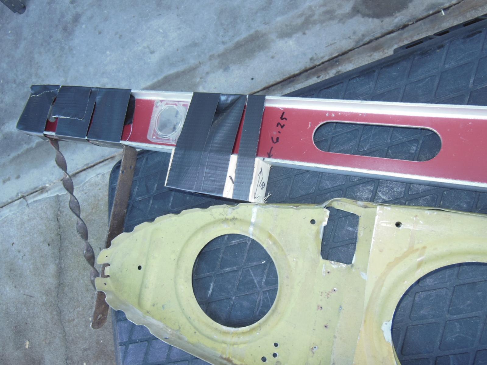

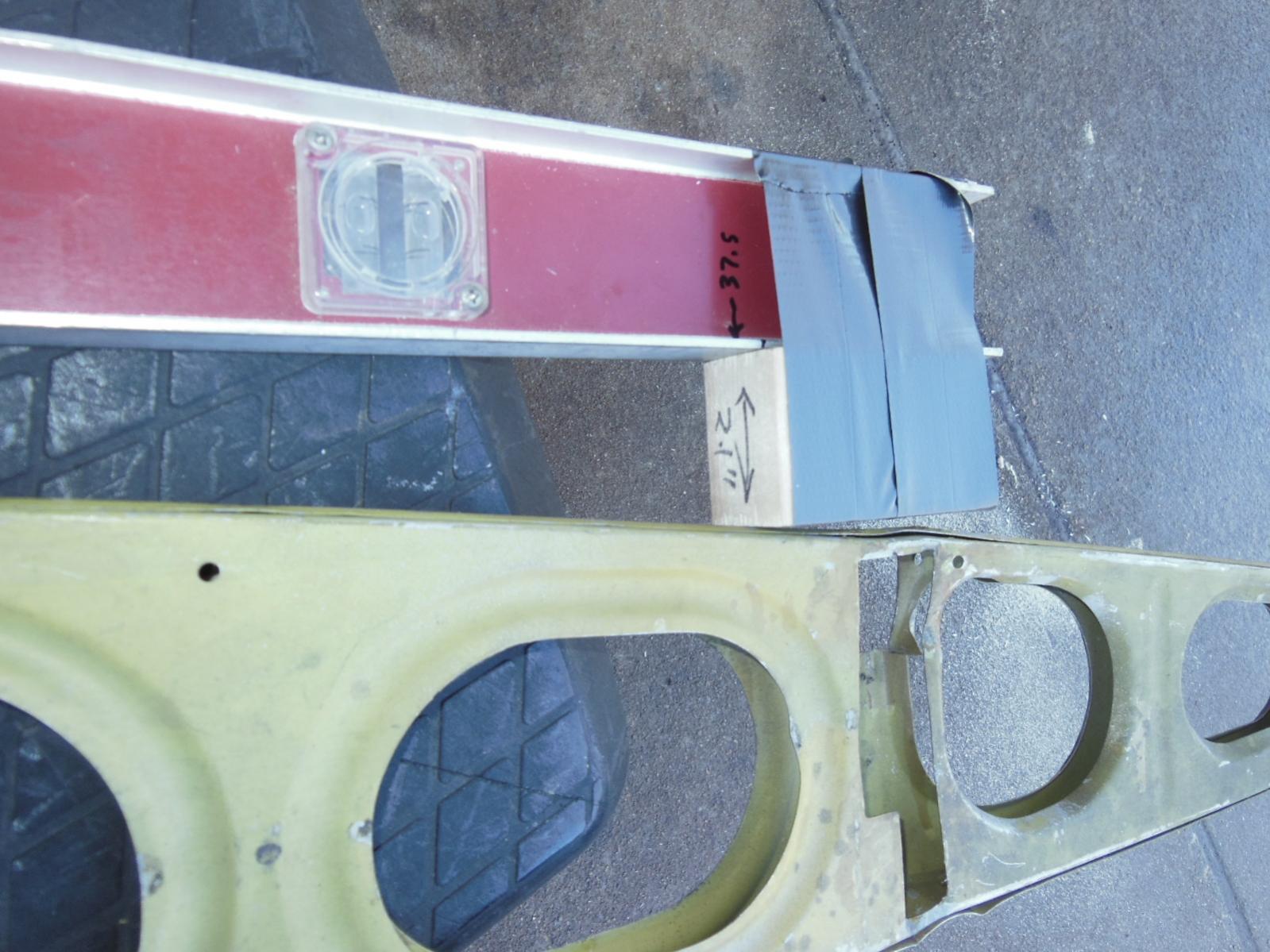

I plan to go to the airfield Monday and take a digital protractor, straight edge, wood blocbs and tape.
Using those materials I hope to make a fixture that can be held on the bottom of a rib with a point on the wood block contacting the rear of the leading edge then measure the angle of the straight edge.
Doing this on the root rib and the tip rib should reveal the twist in the wing (I hope).

I didn't record all of the left wing data because I got panicked after noticing a dent in the leading edge at the very tip.
The root rib angle on the left wing is probably a little large in real life there was slight depression in the LE where the block made contact. I measure the next rib but like I said panic set in and I did things out of order.
Will remeasure all ribs Hank when I go out to fix the tip tomorrow.
I believe the attached data is good, just incomplete.
