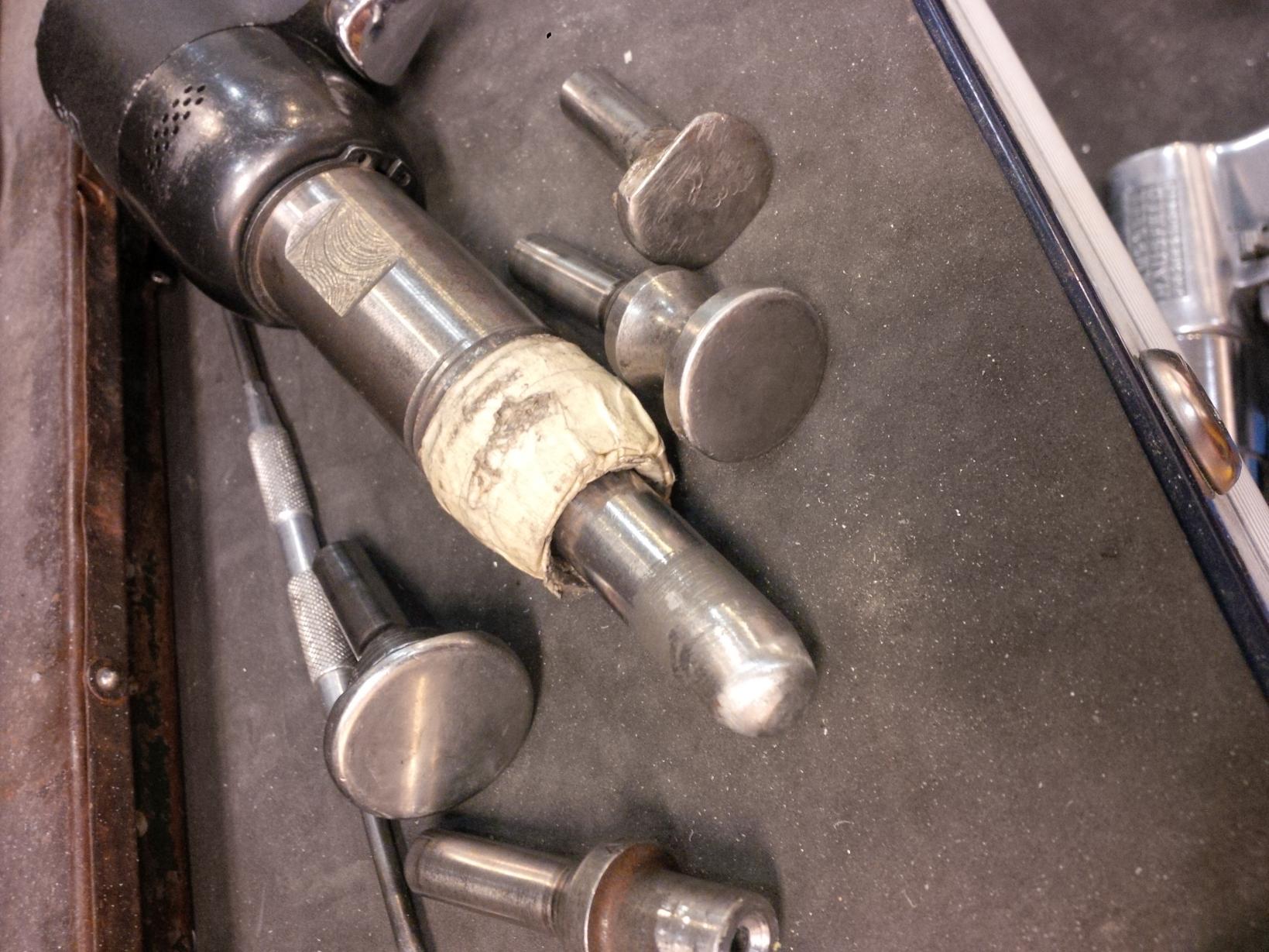

            Have you considered or looked into 'Flow Forming'? This is the process where a rivet gun with special forming bit is used to do the banging (bashing, hammering, etc). What little I know about it, I got from some videos online. I Googled 'flow forming video' and found a couple of videos by Kent White, the Tinman, that show the basics.

              Re: Blog update and Cooling Blurb
              Thanks Mike
              and thanks for the videos.
              I didn't realize there was a name for it but I've long used my rivet gun for forming. My tooling doesn't hold a candle to what Mr. White has made though. I use masking tape and various bits and pieces of nylon in conjunction with various custom and standard snaps. Clearly I need to improve. Perhaps for my next project, given that the heat shroud is the only part I have left to form for CF-CLR.

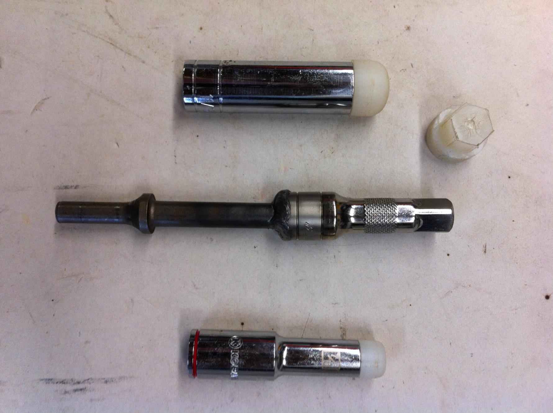

                Yes, the Tinman has some nice tools. Bit expensive for me to try to experiment with. I cut the end off of an air hammer chisel tool, then welded it into the socket end of a short ratchet extension. I used two sizes of deep well sockets and made some inserts out of a piece of delrin rod. I milled a hex on one end to fit in the socket, and turned the other end to shape it. Tried them on a piece of scrap aluminum with little success. Metal was way too hard to shape. Even with a hammer and shot bag. Will try with better suited material.
                I think I will start a new thread to see what other ideas might arise.
