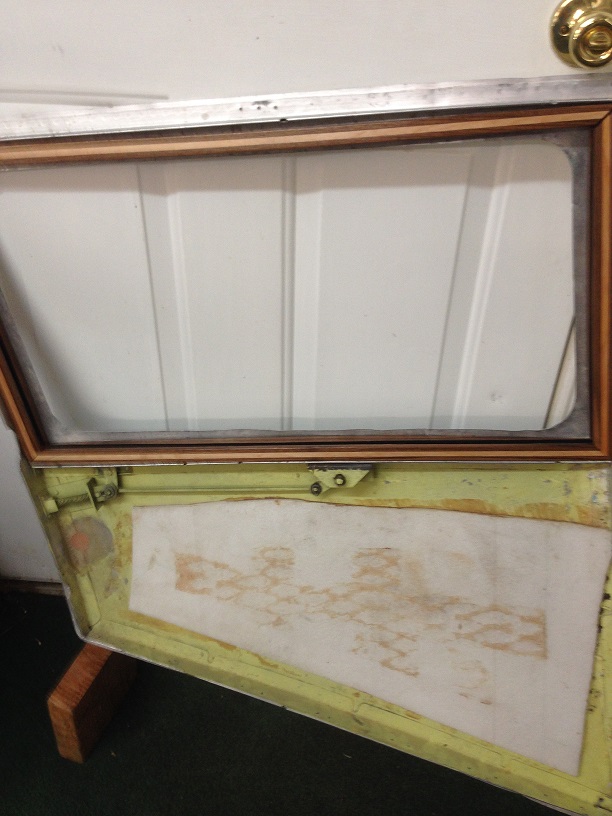

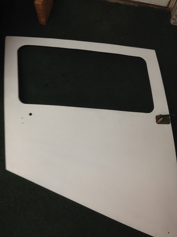

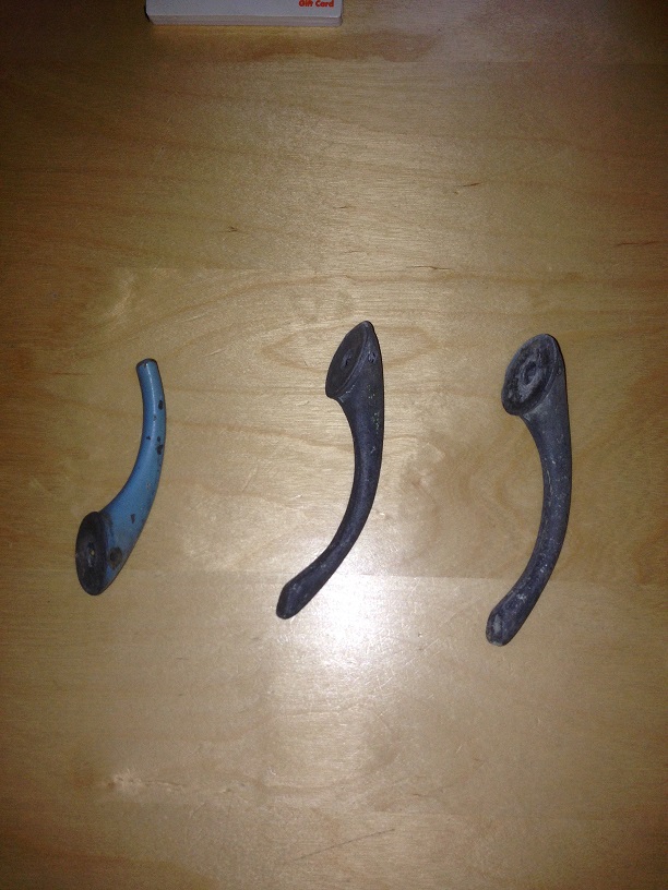

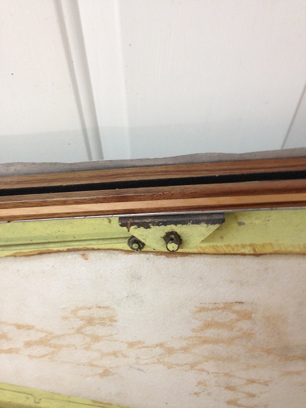

                Looks like I'm just missing one of the shorter ones. Here are some pics of what I have. Also a picture of my doors, one of which has my new wooden window frame.

                  I think the far left handle in your photos may just be a standard 46 handle that has been broken and filed smooth. If so, there are some still available (I have several but they are stuck in doors and I haven't been able to get them loose). Your doors look like standard sheet metal doors but the wood window frames I have never seen before. Looks like someone didn't like the sliding windows and converted them to flip out types. I don't think they are standard but I REALLY like them much better than the standard sliders. A lot of guys would probably like to copy them if they are top hinged flip outs.

                    Thanks for the info Hank. I wondered if that was the case with the shorter handle. If that's the case then I need two more handles. I just finished the first window frame and have one more to make. I saw something like them in an old Beechcraft at the Reno Air Races a few years ago and really liked them. I never really liked the way the T-craft was done. They are not top hinged flip outs. I lined the groove that I cut in the wood with some really thin felt and made it so both windows can slide open and close. It's a laminate of walnut and hemlock.
                    Still looking for two more handles.
