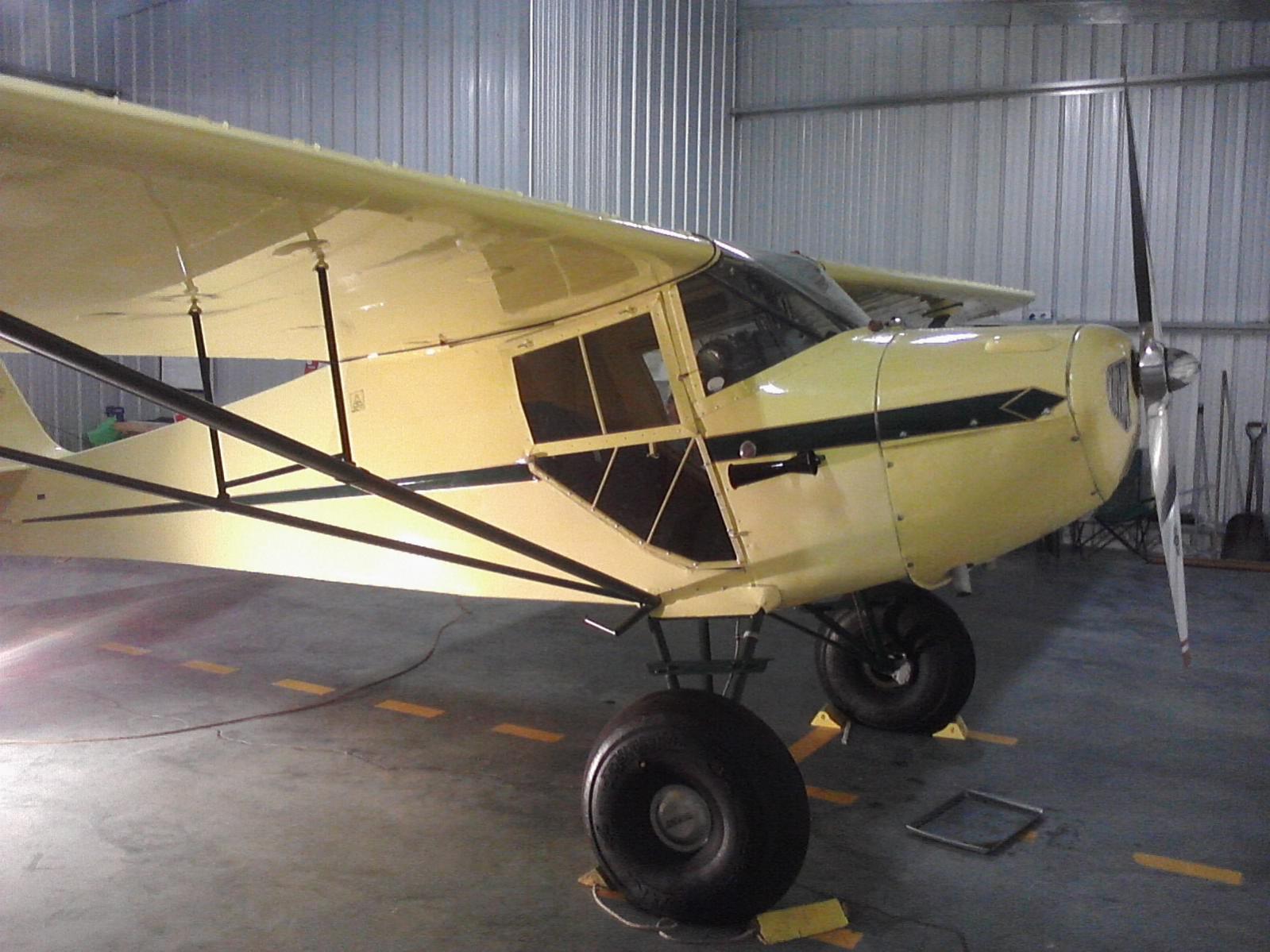

          I have just what you are looking for 1940 pre war C85-12 with a starter grove wheels and brakes for sale.and a hole lot more mods.
          1940 BLT/BC65 N26658 SER#2000

                That plane linked above might be a nice choice. VG's to moderate the stall, large tires to add AOA in a 3-pt configuration, and proper brakes to slow it down that match the size of tires. C-85 and the right prop turning near max static rpm would offer good power.
                Visibility out of the Taylorcraft is different than others, even Cessna's, with larger tires. You have to slip a bit as noted to get a full perspective of the landing zone, then adjust for ground contact. Not a problem just different. They do land different in my experience. The Champs you can get somewhat sloppy on airspeed on final and they'll still head unerringly for the touchdown zone (carrier landings). The Taylorcraft likes to fly and hates to quit the day's fun early so speed control becomes a matter to pay attention to.
