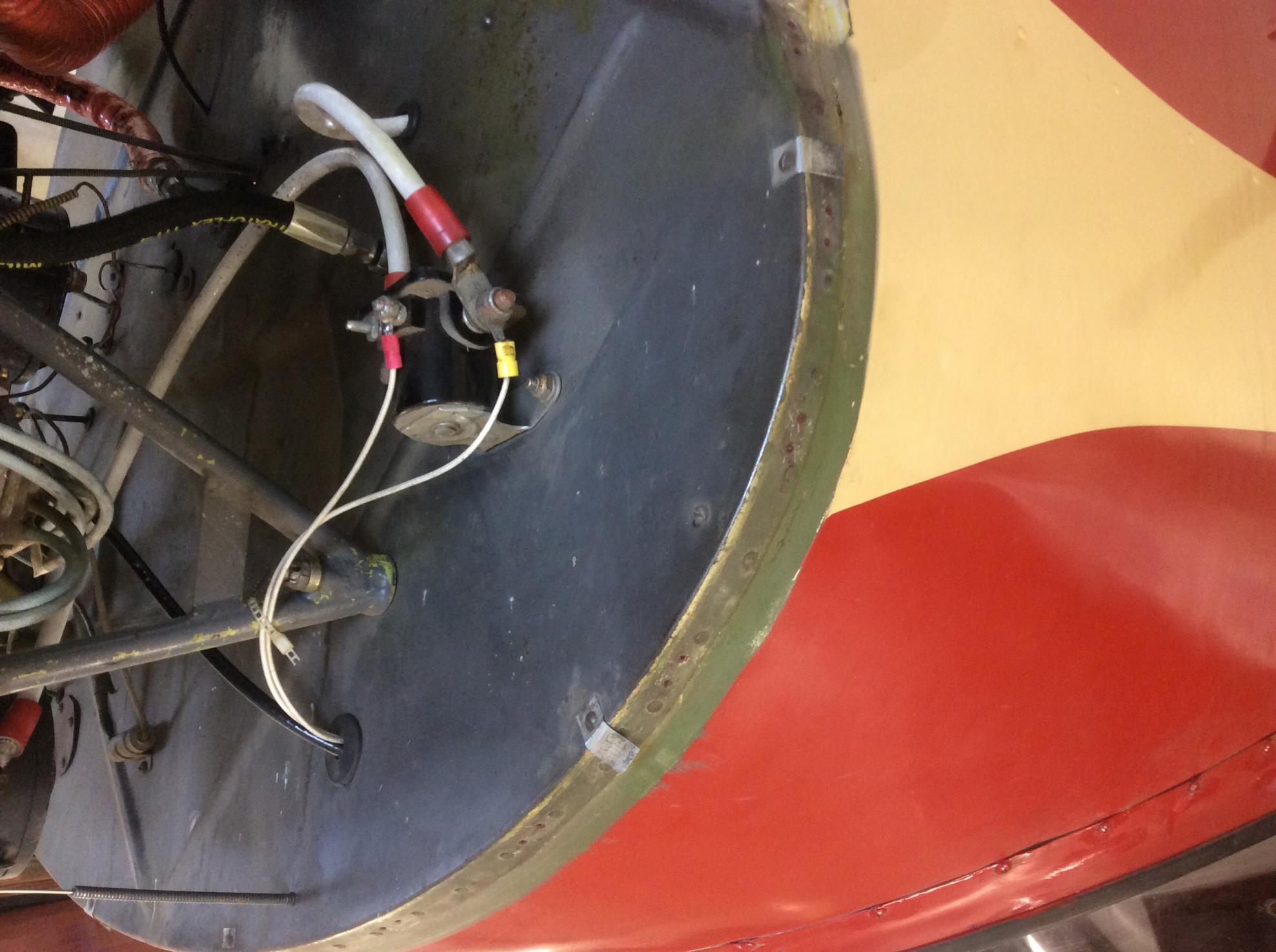

I'm replacing the cowl anti-chafe material. Anyone use something better than 1300L? Also, there were wire staples holding down the fabric. Should I replace those with safety wire of smallish pop rivers? Lastly, there are some spring clips in the location of the upper cowl doors (see picture). Are they necessary? Thanks for your advice.
