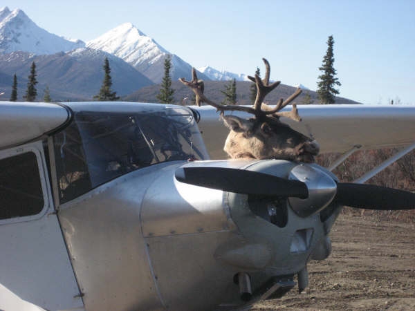

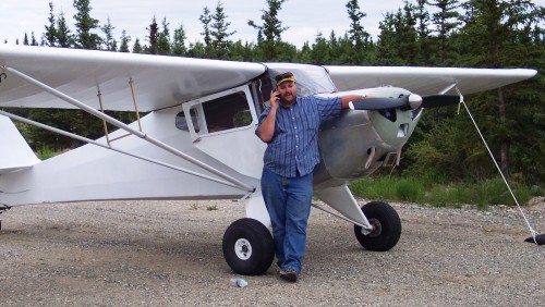

                          I have an ercoupe spinner installed, maybe someday I will do some paperwork. Tim
                            The pics look good Tim. Not at all ugly and very functional. Lots of room for balance weights if desired. The Caribou cowl ornament finishes off the Alaska look nicely...just aim between the antlers and you'll never get lost. They just know the way.
