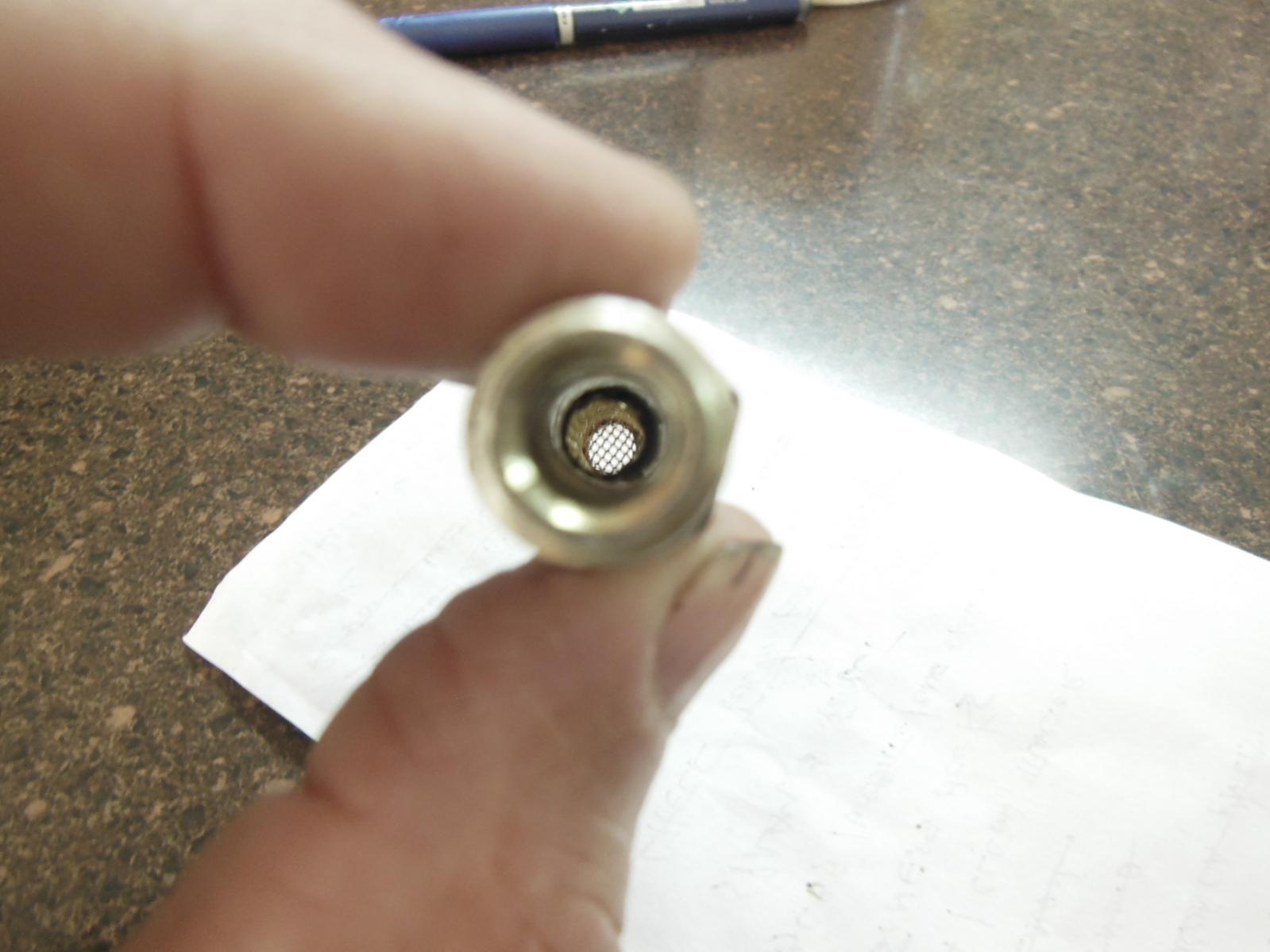

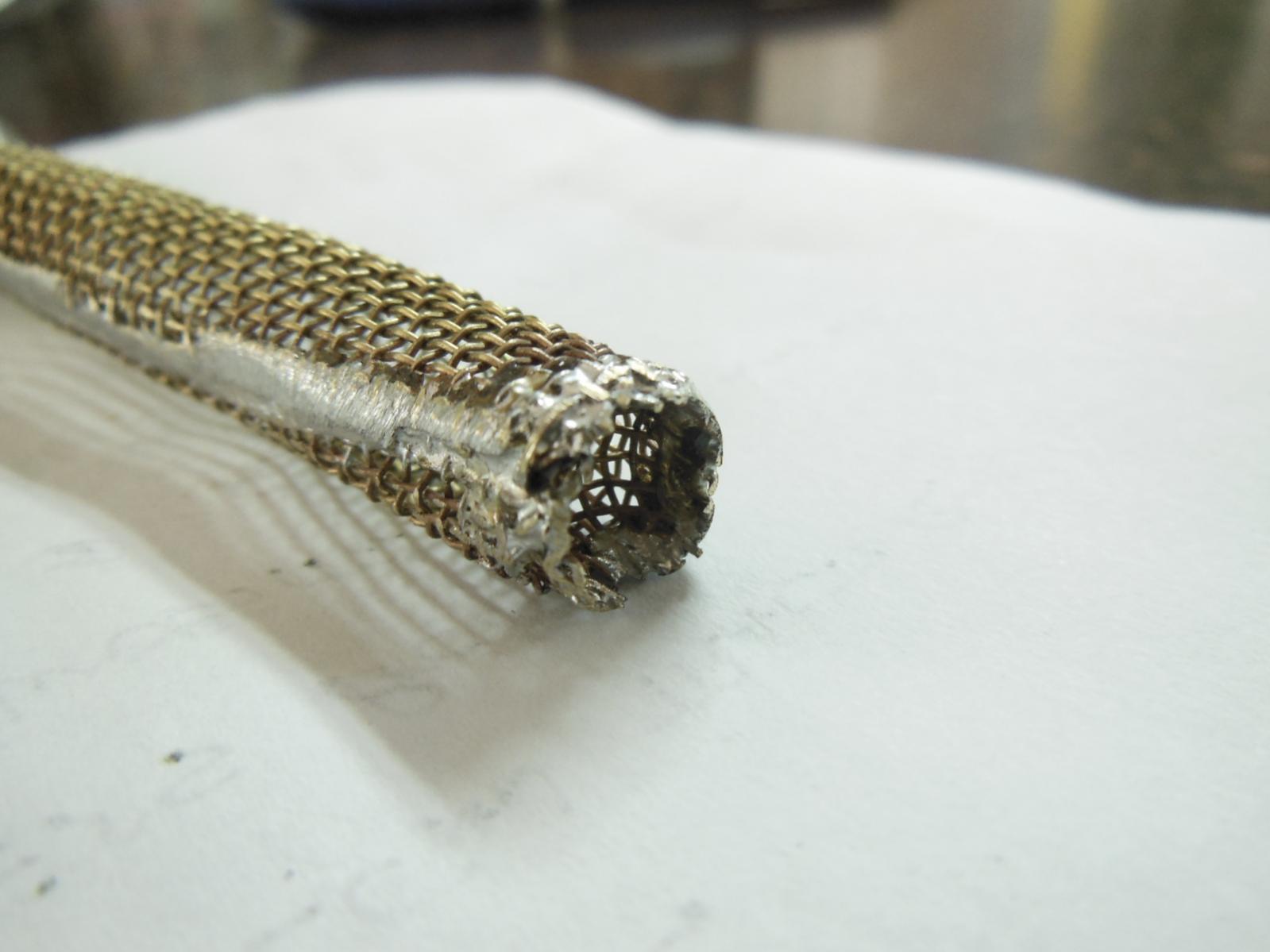

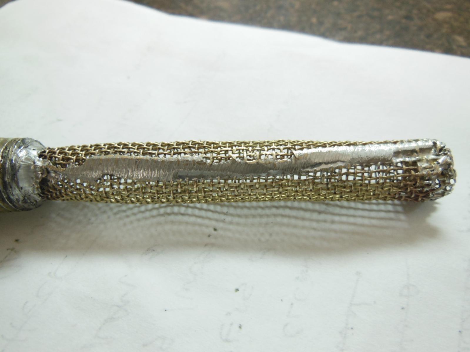

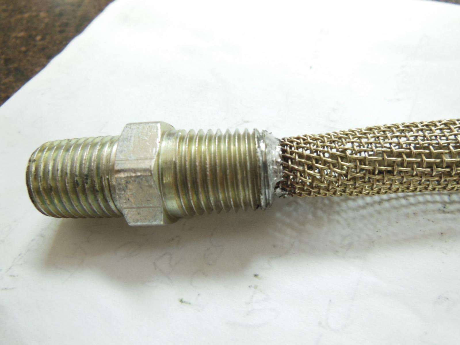

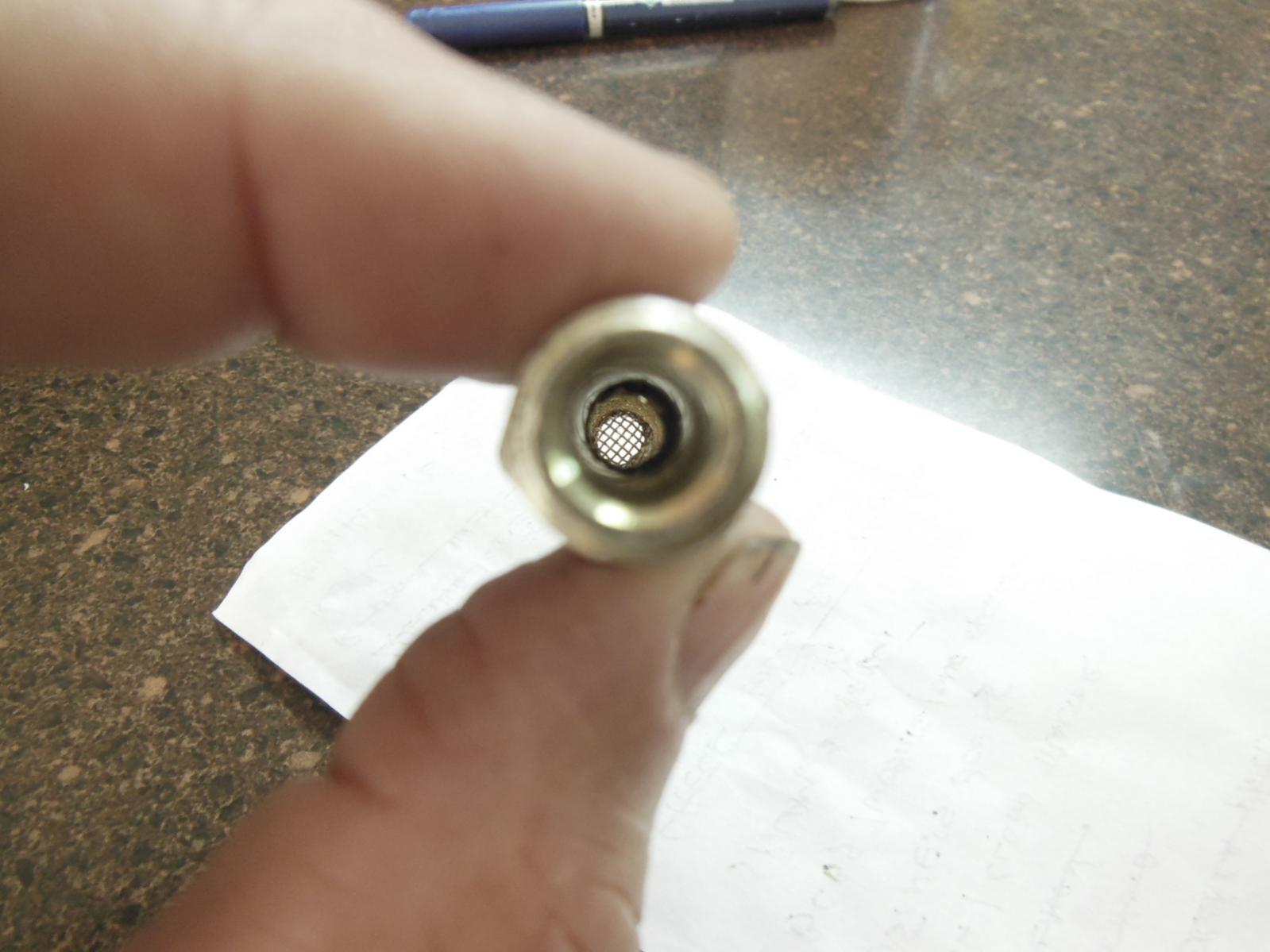

    Sadly this is not about a t-craft but my Aeronca. There are some clever and experienced folks here so I figured that I would ask.
    My Aeronca has 26 gallons of fuel in 2 wing tanks that are Aeronca tanks. The fuel outlets are 1/4" female pipe thread.
    There have been no finger strainers on these and I don't like that.
    So I looked for 1/4" male pipe thread finger strainers and found none so I fabricated one.
    Its made from a brass AN fitting with one end counter bored to a depth of about .100" and a brass screen rolled, formed, soldered.
    The ID of the fitting is not reduced due to the counter bore. It fits thru the 1/4" IPT fitting in the tank.
    The finger is 2-5/8" long, longer than the 3/8" ones that suppliers sell.
    Anyone know where I might purchase rather than make these?
    Anyone have a fuel flow spec to test them too? Its a C90 engine?
    Also looking for comments and advice regarding strainers.
    Thanks, Dave.

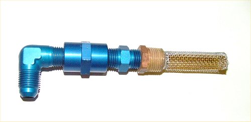

      Dave, I bought brass finger filters from a supplier here in the UK for my Taylorcraft (admittedly, this was over 10 years ago). See attached photo, but ignore the blue fittings.
      Edit: see this link

        Thanks Garry and Rob,
        The 3/8" and 1/2" ones seem to be readily available however 1/4" are not so easy to come by.
