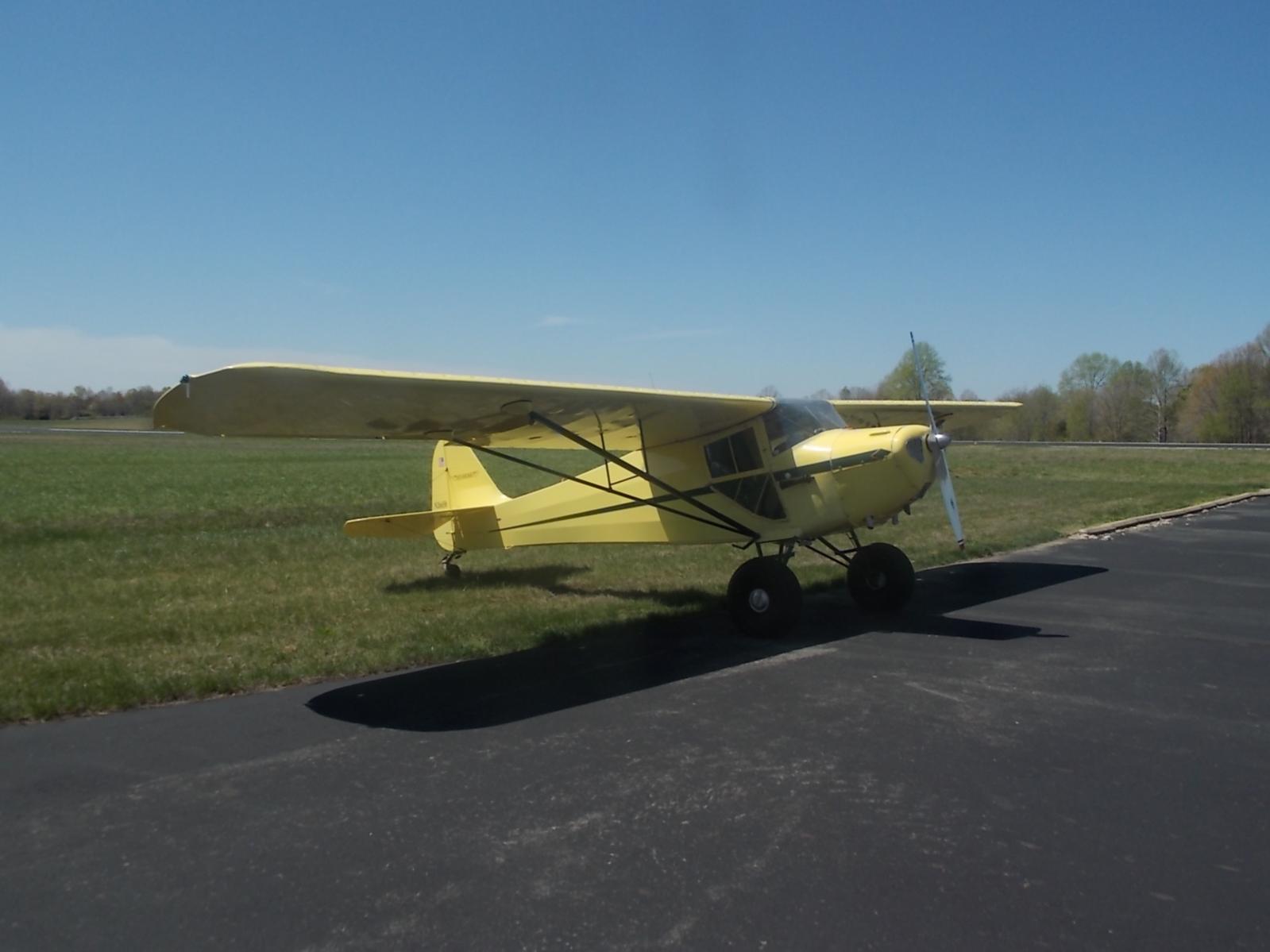

        Re: New to the Forum
        they are reasonable to maintain about 4 gl to the hr and yes,yes see photo 85 hp starter 26in bush wheels and disk brakes and a lot more.
        1940 BLT/BC65 N26658 SER#2000
