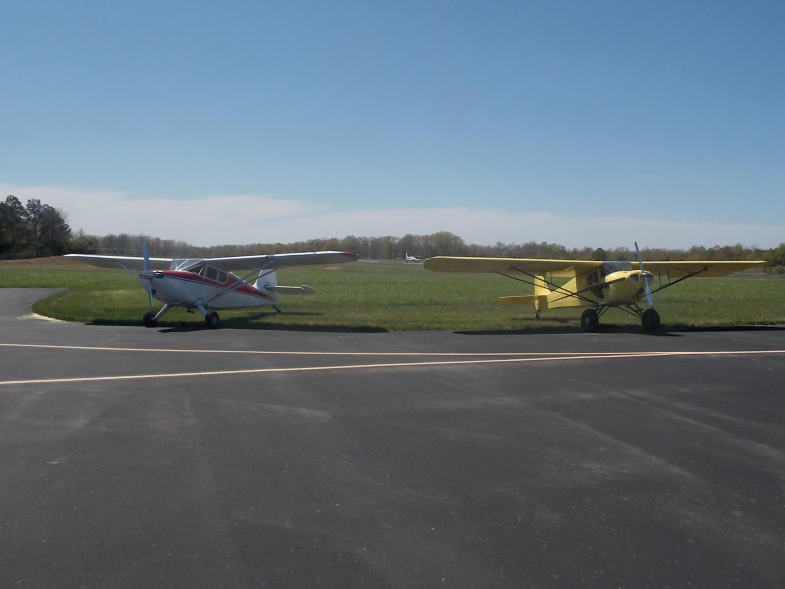

      We had most of the parts we needed before we took it apart so total down time was less then 3 weeks.Marty cessna has NO COOL FACTOR whats so ever Thats why i built the Stinson needed to spend some money also i gave the Taylorcraft to Shannon although she was able to prop it this is much safer for her when she goes some where
