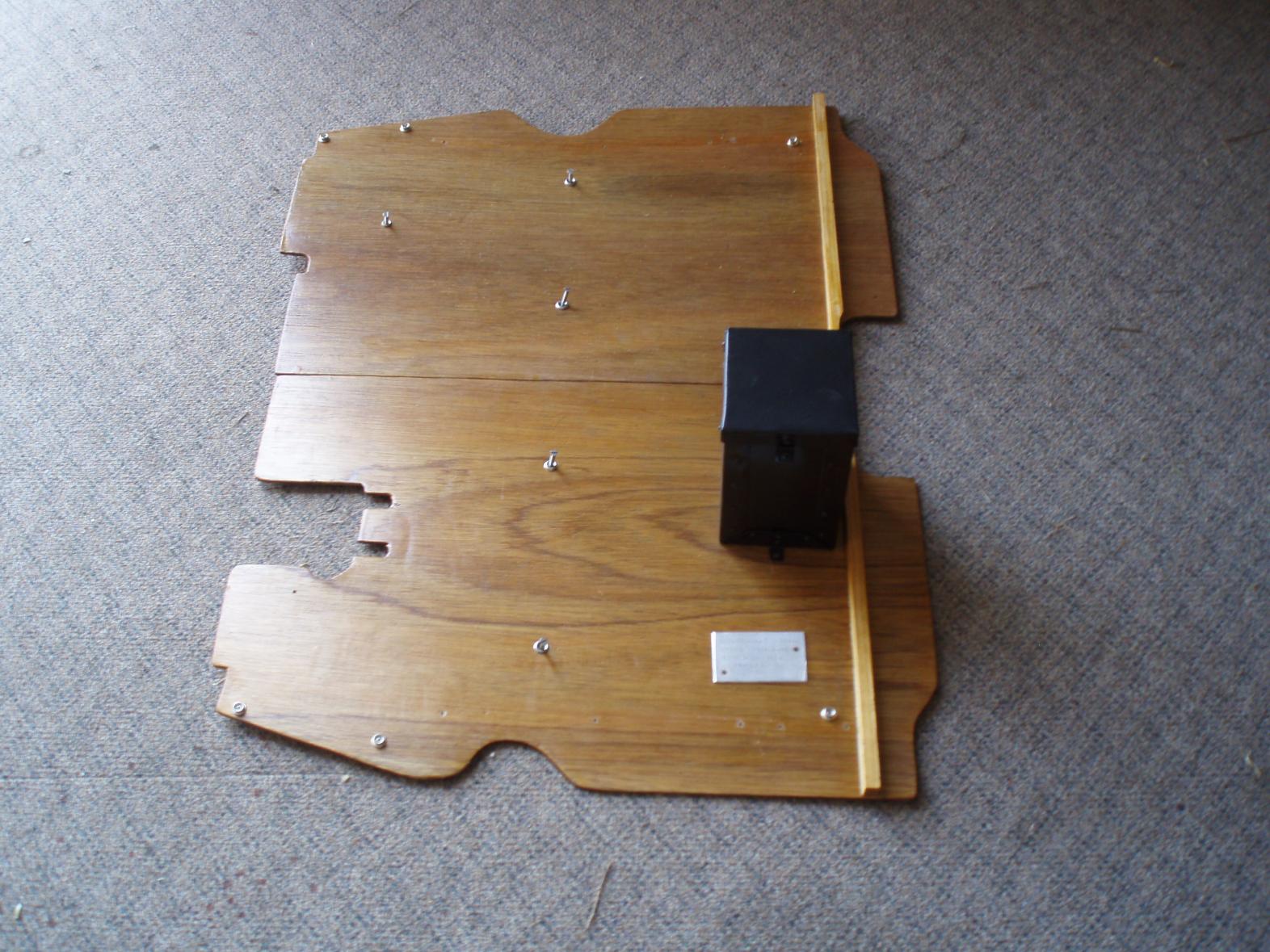

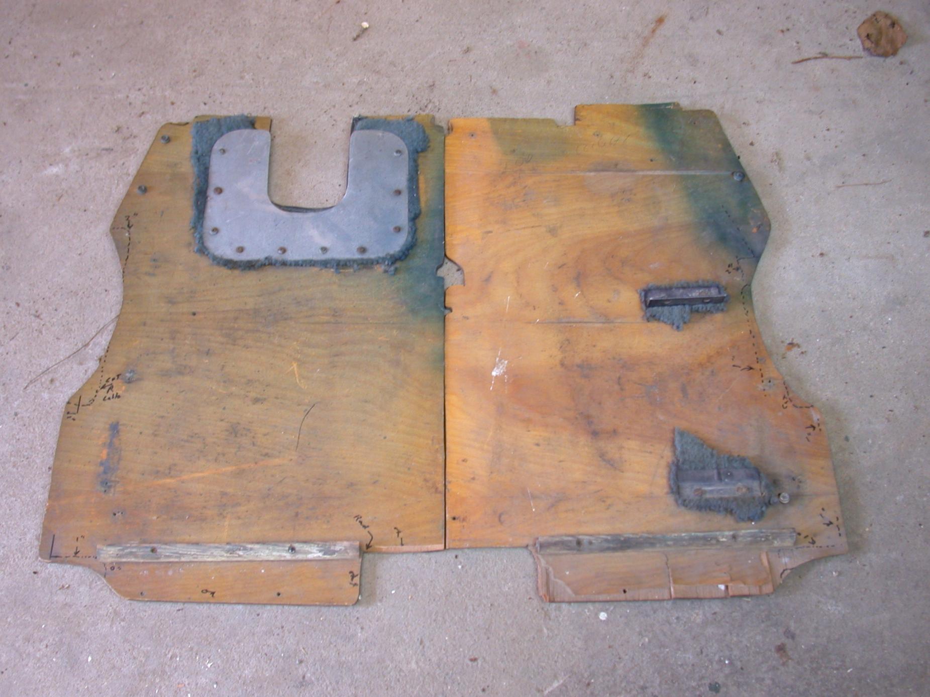

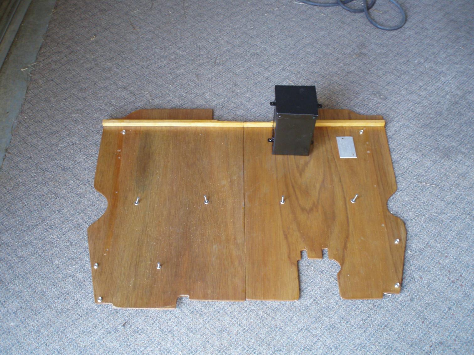

            Making new ones from wood is really worth the effort. Getting a used set (no matter how good or bad they are) is WELL worth the trouble! No two planes are exactly the same and when you get used ones they will either have GENEROUS gaps around tubes and controls (to allow for production tolerances) or will be made by a previous owner to close up the gaps, so that it won't fit your plane well.
            You WANT to make new ones so you can customize them to close up those gaps. It seem like anything you drop in the cockpit will immediately roll to the nearest open gap and end up in the boot cowl. When I pulled my boot cowl while the engine was off I found POUNDS of loose fasteners, washers, pencils, nails (NAILS?!?!!?) checkers (COME ON, who could play CHECKERS in a Taylorcraft?) and a lot of junk I couldn't even identify. I used my old (loose fitting" floorboards to make a TIGHT set that had about 1/16" gaps on non moving parts and as small as I felt safe with on everything else (like cables and controls). Do it right and nothing will chaff, but even a stumpy pencil won't get through. I even used Adel clamps around the tubes and custom fit plywood pieces in front of the rudder pedals. My floor are almost tight enough to hold water (OK, not THAT tight!).
            Take the old floors and tape cardboard pieces around all the gaps to be a template for your new floors. I also added a fore and aft Doug Fir strip under the center break so that the top side would come out easy followed by the lower piece. The plywood will have to have a curve in it to fit well and mine took the shape after a few months in a hot hangar. The new ones were lighter than the original ply ones but a little heavier than the metal ones.
            The one in the middle is the old set from the 45. I used them to make new 41 floors. The 41 ones were so bad they were useless. That black thing is a copy of the original battery box
