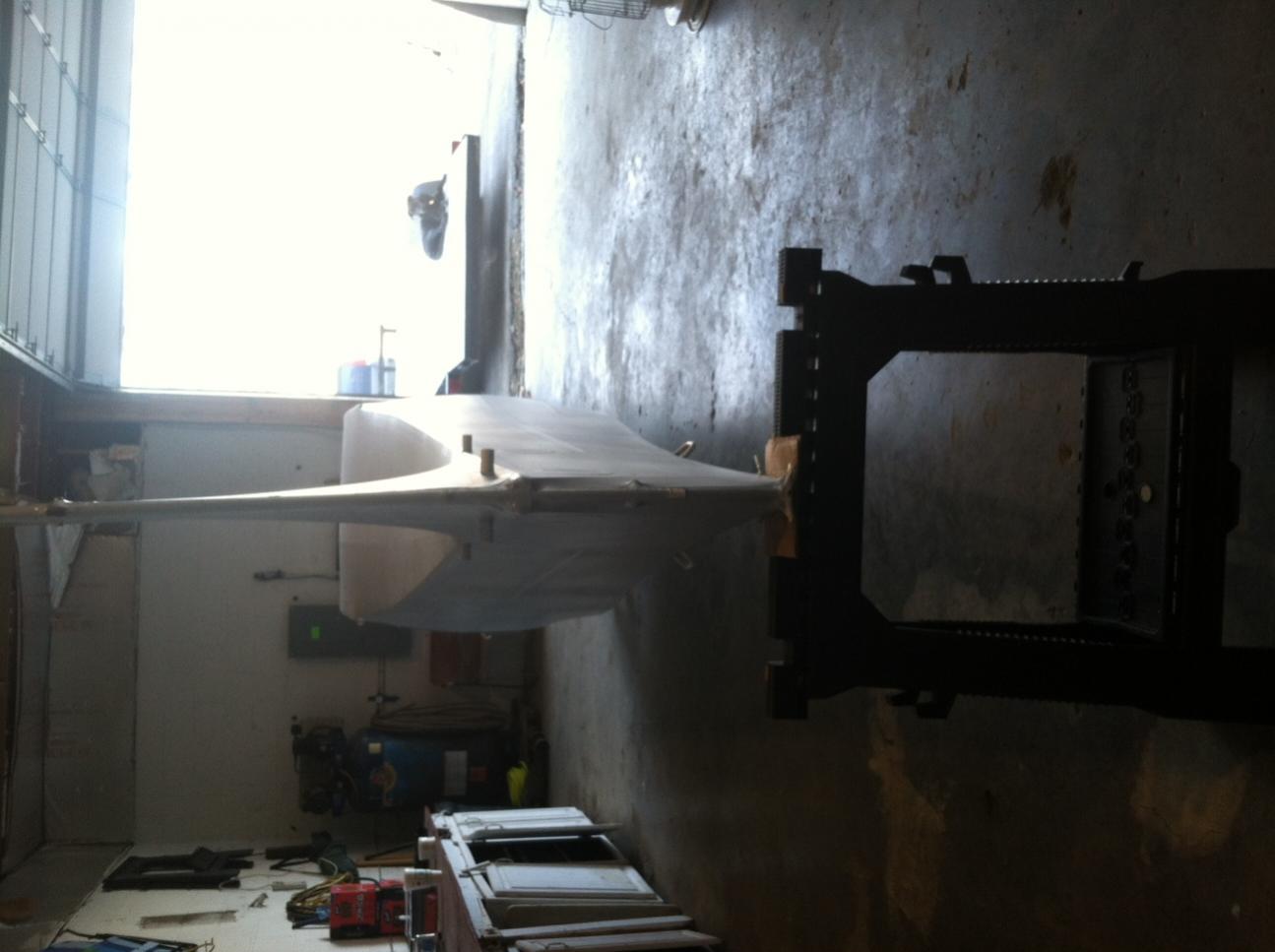

    Well ill start by saying its been far too long since much work has progressed on Crispy but we have been doing a little. Today I hauled it out of storage in the hangar and home to my garage where I will have a little more time to devote to it this winter, especially on cold days when I cant work at the airport(I have heat in my garage).

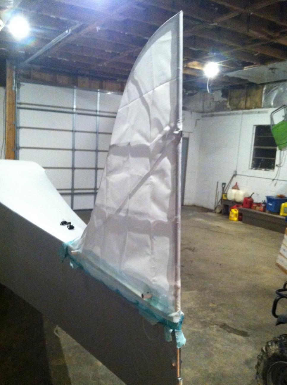

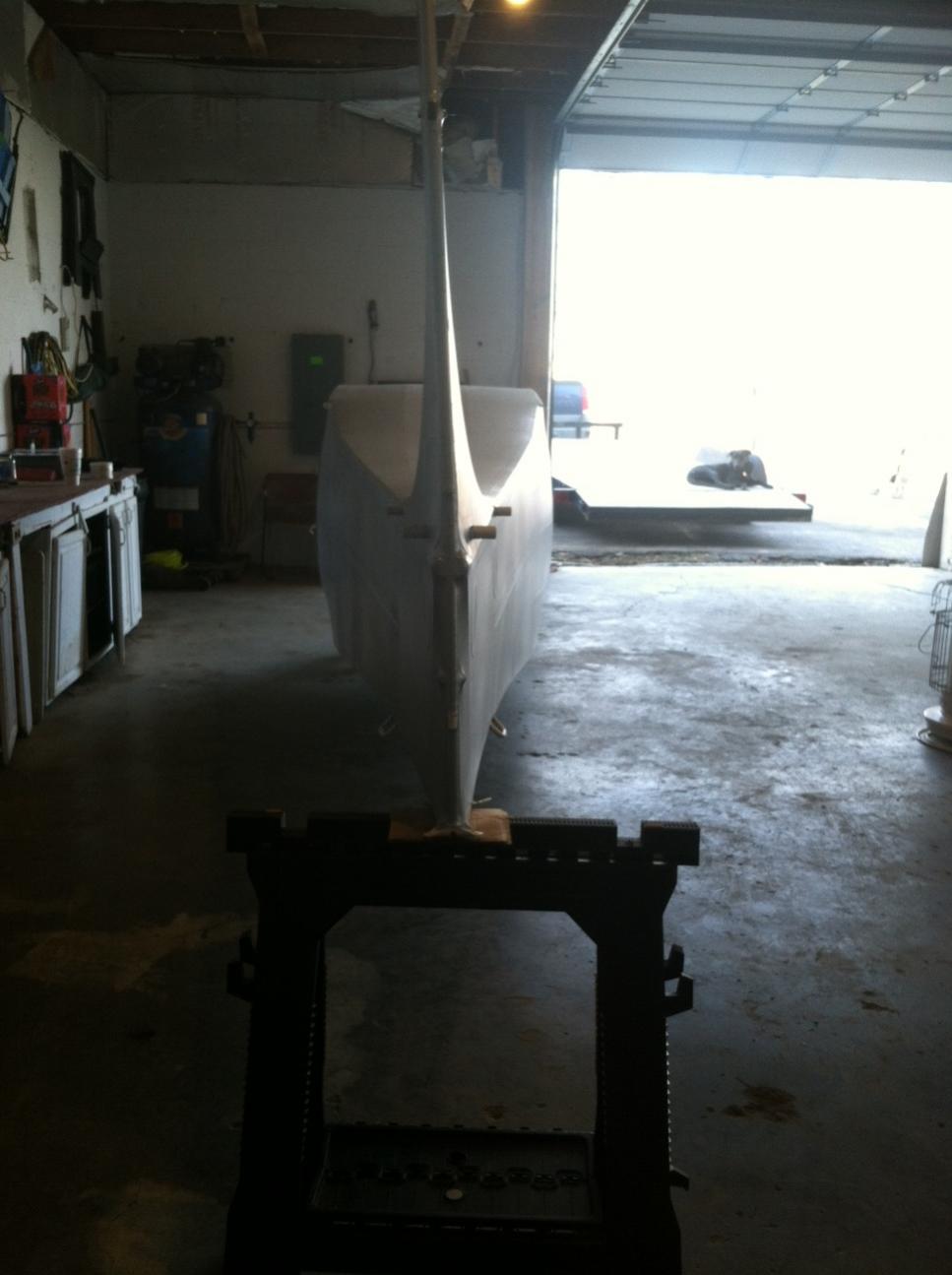

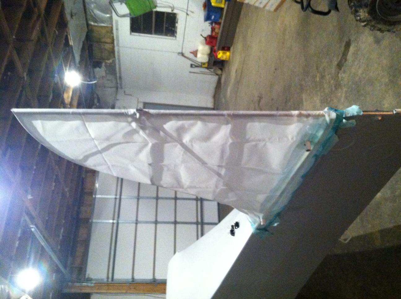

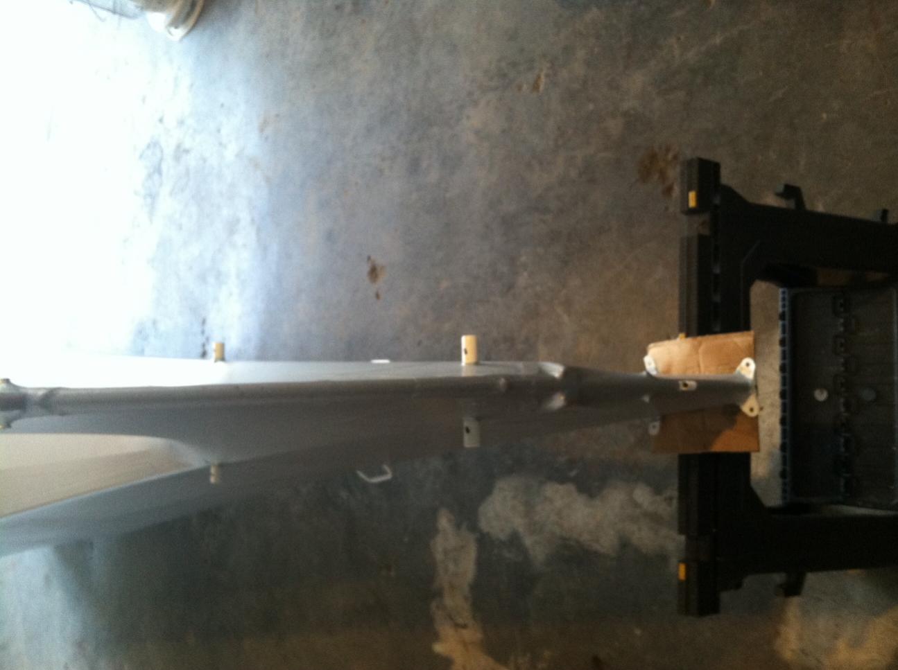

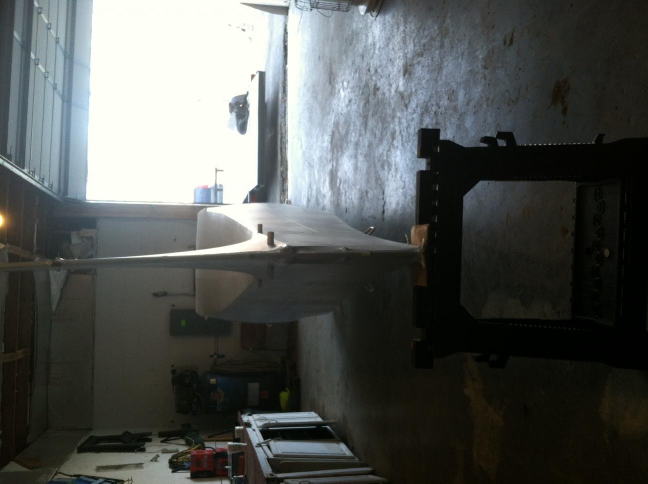

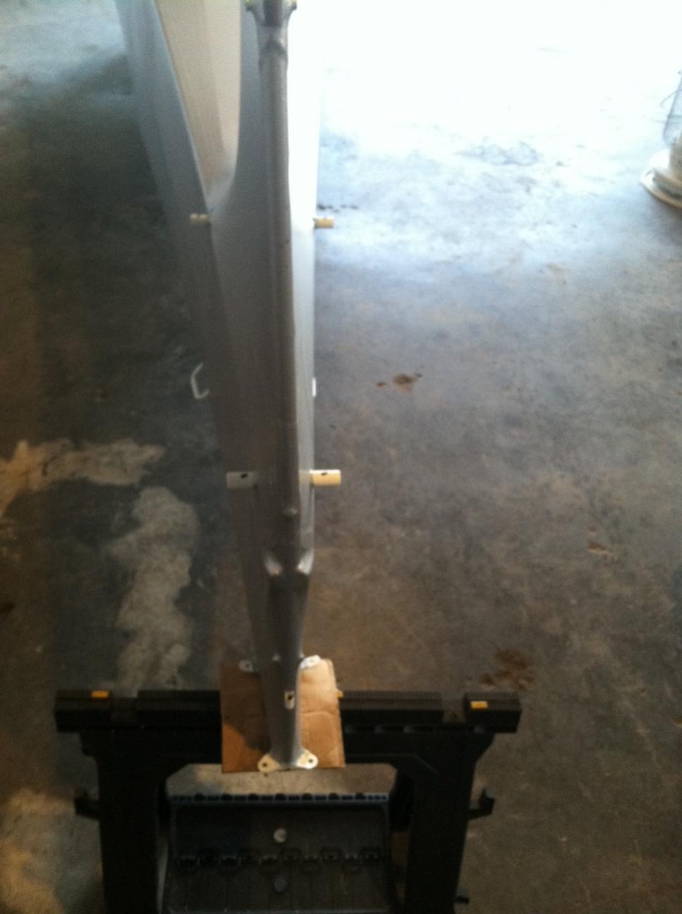

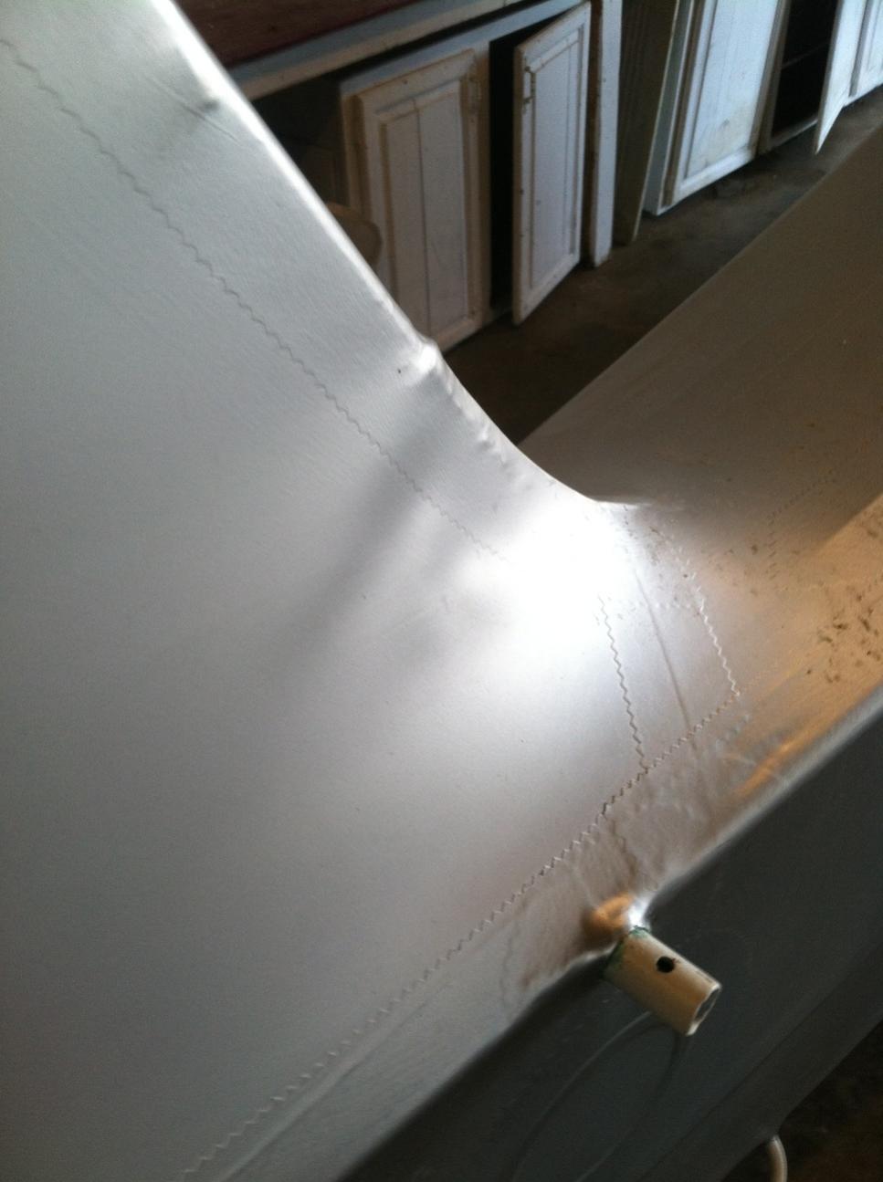

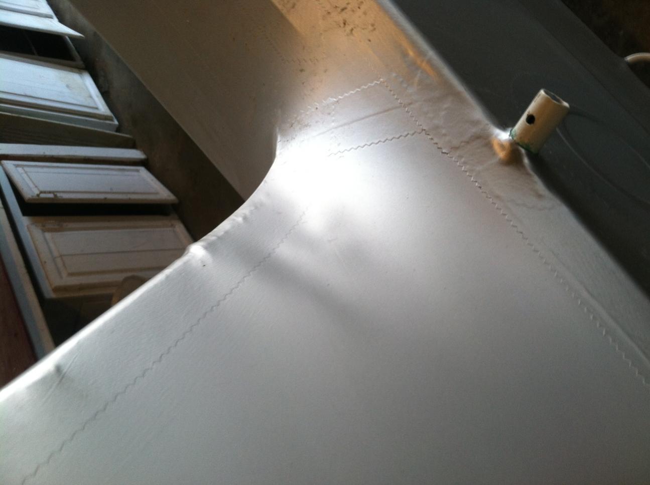

    As much as it pained me to do it, the first order of business after hauling it home today was to cut open a section of new fabric on the aft end of the fuselage. I had it covered all thru the second cross coat of silver and when I moved it out of the paint both I wasnt thinking when I parked it next to a window in dads hangar. The window always caught the morning sun and would shine directly onto the left side of the vertical stab from sunrise until almost noon....and guess what that did....yep, it tighten the fabric on the left side to the point where it wouldnt allow the vertical to straighten up. I tried shrinking the right side with no luck, in fact the left side is so tight now that if you do force it hard enough(and I mean hard) to straighten the vertical it causes wrinkles in the right side(see pics).
    So with all that explained, today I managed to move it to my garage, removed the fabric from the vertical, and get the left side glued back on. I will lighty shrink it in the morning and then glue on the right side sometime tomorrow. Hope to get everything covered & painted this winter and spring but making no promises.
    Sorry about the sideways pictures, I tried to delete them and repost but it wouldnt let me delete the first ones....oh well.lol

    Forgive the obvious question, but why would the sun further shrink the fabric on that side if it was heat-shrunk first?
    Lots of aircraft spend years parked on outdoor tie-down always in the same place; do they suffer the same fate?
      Re: Crispy Critter Update...
      Sometimes they do rob but usually not as bad after they have sufficient uv(silver) on them. Mine only had two thin cross coats on it and it shrank it about as tight as it would shrink.
        Either you didn't have it tight enough to start with or did you use taughtening dope on it? It can be tricky to make sure you pull the fabric up evenly on the vertical or you will have that problem.
          It's possible that it may have been a little tighter on one side to start with but unless you shrink it to the point just shy of the Dacron loosing its elasticity it will shrink in the heat if you don't have enough uv on it. I never shrink above 350 and Dacron will continue to shrink up to around 450 at which point it will actually start to go the other way(if it doesn't start to melt). If you have enough uv it will not shrink or at least not much once you've ironed it up to 300+. However if you don't have uv or enough uv it will continue to shrink.
            it will never get that hot in the sun. Black tops out around 200-220*. I have never heard of UV shrinking the fabric, although it will deteriorate it. What paint system did you use?
              I don't think it was stated as to what fabric (Ceconite or Polyfibre) was used nor what finishing process (dope or Poly-brush or Poly-spray}
              At any rate, even non tautening dope continues to shrink somewhat, though not as much as regular dope. Whether or not the Poly products continue to shrink some, I do not know, but I suspect they do and with heat from the sun this might hasten and enhance the shrinkage of the "paint" product.
              I covered my Stinson with Razorback in 1977-78 and the only way Razorback is tightened is with the tautening dope PROVIDED that no dope penetrates the weave of the fabric. Every coat on Razorback is sprayed in order to prevent penetrating the weave.
              So, in Kevin's situation, it is probably the paint material on the fabric that caused the shrinkage, not the fabric itself. Two coats of aluminum pigmented "paint" should have been sufficient to protect the dacron from UV damage, but maybe not.
              It is normally considered not good to stop with the aluminum coat and wait months or year before applying the final coats because it invites poor bonding of the final coats to the aluminum impregnated material. I suppose it might help to spray a coat of rejuvenator on the aluminum coat before proceeding if it has been more than a week or two since the application of the aluminum.
