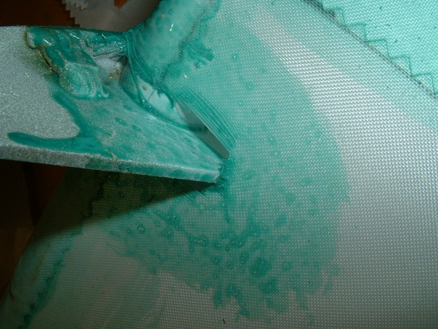

    Can someone suggest how to gracefully cover around the rudder horn? here is a picture of what I have so far - Mike

    When you come to a spot like that I like to just make a single slice with the pinking shears, the fabric will then be tight against the (in this case) horn.
    Don't over shrink it till you get the dollie's-doyle's on, they cover a lot of little imperfections

      Hey Mike.
      I think you did OK there. It is not an easy thing to work a large piece of fabric arroud a horn of hindge.

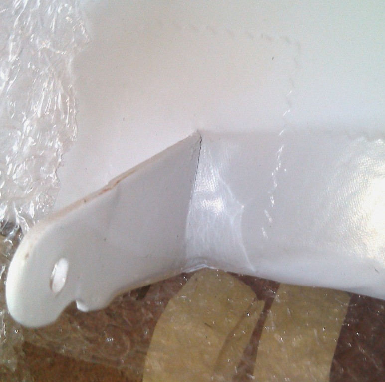

      Fabric is my day job and I do exactly what you have done there, but after I put all the rib and perimeter tapes on (witch will cover a large section of that area anyway) I cut a piece of fabric about 2" by 3" that has v\been pre doped to stop it fraying when cut and simply dope it over the affected area.
      Works great and looks good aswell.
      I do this technique over any things "sticking out" of the fabric eg. horns, hindges lift strut tangs.

        Re: fabric around the rudder horn?
        A little more description would be helpful, please. -mike

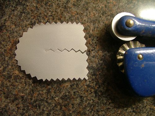

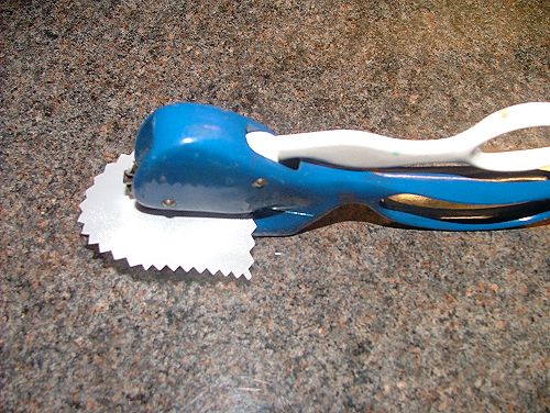

            I know exactly what Senior means, because I've done the same myself.
            Mike: when you come to do a finishing tape over that area, instead of cutting a piece out of the tape, make a single cut. If you are using a rotary "florian" pinking shear, you have to back up the rotating cutter with your fingers to release it from the end of the cut.
            The pinked edges of the cut will form around the horn and you should be able to seal them against the flat surfaces of the horn with a warm iron.
            The images below gives the kind of idea. Hope that helps,
                I use the same technique except for cutting the part that goes onto the horn with a straight sissors.
