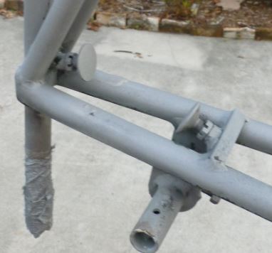

This is what is left of the up stop did not eaten know it was missing. Painted over when I got the airplane. The front stop is there just hard to get at. Just a nub left. Was thinking of welding a disc to a bolt and grinding to profile.Attached FilesLast edited by adrozell; 09-12-2014, 06:40.Andrew Rozell
N43697
1946 BC12-D

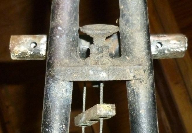

Here is a picture of my '46 BC12D elevator stops.
I didn't measure them. And the fuselage is covered now.Attached FilesTim Hicks

The previous picture is right after sandblasting. This picture is before sandblastingAttached FilesTim Hicks
N96872
Re: elevator stop?
Looks like 3/8ths. Probably been broke from when it was over on its back back in the 50s. Lots of paint on it. Thanks for the pic helps to see with out the fabric on. Real tight to get to with it on.Last edited by adrozell; 09-12-2014, 09:28.Andrew Rozell
