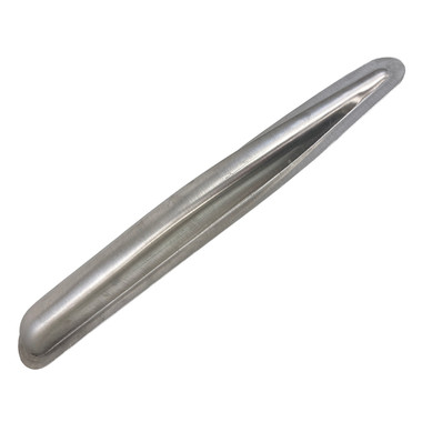

          You can get the Ercoupe bumps from univair, they are metal and the right size. Tim

            For what it's worth, when my plastic cowl bumps were breaking up, I bought a pair of the long, shallow aluminum Ercoupe bumps from Univair.
            I liked the idea of aluminum.
            But they weren't deep enough.
            Even though I really wanted them to work, I couldn't find any way.
            So I returned them to Univair and bought fiberglass bumps from somebody on this Forum (I can't remember from whom).
            The fiberglass ones fit fine in all dimensions.

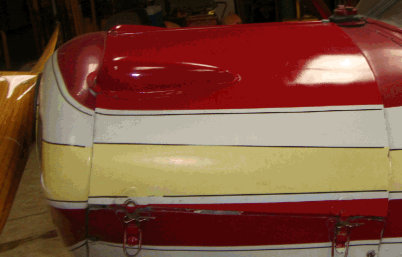

              Hank.
              Attached pictures are the new cowl that I'll be using and the old one that I don't need.
              Norm
