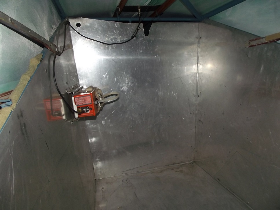

    That being said she has this nicely fitted extended baggage compartment in the arse end...aluminum all the way around, even across the front. Still has the sling too. I have a feeling that it is going to be exiting the airframe for the time being. Any guesses on what it might weigh? :-) Handy for sleeping bags but I would prefer a happier CG. Even then I might end up rebuilding the Scott tw. We shall see how the magic numbers look tomorrow.

      Just an educated guess but I think the difference between the former metal prop and the current wood one, and that baggage compartment aft are obviously making a difference. Going to weigh with it in and then remove and weigh again since she'll be on the scales anyway. Move the elt as far forward as possible too. Vac the dust out of the tail...every ounce counts right?

          Just finished removing 18.7 pounds of .032" 2024 from my fuselage and moved the elt forward to behind the seat. "Unofficial" scale weight at the tail now just under 62 pounds. I'm in a MUCH better mood now. Fairly confident my CG will be in the happy place this evening, and I've got more available load for fuel.

                          My extended baggage ran aft from the back of the seat 38" to the next diagonal brace, but I won't be re-installing it unless I return to a metal prop, or maybe will wait until I do a planned C-85 conversion. It looked nice but the more I think about dragging around empty almost 20 lbs of unneeded dead weight aft of my CG, the happier I am about removing it. Would rather have fuel.
                          So my baggage area now consists of the usual 50 lb. placarded fabric sling and two dowels behind the seat.
