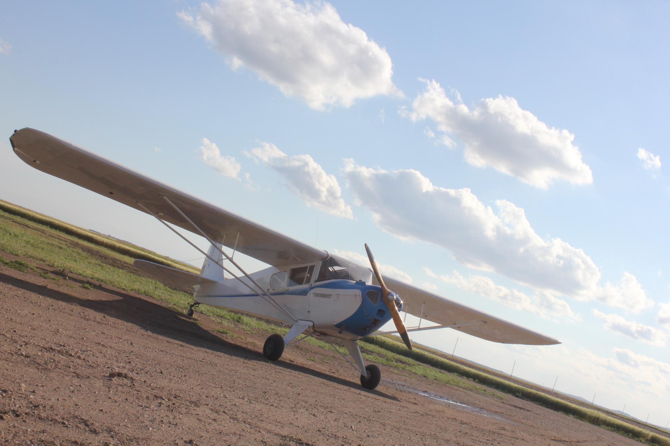

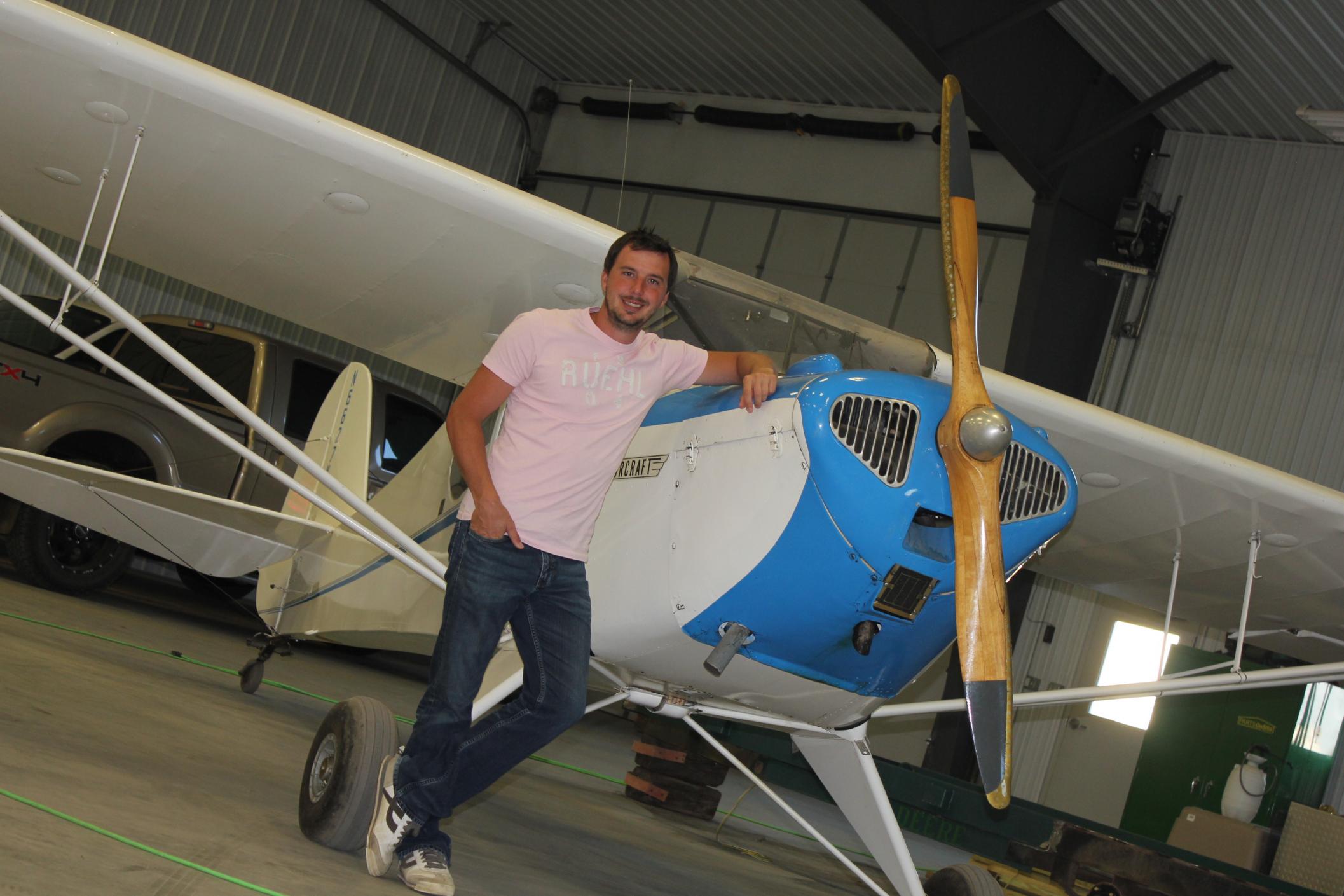

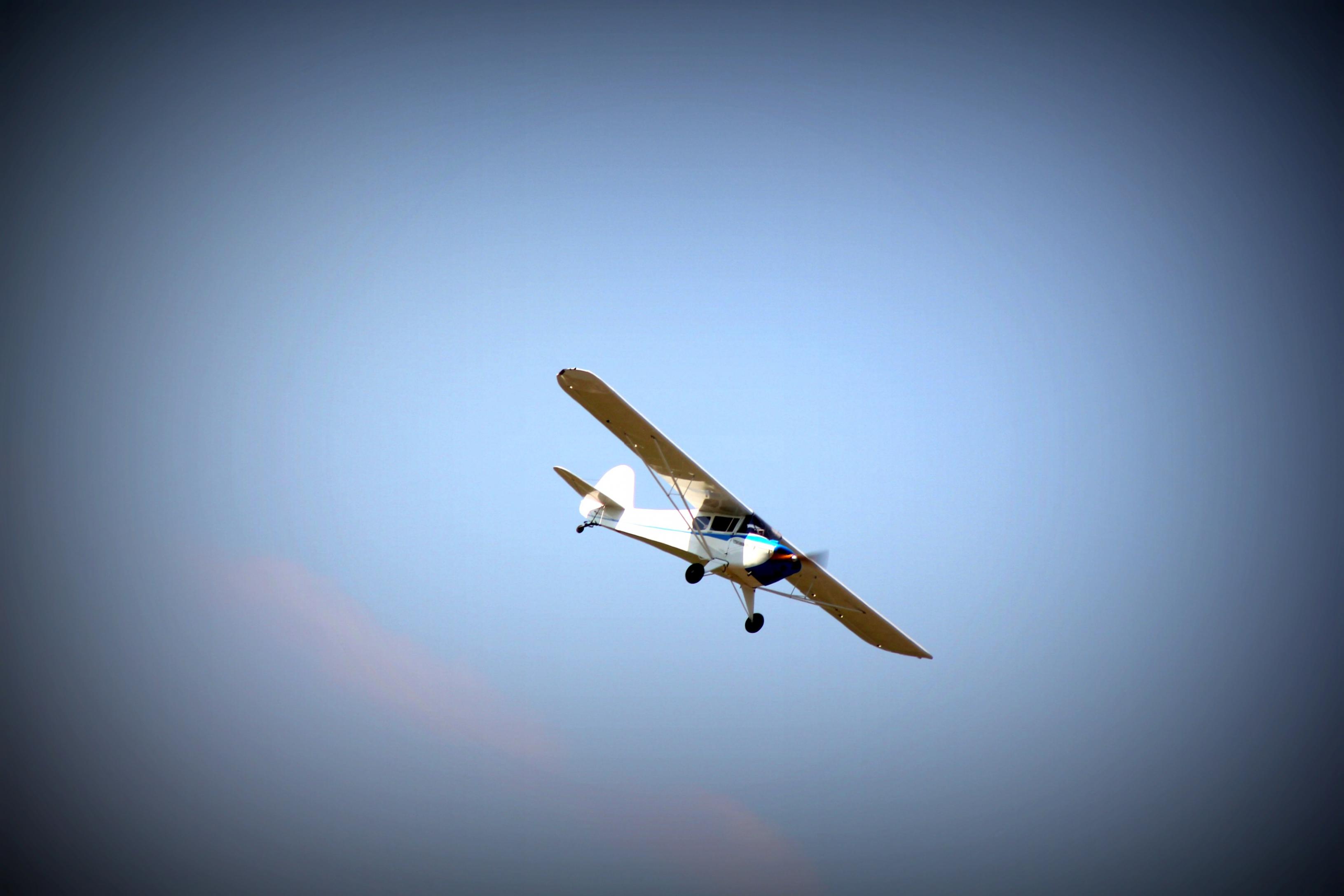

              Thanks all for the warm welcome! Attached are a couple of pictures from middle of last year of my family and I enjoying our recent purchase! Especially that little guy, can't keep him out of it! I should probably be careful using the term "full restoration". I planned on flying her while I did a few updates here and there. I purchased at a fair price and thought she would pass an annual with no problem. I'll start threads with pictures in their appropriate categories in the future but in short the biggest two problems I ran into that made the mechanics a little nervous are the ribs on the outside of both left and right ailerons seem to have some 'warping' and are rubbing against the ailerons. One so bad it has a piece sticking out that would catch if the aileron was deflected too far up or down. With the inspection holes opened they noticed some 'repairing' that had been made around those ribs and thought rather than repair and patch, now might be the time cut off the fabric and make sure I know what I have under that fabric for sure. I've got the wings popped off now but have not taken any further action. The other problem we ran in to was the wheel halves are completely shot and from what I understand If I switch to a different wheel (one that they still make) I then have to change out the brakes. Other than that and a carb overhaul I'm ready to go! Assuming everything under that fabric on those wings is up to par!? Thanks again to everybody here for making this newbie feel welcome. The willingness of everyone on this site to help one another and build relationships with fellow aviation enthusiasts is what makes this forum so valuable!

                    Beautiful plane. Beautiful family too.
                    Welcome to the Taylorcraft Tribe. Lots of help here so ask all the questions you can.
                    Meanwhile, keep that nice wooden propeller in the horizontal position when you put the plane away! There is a chance that sap will drain into one blade and make it go out of balance.

                            These guys are not kidding when they say look for and old A&P to work on her. Some very fine younger A&P's have never even SEEN an NAS3 carb, and would only mess it up if they tried to rebuild it. Nice looking plane, it's paint looks nicer than mine.
