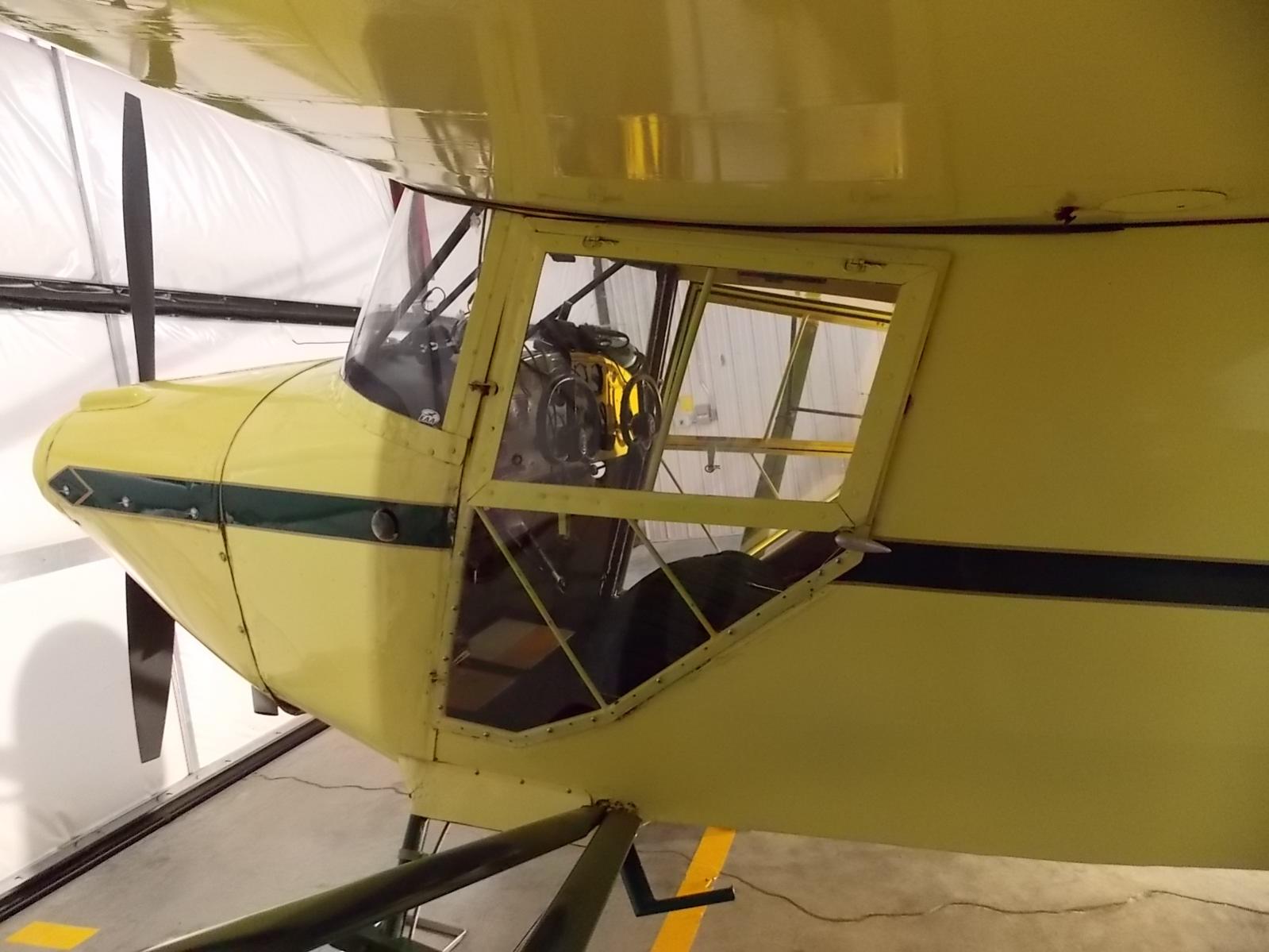

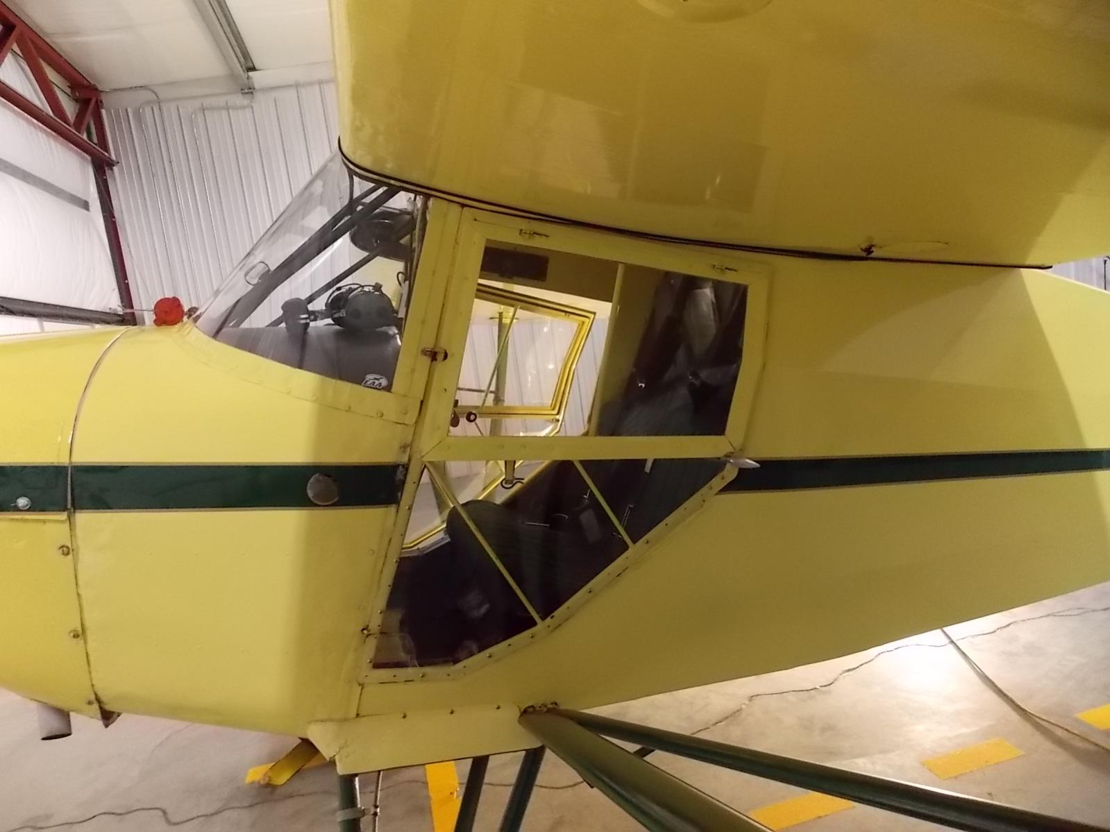

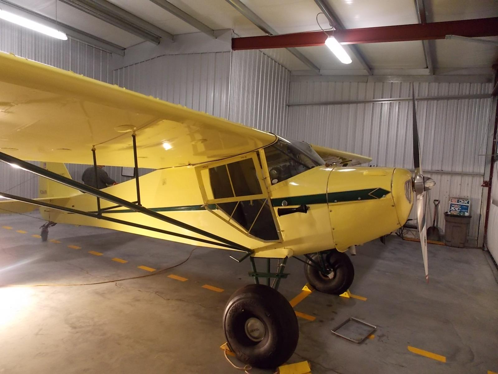

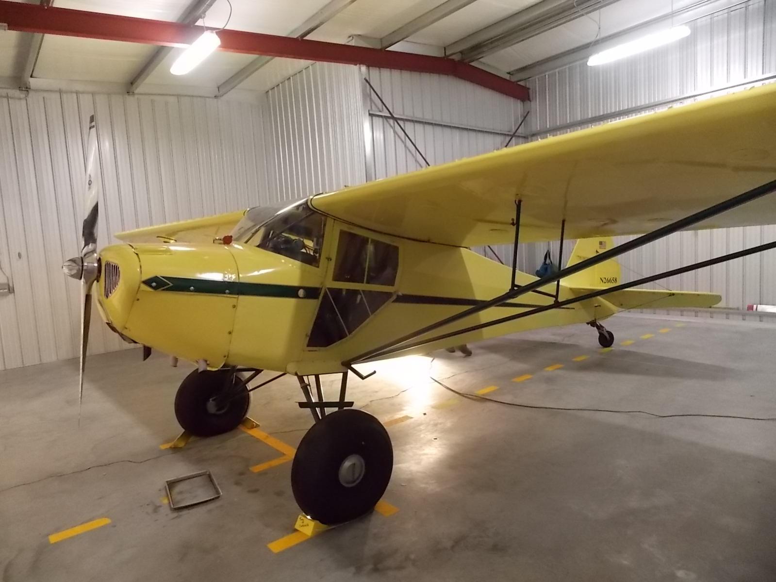

Here are some photos of my latest mod to my plane
patroll doors
Re: patroll doors

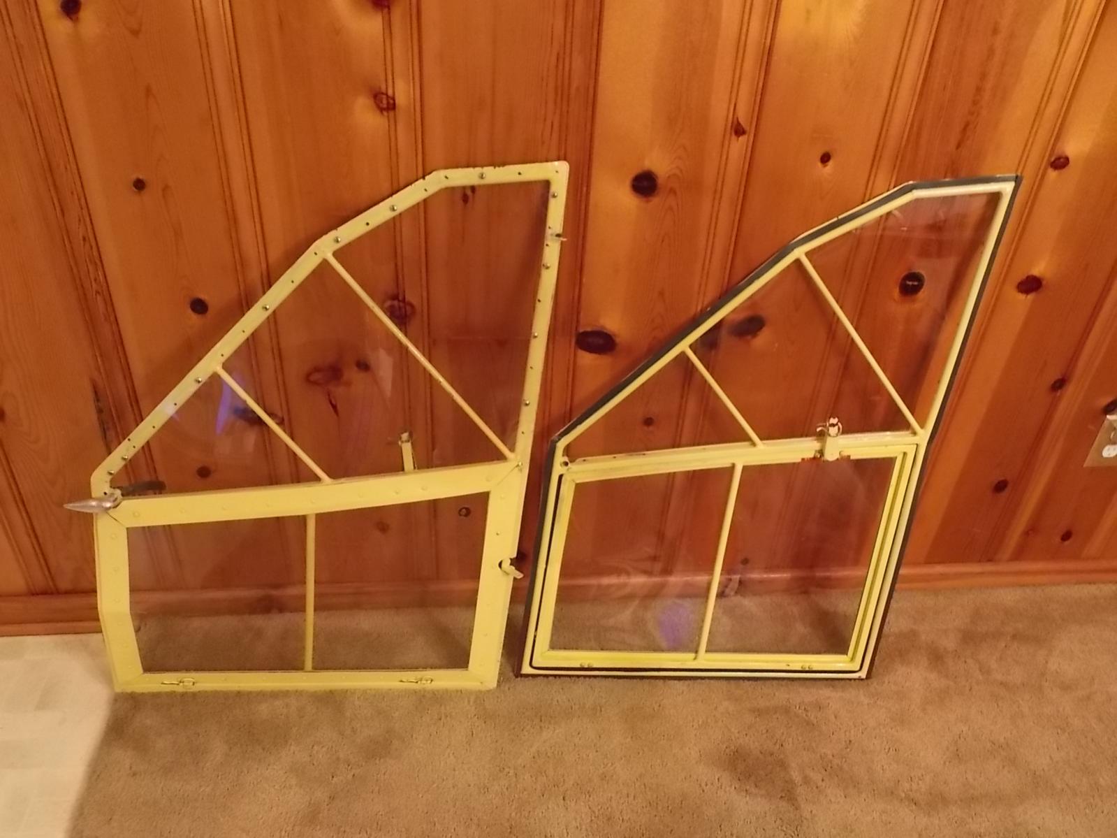

Hey Chuck.... Great addition. I'm looking for a set of fabric doors to covert them to patrol. Can you post some pictures from the inside, on how you attached the plexi to the door frames. thanks

The tub doors or fabric are made with a flat front my doors had aluminum on them with pop rivets so all i did was drill out the pop rivets and replace them with number 10/ 1/2 in PK screws and screwed the plastic on. Also clear silicone between the door and plastic to seal the gap.and the pictures don't lie. also the view out is much improved to the side and front just siting in the seat. THANKS MARTY YOUR COMMENT WAS GOOD FOR A LAUGH Have a great Christmas my friend Chuck.Attached Files1940 BLT/BC65 N26658 SER#2000

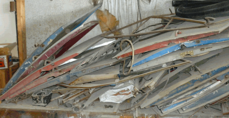

Somebody just posted they had a bunch of doors within the last week, I think. I will look.

I think I would have used acrylic plexiglass. Lexan scratches easily, crazes after a few years, and is not chemical resistant (gets foggy if gas gets on it). The good news is it won't crack.Last edited by M Towsley; 12-14-2013, 18:12.Cheers,

To be honest I don't know what the plastic is my stepson works in a place that recycle eletronicks and this is the cover sheet off the screen of big screen TV's 1/8 in thick and free 60 in wide and about 40 in have a sheet that is tinted a light smoke color to do sky light in the future1940 BLT/BC65 N26658 SER#2000

Thanks, Tim. I looked everywhere and could not find your picture or where you posted it.

The top door in the picture is like Chuck's and mine (it's match looks like it is in the pile a little lower). The nice thing about tube doors is they are easy to fix if you can do a little (even low quality) welding. The bad news is they are slightly different shape than the sheet metal doors and may not fit your plane. You might want to ask if he will hold them for you till he gets a butcher paper tracing of your door to see if it will fit your plane.
