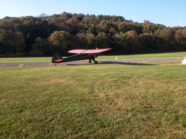

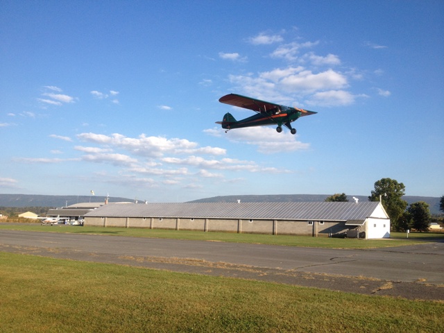

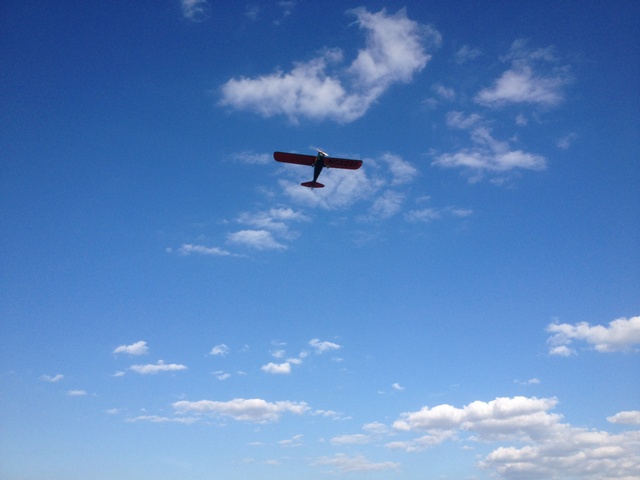

    NC22211 flew on Wednesday, 2 October for the first time in 55 years. Three flights, 1.5 hours, Andrew King and I took turns checking her out. Hands off flyer, spirited old gal, at that.
    DAR Gene Breiner, IA Andrew King, V-DER Terry Bowden
    Restoration assistance: Eldon Bowman, co-owner Evan Bender, Jim Forkovitch and Members of this Forum.
    Took 3 years to revive this orphaned "barn find". Took 6 months to sort out the mountain of FAA paperwork, not because this was a troubled restoration, but because of a troubled FAA.
    We're off to EAA Chapter 3's Fall Fly-In today. Thanks to all who assisted! Bob Coolbaugh
