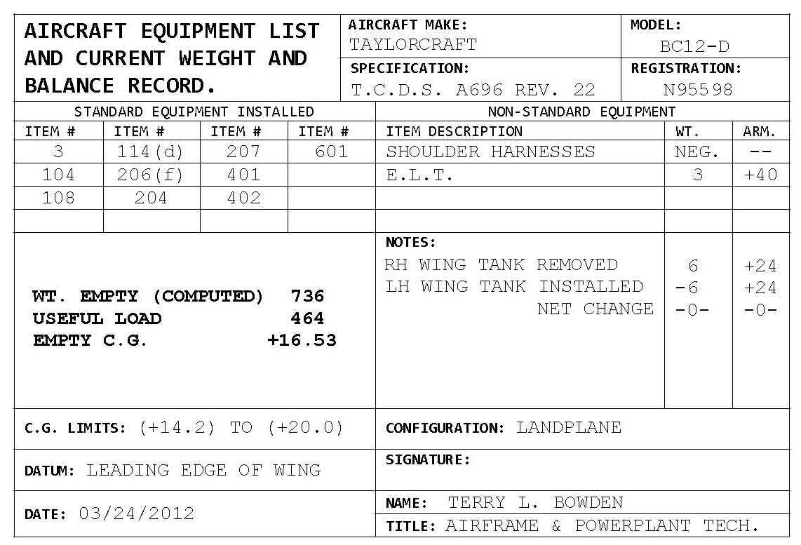

          You told me that your airplane has a "Taylor-Young" data plate. Show your inspector, the max wt. is shown right on the data plate.
          Also.... See T.C.D.S. # 700, Note 1. It States:
          NOTE 1. Current weight and balance report including list of equipment included in certificated weight
          empty, and loading instructions when necessary, must be in each aircraft at the time of original
          certification and at all times thereafter (except in the case of air carrier operators having an
          approved weight control system).
          Also note: My BC12D has a CAA Form ACA-309 (see photo), which resides in the same pouch as the registration on display in the cockpit. When I removed the RH wing tank, I made a new card (similar to ACA-309) and This is attached on top of the original ACA-309 form, on display in the cockpit. THIS IS THE SIMPLEST WAY I HAVE FOUND TO MEET THE REQUIREMENT. Look in your Airworthiness records. Your airplane should have had the ACA-309 form issued in its early years.
          Then note that under CAR 4a, a placard is required for the baggage compartment (30 lb. per TCDS A700) as follows:
          § 4a.512 Baggage compartments. Each baggage and mail compartment shall bear a placard stating the maximum allowable weight of contents, as determined by the structural strength of the compartment (§ 4a.194) and by flight test (§ 4a.725). Suitable means shall be provided to prevent the contents of mail and baggage compartments from shifting.
          There are no further requirements.

                And to add to Terry's explanation, my ACA-309 was yellow and brittle. I was advised by the FAA a copy of this in the airplane was sufficient if the original was too fragile to carry. I made a color copy as well as a copy of the e-mail from the FAA in case someone had issue with it.
                  Re: Weight and balance or gross weight warning placard
                  Hi Marty,
                  Perhaps more important than the 309's brittleness is its relevence to the airplane today.
                  What I mean is that mine is so far out dated due to changes and the fact that the airplane has now been weighed so the weights are no longer "calculated" that I just made a new equipment list.
                  I suspect that many others will also fall into this same circumstance.
                  Also I realize now that this thread has a fork with 2 prongs; 1) what the FAA requires in the airplane 2) what the pilot wants to create to make W & B convenient at/befor each flight.
