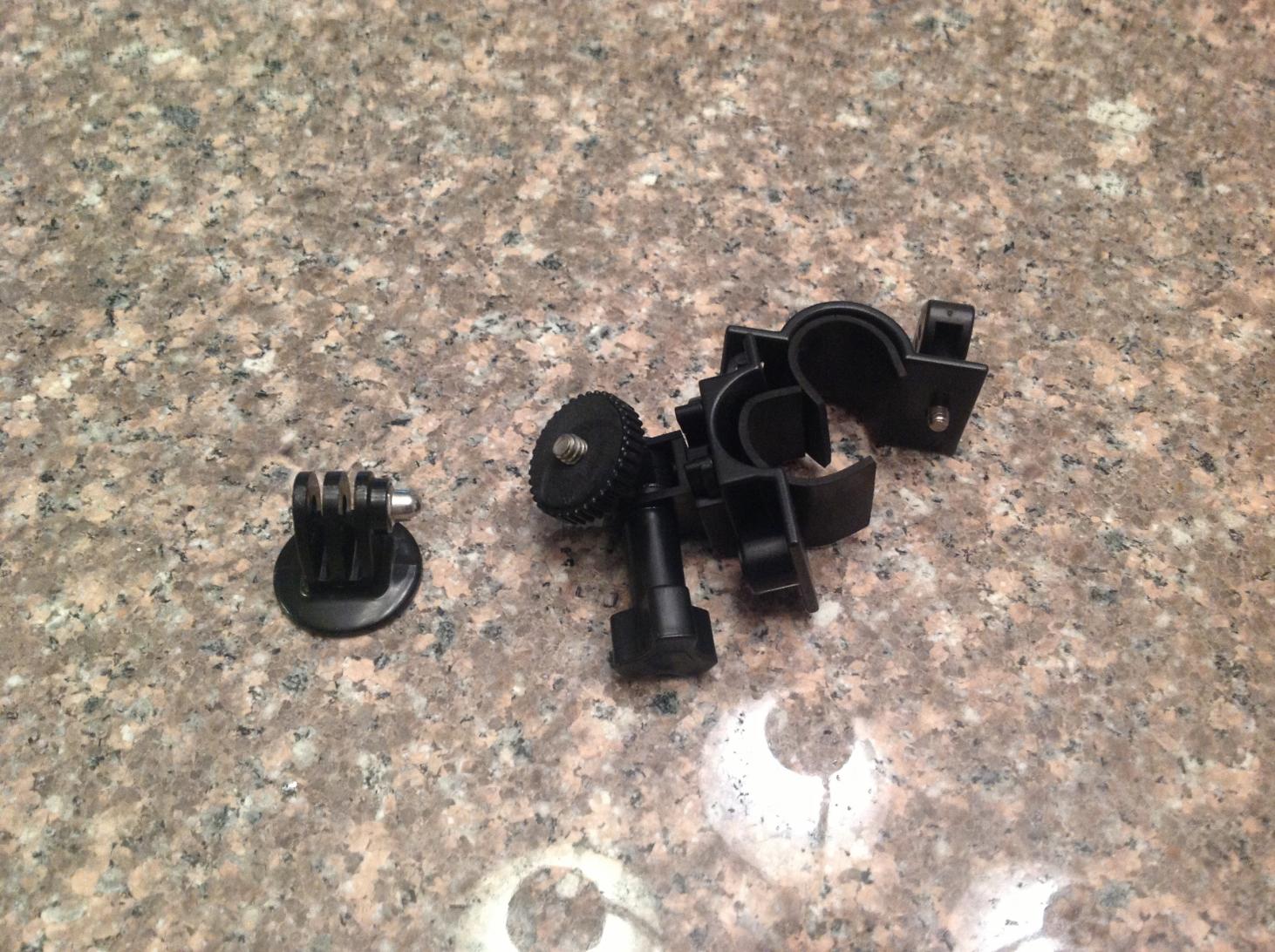

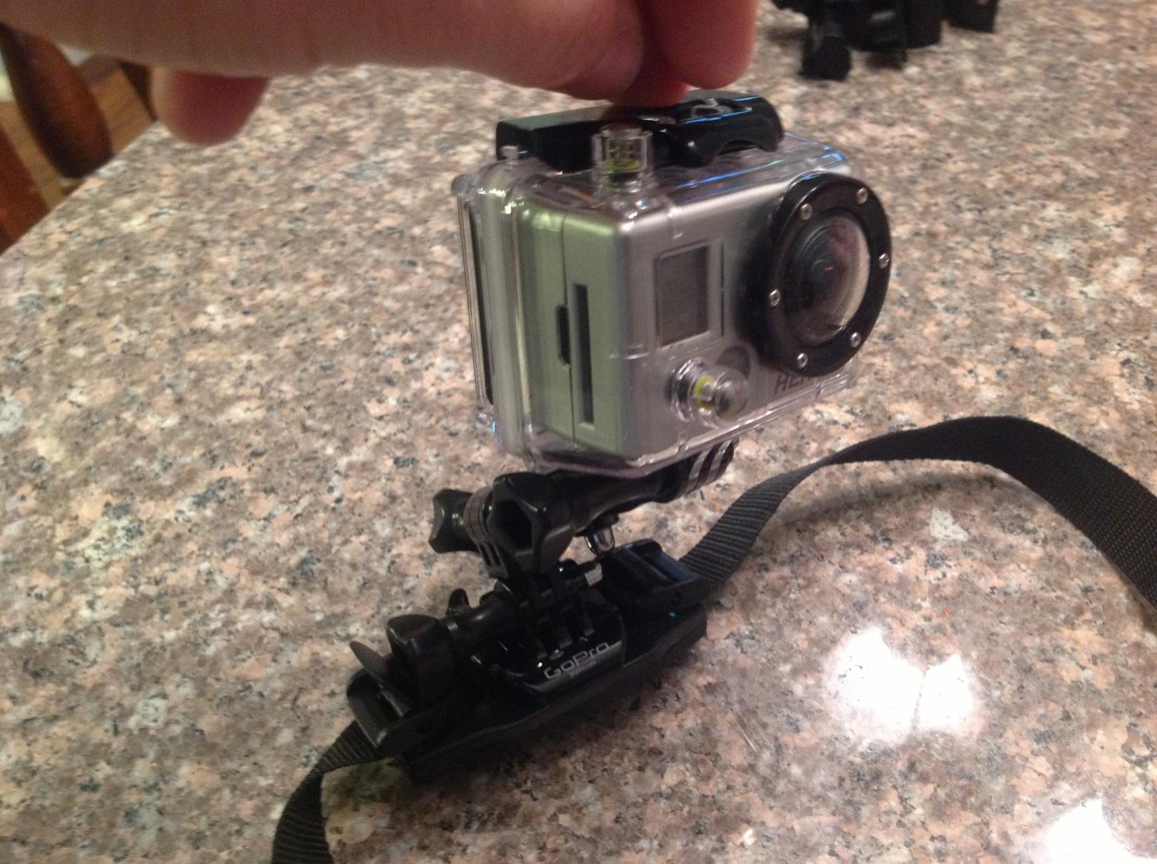

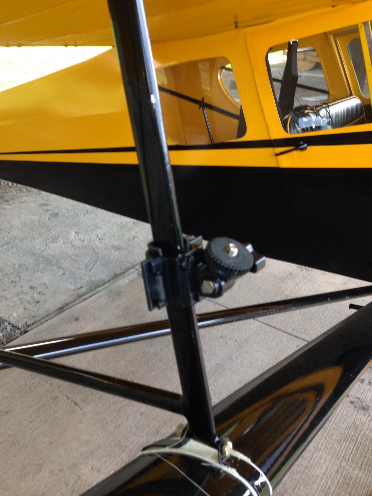

            Marty, I finally had the combination of being at he airport and a good memory. I have used two mounts. The first is a bicycle handle bar mount that my dad got in an Emerson camera. I have seen one for sale (amazon, eBay?) online. I use that on the jury strut. The handle bar mount requires the gopro tripod attachment piece. The second is the gopro helmet mount that came in the outdoor edition. The mount is readily available at stores. I attach it at at the strut fitting. I wrap duct tape around the straps for reinforcement. Not sure if it needs it, but makes me feel better.

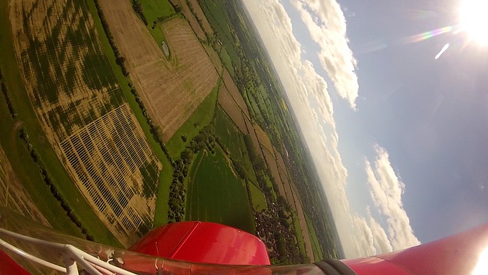

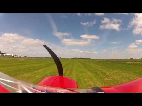

                        Andrew: I use cheap ND (Neutral Density) filter material; it works a charm to stop wavy prop.
                        Here's the problem without a ND filter (1 minute video):

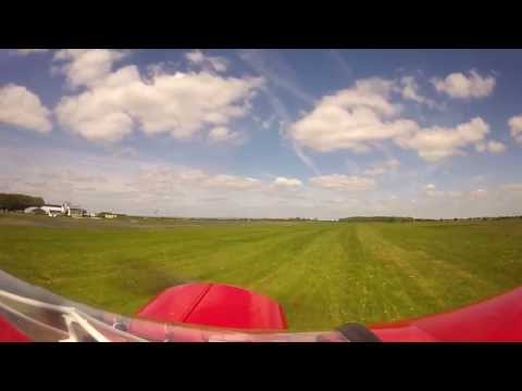

                          Here is the same flight a few minutes later with a ND filter on the same camera, still only one minute long:

                              Rob, the RageCam filter is listed as an ND filter, but I notice that it says "10% Filter", so I think it may just not be dark enough. Don't suppose you know what per cent filter is the stuff you're using?
                              Apparently the trick is to just fool the camera into using a slower shutter speed to blur the prop by lowering the amount of light getting to the lense. Here's a still photo of my dad's Tiger Moth that I did with the same camera, under an overcast sky:
                              Note the prop is just blurred, and not wavy like it shows up as in bright sunlight (no filter on in that photo)

                                As far as the "prop effect"...we're kind of stuck with it with the "rolling shutter". There are cameras that have a different imaging system (AVCHD) that eliminates the effect, but they are much more expensive. I agree with the suggestion of mounting the camera away from the view of the prop. Here are a couple of examples:
