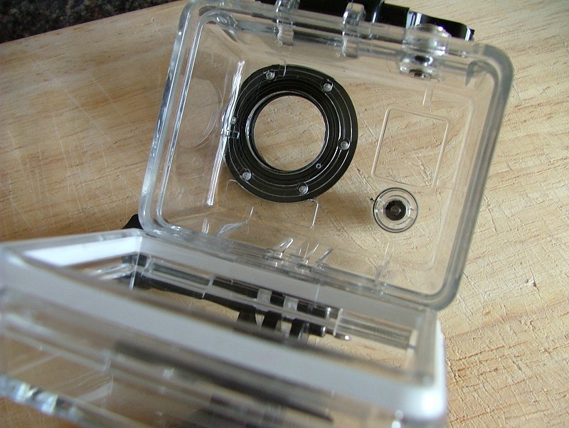

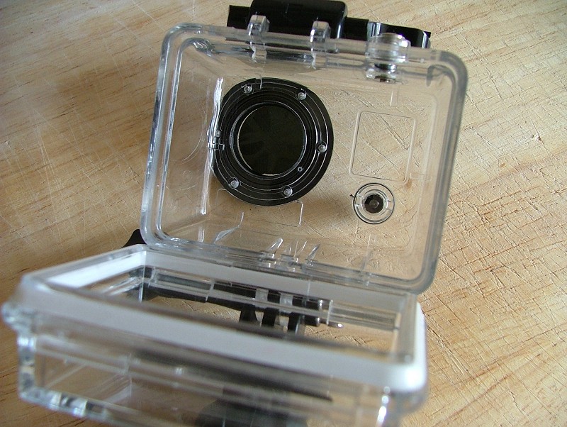

        It helps if you understand how modern electronic camera shutters work, compared with "old fashioned" shutters.
        These new-fangled things (as seen on digital GoPro's, I-Moans etc) have no moving parts, so to reduce the "shutter" speed (of course there isn't a shutter), you have to fool the "aperture" into thinking that there is less light than it thinks it is receiving, to achieve the same light level. So the silly digital machine opens its "shutter" for slightly longer for each "frame" than it would otherwise do.
        Funnily, that's exactly how old cameras used to do it, when the operator had control...now we have to fool these new-fangled devices.
        So a good ND2 filter kids the electronics, it reduces the "shutter speed", and bingo! the prop artefacts reduce. To the human watching the final video, the light levels are the same (assuming a decent light level in the original footage).
        Here's my GoPro 2 case with & without the ND2 filter:

          Great idea.

                      I purchased 1 foot square of ND film and punched circular discs out of it with a hole punch. $8 worth of ND film makes 1000 or more. What do I do with the rest?
                      Robert, I would purchase a strip for my GoPro?
                        Re: Video Clips
                        Sure, Robert, I'll get some in the post to you.
