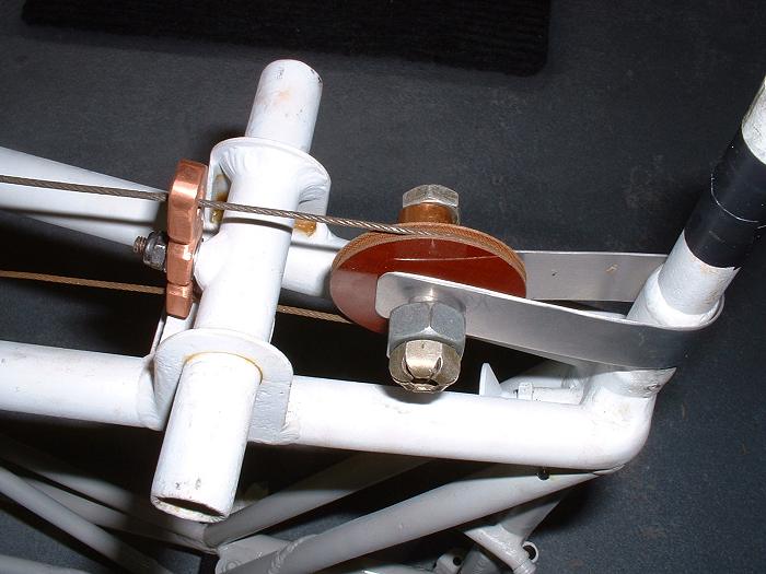

    I'm working in Jerry Self's old t-craft for the new owner and I need the phanolic block that the cable runs through back at the tail. It is the one that mounts just in front of the elevator trim pulley and directly over the cross brace where the down elevator stop is located. Please let me know if anyone can help.

    I did the UK equivalent of an "Owner produced part". This phenolic fairlead is lined with copper to lubricate the cable; quite difficult to remanufacture as per the drawing, so I chose to make one out of solid copper (busbar) on the basis that it was stronger than the original (fit, form & function remains the same...even the FAA's QA dept would accept that!).
    I chose to ignore the slight increase in weight from the original (less than 10 grammes) ....but you may see in the photo that I necked it down where I could to minimise the weight increase.
    Jon Timlin came over to the UK with his then-teenage son Jason at the time I was ready to make it, and Jason made it for me with a hacksaw.

          Use delrin or nylatron sheet self lubricating less weight.
          Keith Weber
