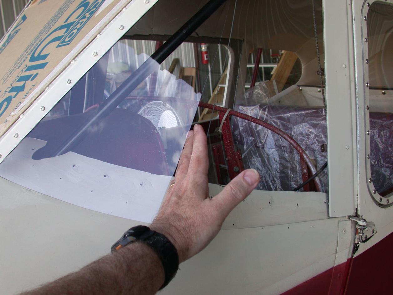

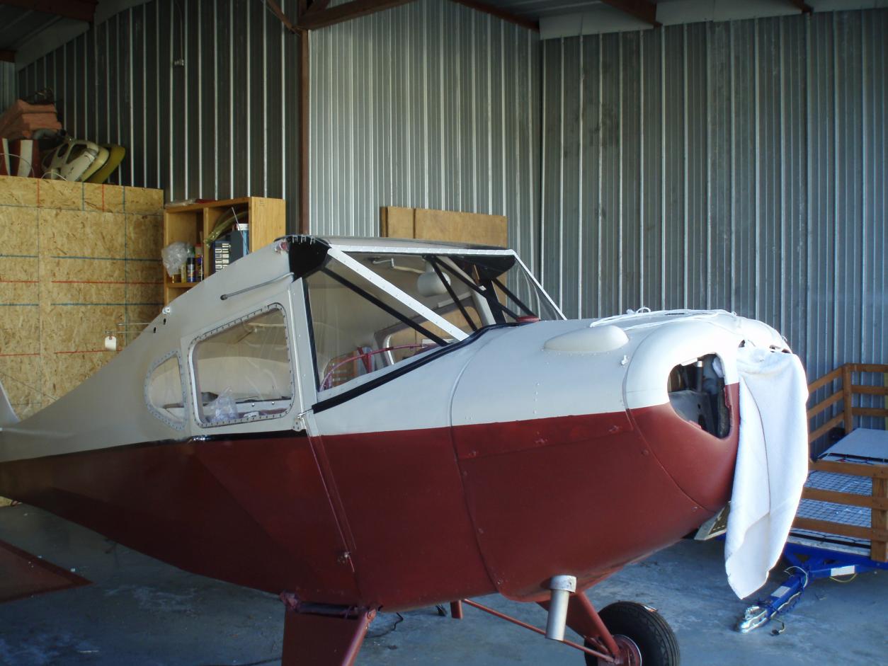

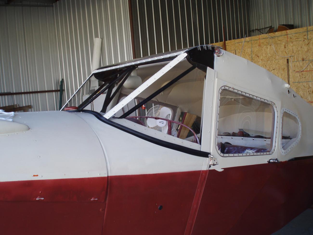

    I replaced my 42 BC12-65 windshield with the original type with the framing and flat pieces of Plexi (Pyrene is no longer available, and a good thing! That stuff was garbage and Plexi is far superior in strength and resistance to Sun light and fuels!). The material costs were significantly less than a formed replacement windshield but the labor involved more than made up for it. I also broke a LOT of the side pieces trying to curve them around! Good thing was the plexi was pretty inexpensive and I got a lot of practice in how much heat to apply (just below when bubbles appear but hot enough for the plexi to bend and hold the curve.
Name:	41T Windscreen temp1.jpg
ID:	196011 Click image for larger version
Name:	41T Windshield 1.jpg
ID:	196012 Click image for larger version
Name:	41T Windshield 2.jpg
      First photo is of the templates to get the exact size and shape. I could not get access to a rivet squeezer with a deep enough throat so I used 6-32 screws (with IA approval). Click image for larger version
ID:	196015 This is the typical way the side plexi broke from trying to curve it too cold. It was a fun sub-project, but I really wouldn't want to do it again.

          Be aware that none of them will fit without significant trimming and fitting. I would go 1/8" clear, and no coatings. If the UV is manufactured in that would probably be okay.

            That is a good plan if you aren't a bit over anal about being "original". I am always looking for ways to make mine just like she left the factory, but ask around, I am a bit nuts! ;-) Wish I could find a really deep throat rivet squeezer! I also learned to cover with Grade A Cotton and dope, but I am not THAT nuts!

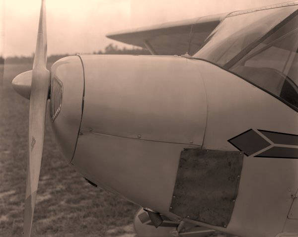

                  Here are a couple pictures showing the original windscreen. There are several pictures of pre war airplanes for viewing here, https://www.alliancememory.org/digit...lection/taylor . The molded windshield was a product of World War II. Click image for larger version  Name:	Windshield.jpg Views:	0 Size:	38.4 KB ID:	196025 Click image for larger version  Name:	Windshield1.jpg Views:	0 Size:	65.3 KB ID:	196024

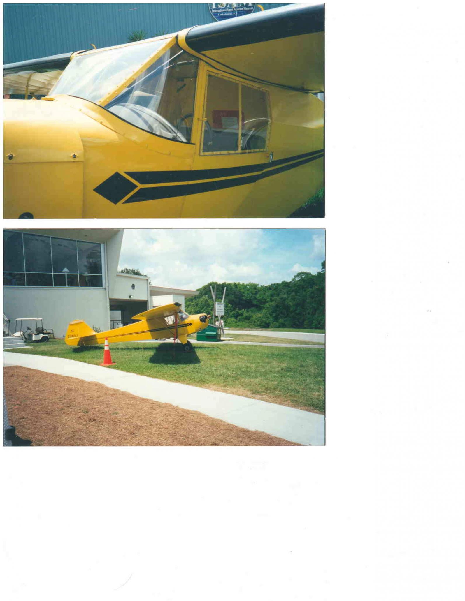

                        Found these photos of a pre war that was at the museum at Sun-N-Fun one year. This was over 20 years ago if I remember right.
Name:	41 T early Scans-0.jpg
