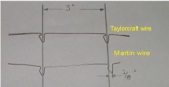

        If someone finds a wire bending company once the set up is done it is fairly inexpensive to make a run of wire. We found a company some time back who could do it but they found out it was for airplanes and hey refused because they were worried about liability. If you fond a wire company DO NOT MENTION AIRPLANES!!!! We refer to the wire as "Awning Retention wire" NOT RIB WIRE!!! There is a real demand for Taylorcraft wire and everyone be VERY CAREFUL. There is Taylorcraft wire and Martin Wire. The pitch is DIFFERENT! The wire can be "Joggled" but it shows through the fabric. Click image for larger version

          So what is the procedure (anecdotally) for using a bunch of shorter pieces? Such as how many holes should one piece hit as a minimum, and could sections be welded together to make a continuous run?
            double up the last hole. thats how these were installed.

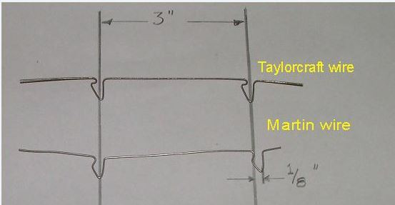

                          Who has specs for the wire? Material, diameter, temper and exact shape and spacing of the bends. I have a friend who owns a spring company. I am willing to ask him but will need real specs. I don't have a dog in this hunt since I've got L-2's but am willing to help.

                            The factory wire diameters range from .031 to .034. Material appears to be 0.031 diameter spring music wire Spec AN-W-15. T wire appears to be 303 stainless steel. Martin wire is Stainless Steel 302H. Note that is is NOT easy to test small wire like this.
                            J, Anderson did the attached drawing back in 2016 and it appears to be the same as some old stock wire I have.
                            Hank Taylorcraft wing fabric clip wire dwg.pdf
                              Thanks Hank. The drawing is just what I needed. I'll talk with my friend about it the next time we have lunch, maybe as soon as next week. I'll let you know what he says.
