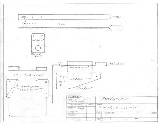

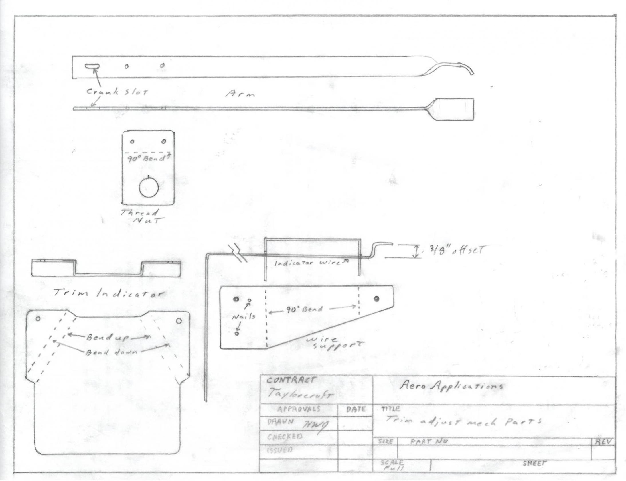

    John, some of the parts are fairly easy to get from the same folks who sold them to Taylor. The trim handle is a pre war car window winder handle and the chrome (or Nickel) plate above it is a plumbing pipe escuscion (spelling"). You will need to take the shaft with you as the hole will be different sizes for different pipes. The phenolic pulley is the same as many other pulleys but has a small notch filed in it for the pin in the shaft. I have a drawing for the trim indicator plate and several other parts but the problem one is the shaft. You will need to turn one on a laith and you will need a knurling tool for the part that goes through the pulley. Click image for larger version
Name:	Trim parts drawing-1.jpg

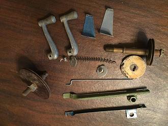

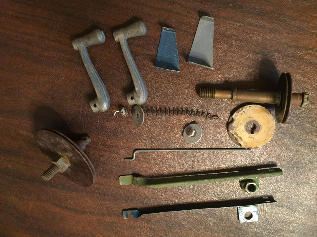

      This is the shaft but I will need to take some measurements if you don't find one. Click image for larger version
ID:	195139 Click image for larger version

                Finding more bits and pieces. Most of the wood parts are damaged or rotted but good for dimensions and making new ones. Got all the actual trim system parts now and doing some dimension sketches tomorrow. I am hoping there is a way to machine the shaft from a standard bolt. If you can find one I would bet it will be less expensive than machining a bolt down.
