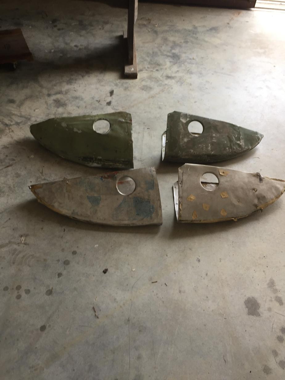

        I have these in the hangar. Most need some work and there are two more on my parts wings that will be a bit of a problem getting to. As you can see ALL of them need some work. Some are about as bad as what you have now. DO NOT TOSS THE ONES YOU HAVE!!! They are very repairable and if I have a set that will work I would want to get your damaged ones back to repair for the next plane that needs them. Click image for larger version

          When I rebuilt my 1946 BC-12D, I was amazed by the amount of aluminium spot-welding that was used back then. My doors, and these wing-tip pieces spot-welded together. Another example of some clever work by C G Taylor and Jack Gilberti to reduce production times & cost.
            Now THAT is some pretty metal work!!!! Rob, do you have any idea what your planes original N number and serial number was? I would like to add a lot of your photos to my database and it is sorted by N number (I keep the current regestration too, but the SN shows where a plane was in the production line)
