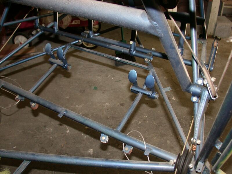

    Where are you? Your info says "YT". It that the Yukon?!?!? I have an uncovered 45 T with RH brakes from the factory (welded in) you could copy but I'm afraid it would be a bit of a trip from the Yukon to SE Virginia!

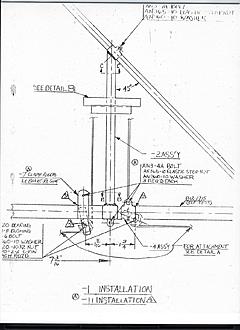

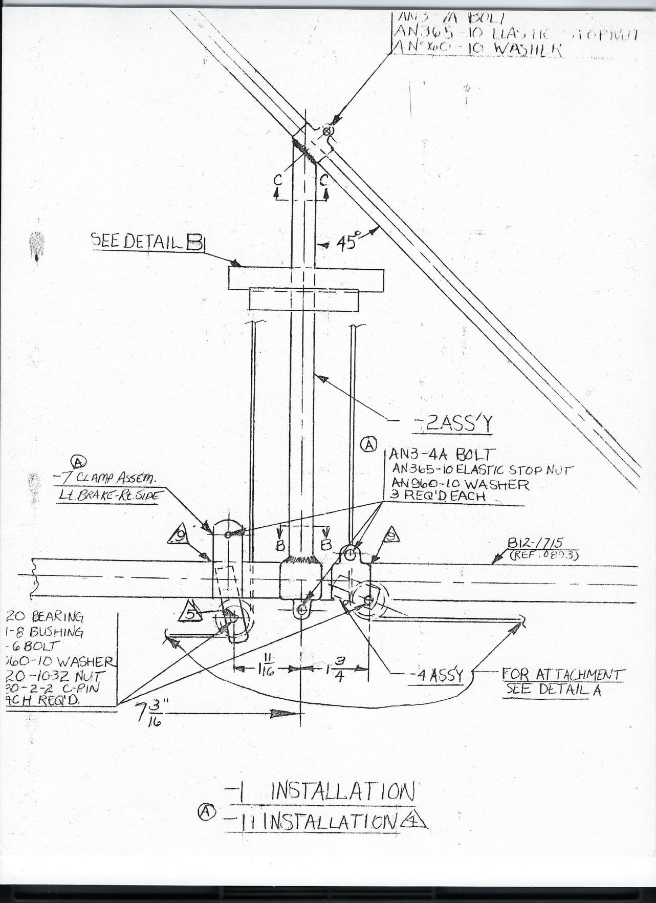

      Just found this in my drawing file. Hope it helps! Click image for larger version

        This is the BOLTED IN system, not what is in my plane as a prototype install. As I remember it matchd up to mine except mine is welded in.
