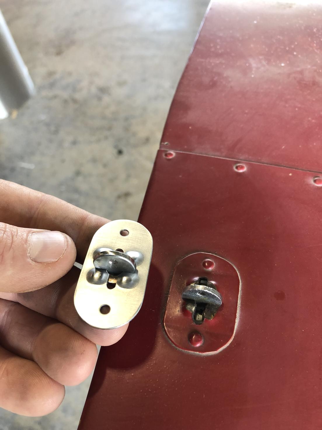

            I had a guy come look at my Rearwin project to possibly help with its cowling repair. Touring my toy box we stopped at one of my L-2's and I asked him about a source for Boeing fasteners. Turns out he makes them, or at least one style - the oval plate. He made dies and stamps them from 304 SS. He said there is also a diamond style like my L-2 and, I think, a rectangle but he says the keys are all the same. His name is Andy Lasswell, (281) 687-3121 at KDWH. He doesn't have a current price since he hasn't sourced the spring or pin in a while but probably $35-40 per set. He does impeccable work.

              Thanks for the info Greg. I got a hold of him and I think he can help me out. I was able to get a set of L-2 eyebrows, so that is good. Exhaust is TBD...thinking I am going to proceed with a split exhaust.
