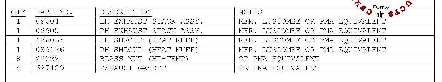

Split header Luscombe 8E parts list attached. Installation data and Approval are $250 from us at C.A.P. Sources of new parts: Univair, Wag Aero, Classic Aero. We recommend you discuss with them to make sure they have the welded tabs for the heater shrouds. (Carb heat and Cabin heat) - See parts list below.

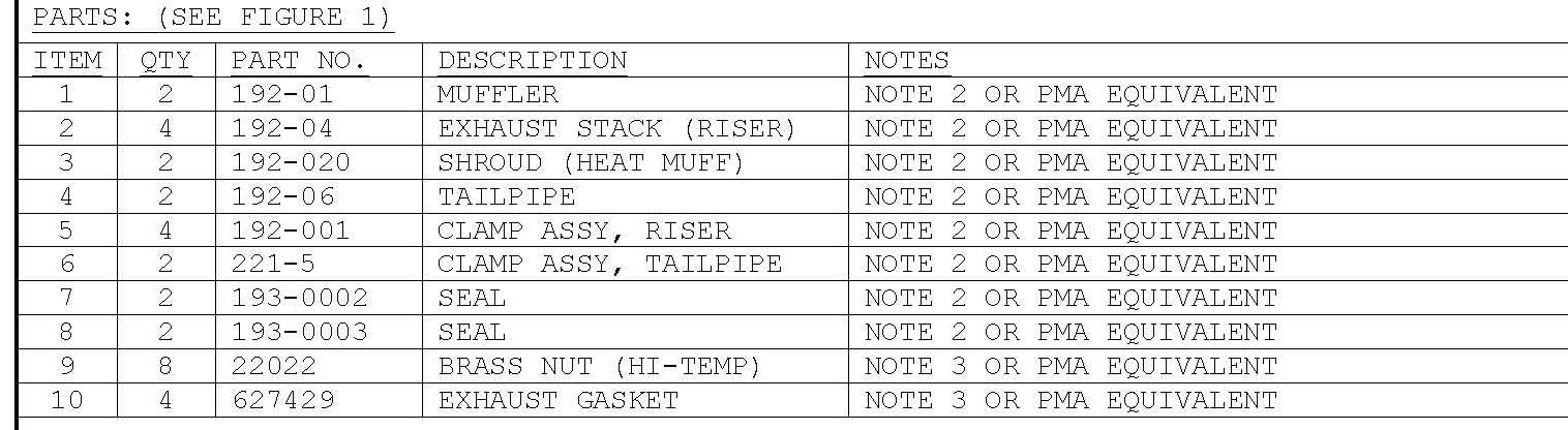

(2) Aeronca 7EC, Similar to 150 but tucks in tighter to engine. Might be available from American Champion. Try Wall Colmonoy and AWI for parts. See parts list below.

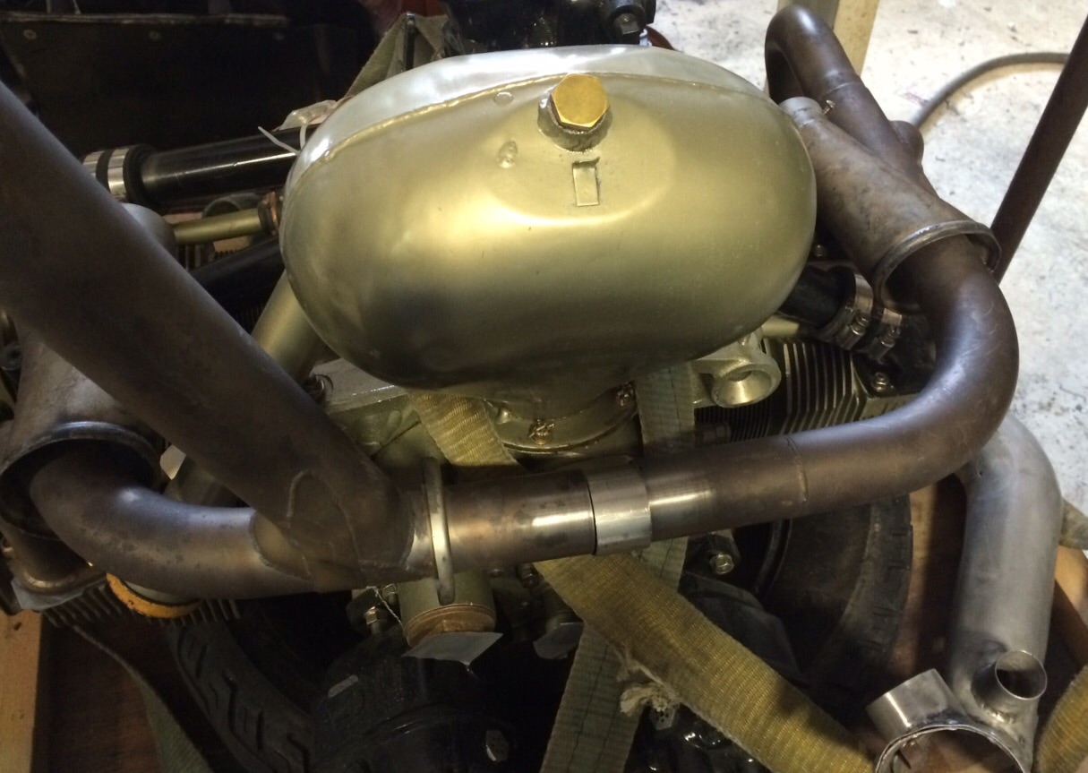

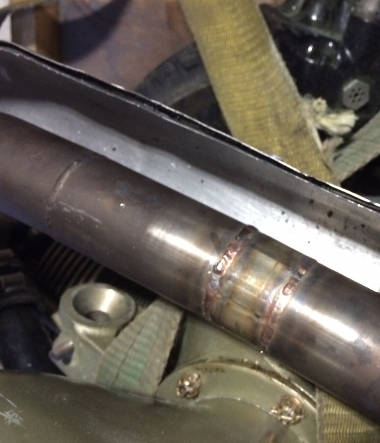

For my C85, I modified a TCraft exhaust for an A65 by adding a ring of material.Attached FilesTim Hicks
N96872
Re: C85-12F exhaust needed
I did exactly the came as Tim Hicks when I changed from A65 to C85; never been a problem (but it was built properly in stainless in the first place for my A-65) Back then, in the UK, in 1994, came to about $1000 (without the aluminium heat muff).

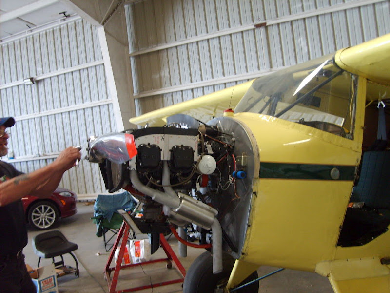

My approved C-150 exhaust on a -4 mount requires no cowl bulge-fairings. Atlee Dodge modified the header stacks to bend the mufflers closer to the engine, probably not for free however.
GaryN36007 1941 BF12-65 STC'd as BC12D-4-85
