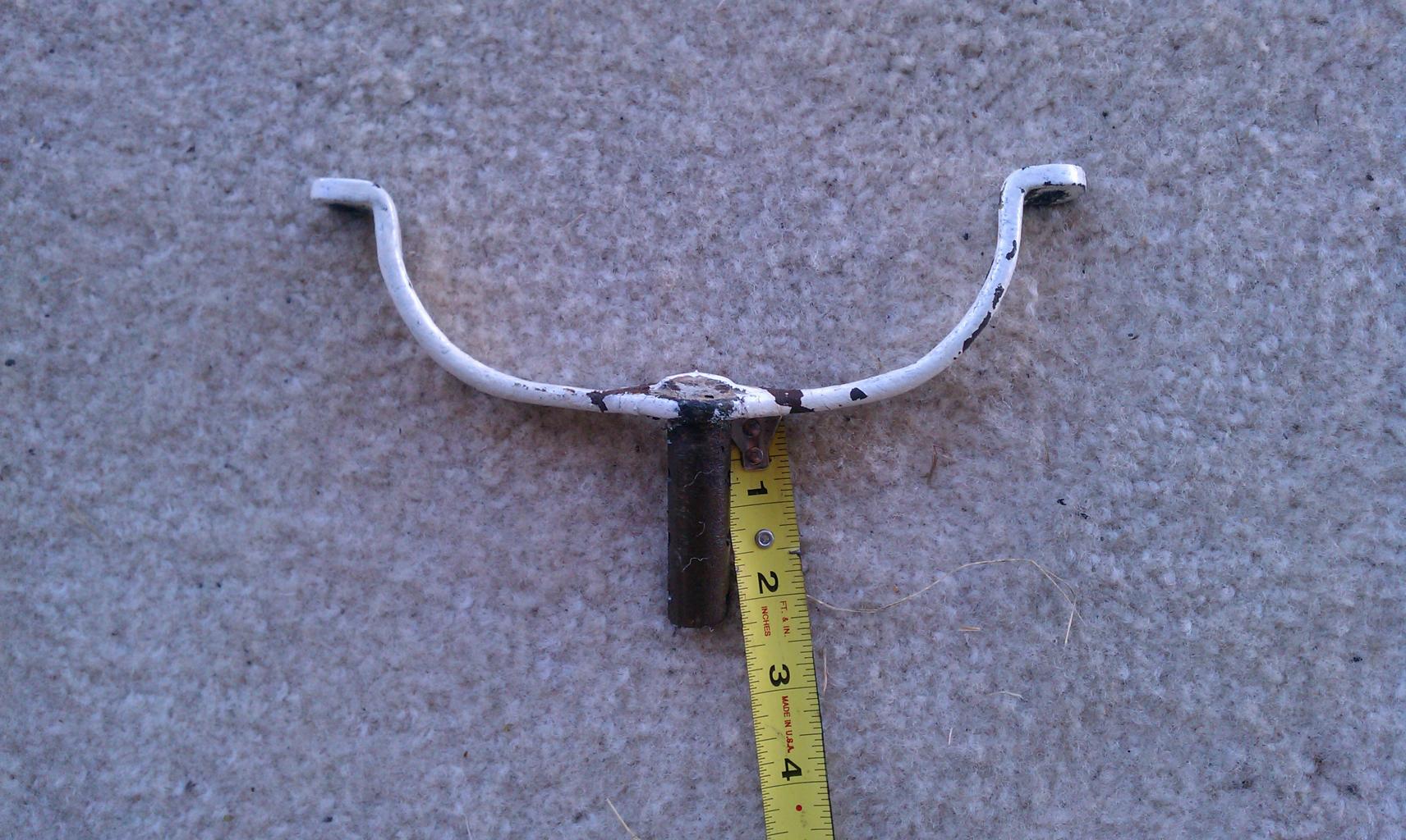

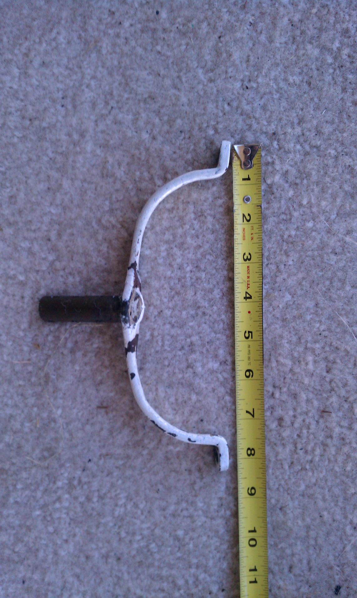

After landing on a hard surface [ I guess it was a pretty hard landing
], the left arm of the Rudder Arm/Horn broke... yes, on landing, so no steering other than by shinn brakes.... and yes...it was an experience.
Im told that the 3/4" shaft on the aluminum Rudder Arm sold by Wag can be lathe down to 5/8" to fit into the rudder post [ found a shop that will do it]. No problem here. Now, the shaft is "only" 1 5/8" in length (tall), which does not extent enough into the rudder tube to have the three bolts to go thru it. Maybe one !!. Thinking of maybe drilling two new holes at 180 degrees to each other at 1/2" distance from the bottom, top and of each other. I would hate to drill more holes into the rudder tube at that point and possibly weaken it at the stress point when steering the tail wheel.
Have anyone solved this situation?. any ideas / suggestions are appreciated.
and... no, I will not use "JB Weld" to get it back together.... but I have been thinking about it, though.
Thanks
Ralph
