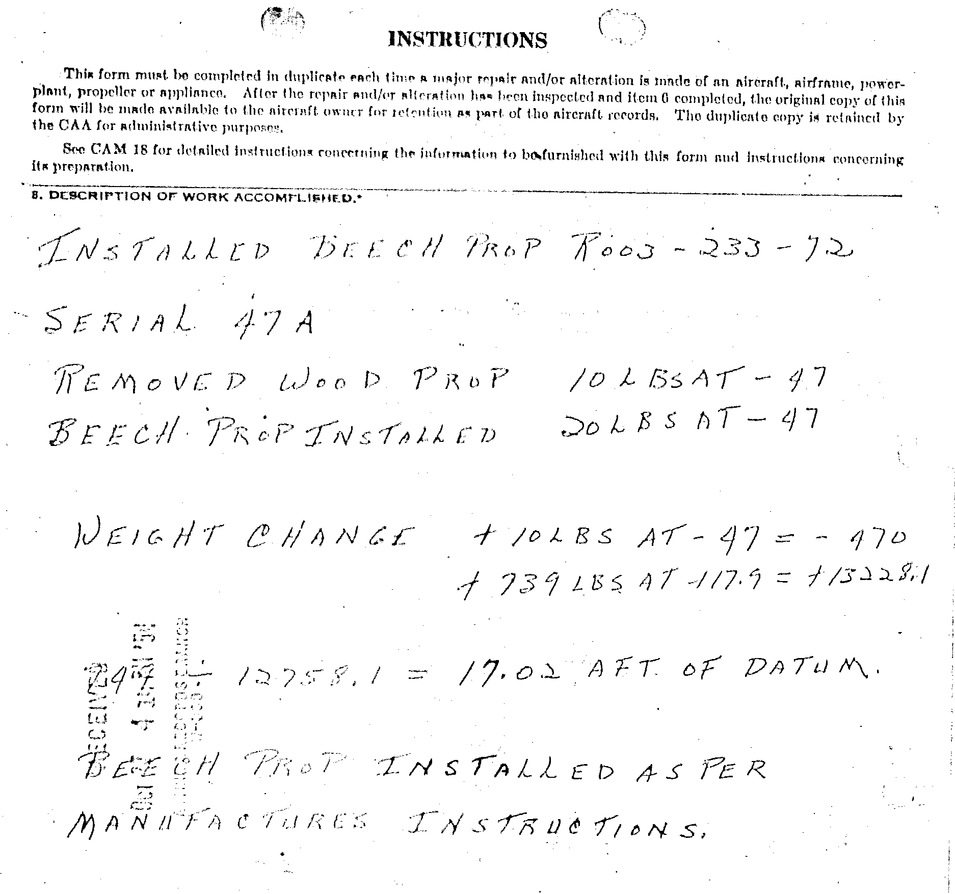

                          If so, I wonder why. 'Adjustable' prop is listed onthe 65 Lyc.Tcraft sheet. and it doesn't say 'ground'so it could be a Beech Roby
                          The Beech Roby is listed on the 65 Cont.Tcraft sheet.
                          Each of those installations would be a minor alteration and not require a 337,just a maint record entry.
                          • #73
                            Re: Looking again
                            Originally posted by stearman3 View Post
                            Ryan, did they do a 337 on a Beech Roby?
                            I wish I knew... I wish I knew. Here's the offending piece.
                            Click image for larger version
                            I honestly didn't realize it was anything other than a different prop.
                            Ryan
                            Ryan Short, CFI, Aerial Photographer
                            Former Taylorcraft BC-12D owner - hopefully future owner as well.
                            KRBD and KGPM - Dallas, TX
                            TexasTailwheel.com
