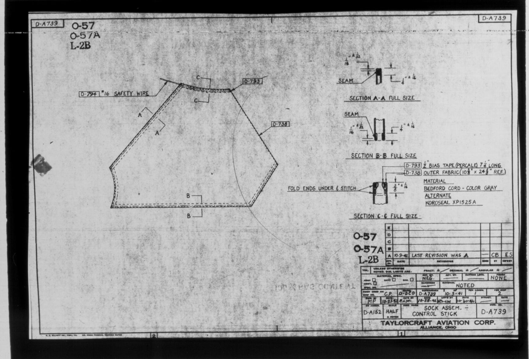

    My L2-B never had boots on the sticks when I bought it. I'm getting tired of stuff falling down through the holes so I'd like to make some. It would be nice to have a pattern to work from instead doing a lot of guesswork. Does anyone out there have a pattern that I can use or better yet make me a pair?

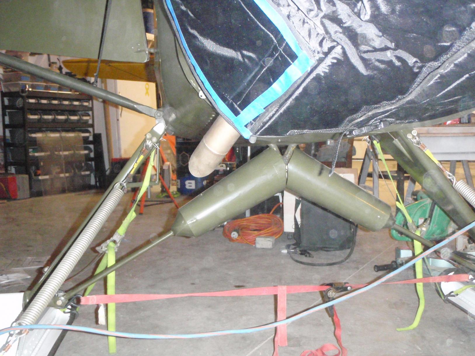

    On another note, I have finally finished rebuilding my landing gear including new bungees, all new bushings and hardware, and new bungee covers. After finally figuring out how to put on the bungee cords, I made a bungee cord installation tool out of my bi-fold hangar door. It went pretty easy after that. I made the bungee covers a little different from the originals so that they cover the entire bungee cords and hopefully keep engine grime off of them.

        My parts manual calls it a sock assembly - control stick, part # D-A180 on page 117 index #20. From the looks of it I may have found yet another use for a "Crown Royal" bag.

          Re: Stick boot
          D-a739

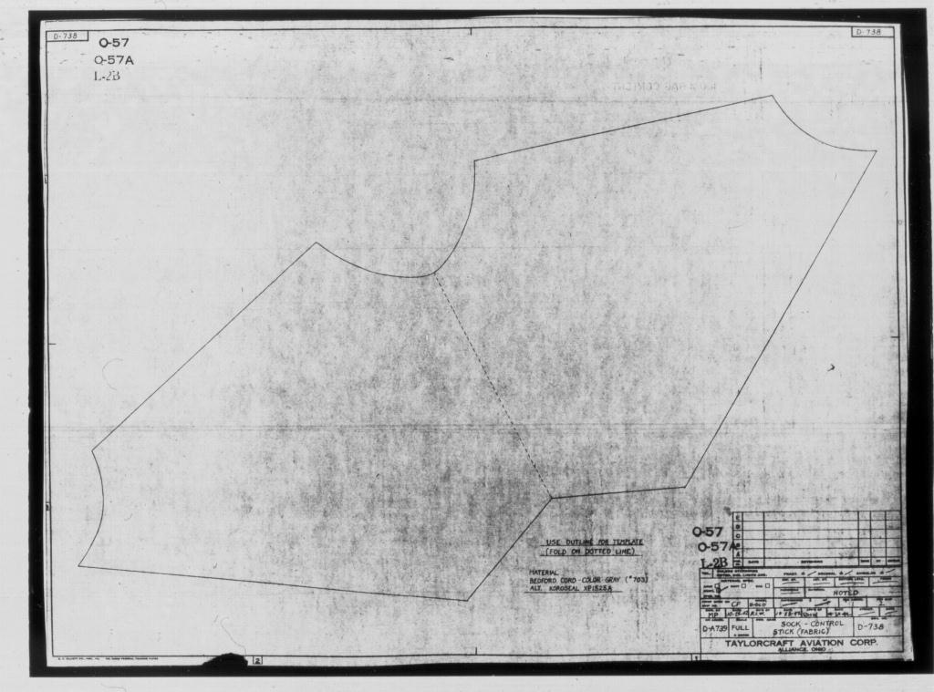

                  I have the CDs as well. The only thing is that the boot part number is an assembly drawing and lacks the all important dimensions. What I really need is a drawing for part number D-738.

                    Re: Stick boot
                    D-738
