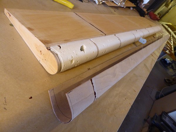

          I have reason for asking...I recently made a new all-wood aileron for a Pitts S1 (as well as rebuilding the wing, but that's not relevant).
          The leading edge of the aileron was constructed using two 1/64 ply laminations, supplied by Aircraft Spruce. That aileron is now flying quite happily.
          If you'd like photos, let me know.

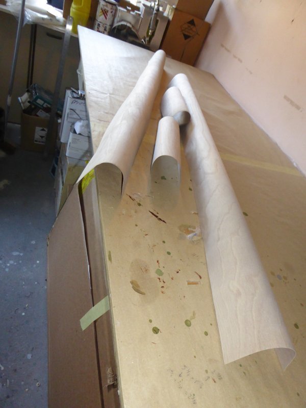

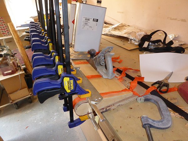

              But bending 1/16 ply about such a tight radius for the leading edge might be a challenge, without a big steamer, like what they would have had when originally manufactured.

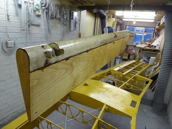

              When I made my Pitts aileron leading edges, I laminated them AFTER forming the shape using 1-64 ply, see attached photos.
              [The foam is a requirement for this particular version of a Pitts aileron; so ignore for your Taylorcraft.]

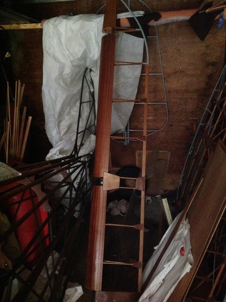

                Mitch,
                I was fortunate in that my project came with some nice newly built Click image for larger version
Name:	photo 5 (1).JPG
ID:	185729 ailerons.
                Ray
                  That looks lovely, Ray!
                    Rob,
                    Is that your kitchen in the back of the garage in picture #3? Looks familiar!
