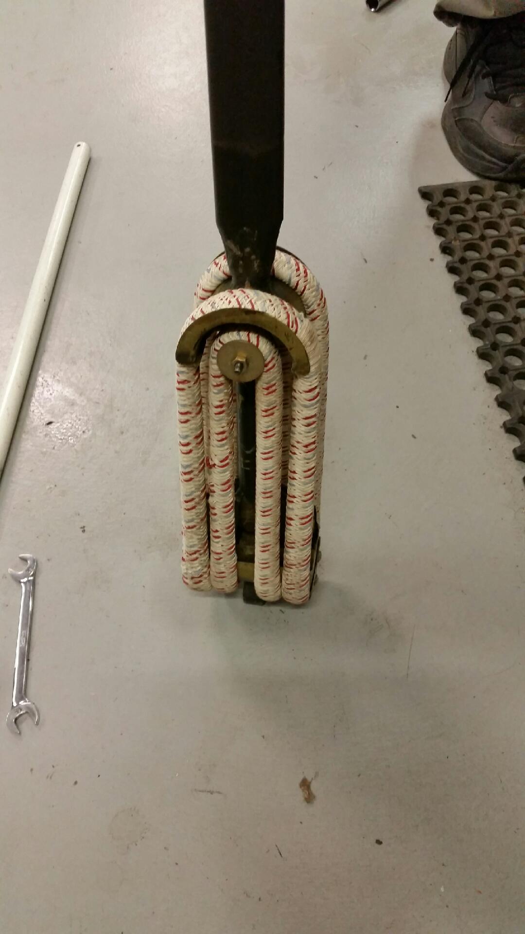

I have been looking, but cannot find, a picture of the bungee cord arrangement for the L-2 landing gear strut. Thanks in advance.

Does this show enough? https://backcountrypilot.org/forum/t...allation-20911

Gary,
I've seen this one, actually the bungees don't go on top of one another. There are two separate locations, one for each bungee. I could not remember how they were arranged until I went out and looked at the removed strut from my friend's plane. They got them on and arranged correctly. I will have my friend send the picture he took.Cheers,

I watched that video but it seemed like lots of work without a dedicated tool.
