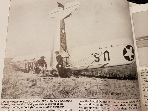

The L-2 has a 'faster' wing than an L-4 or L-3 and is less forgiving than the flat-bottom wing of the L-4 and L-3. Stall/spin accidents were becoming too much of a problem and after five crashes the L-2 was grounded pending investigation at Fort Sill during WWII. Here is a photo of a photo in a book I have on liaison aircraft in WWII.Attached FilesCheers,

All the small aircraft manufacturers worried about back then was somehow staying in business and building liaison aircraft, (for government money), was the way to do it, along with building parts for other manufacturers' aircraft. No need for R&D, they were just trying to keep their heads above water.Cheers,
