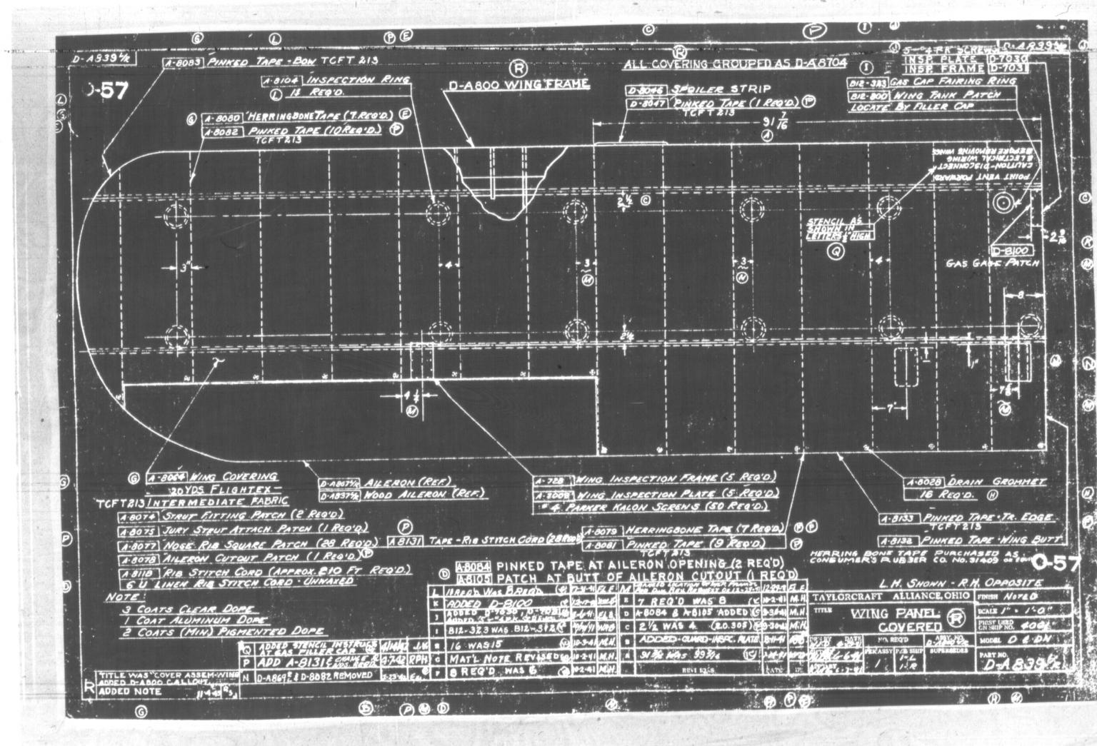

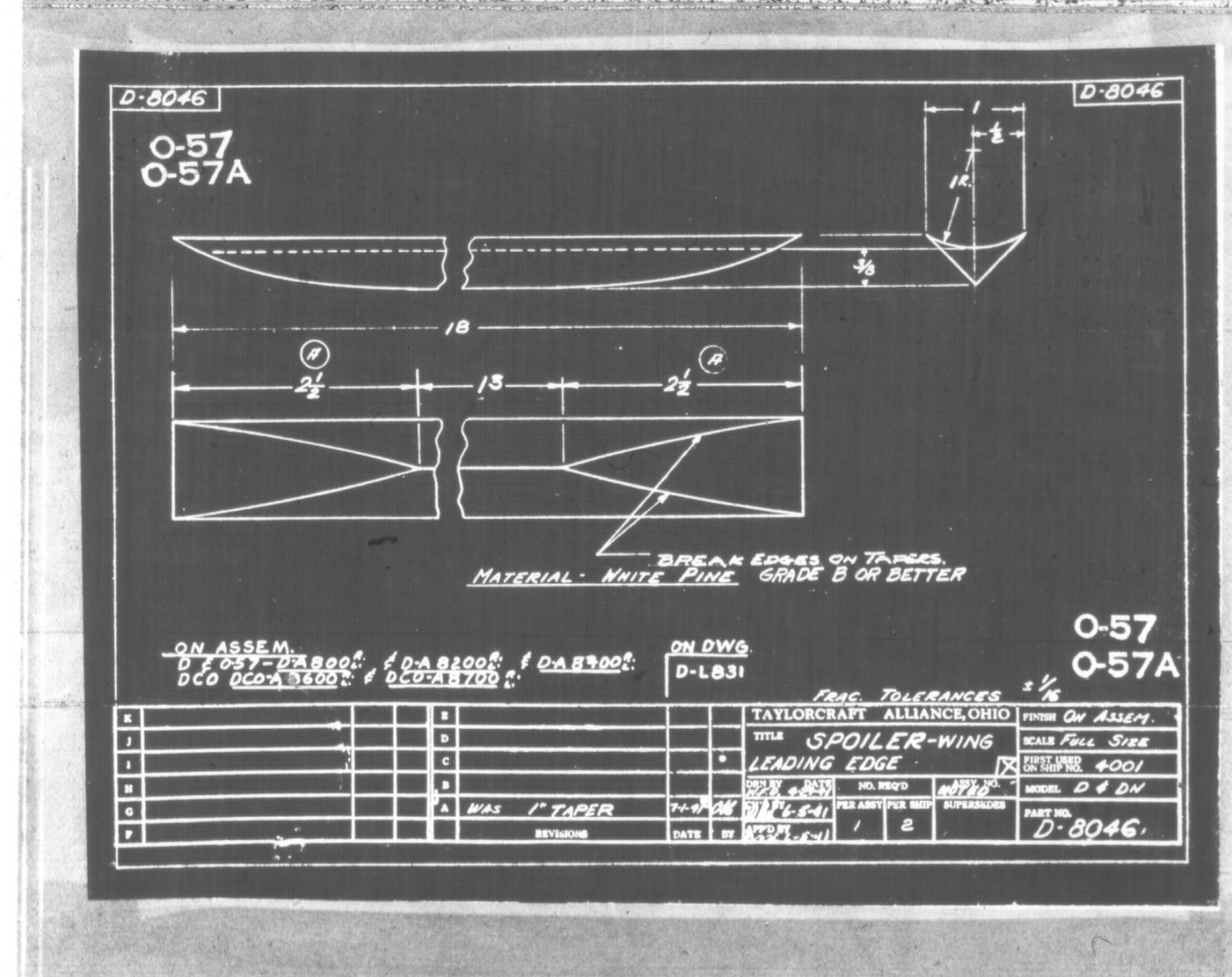

      Re: L-2 Questions
      Yes, see drawing.

              I interpret it as all - it shows D & DCO assembly drawings and has the O-57 & O-57A stamp. Only the M had the pop-up spoilers. There's no reason you can't glue them on the fabric/silver and then put a tape over the strip. You'd still have to bring the taped area up thru silver but no need to cut anything.

                Does anyone know where on the leading edge the stall strip is supposed to go? The location along the span is probably important, but how far around the leading edge would be CRITICAL. A stall strip too far up or down could be down right dangerous! Even a 1/4" error could cause some really bad flow separation.

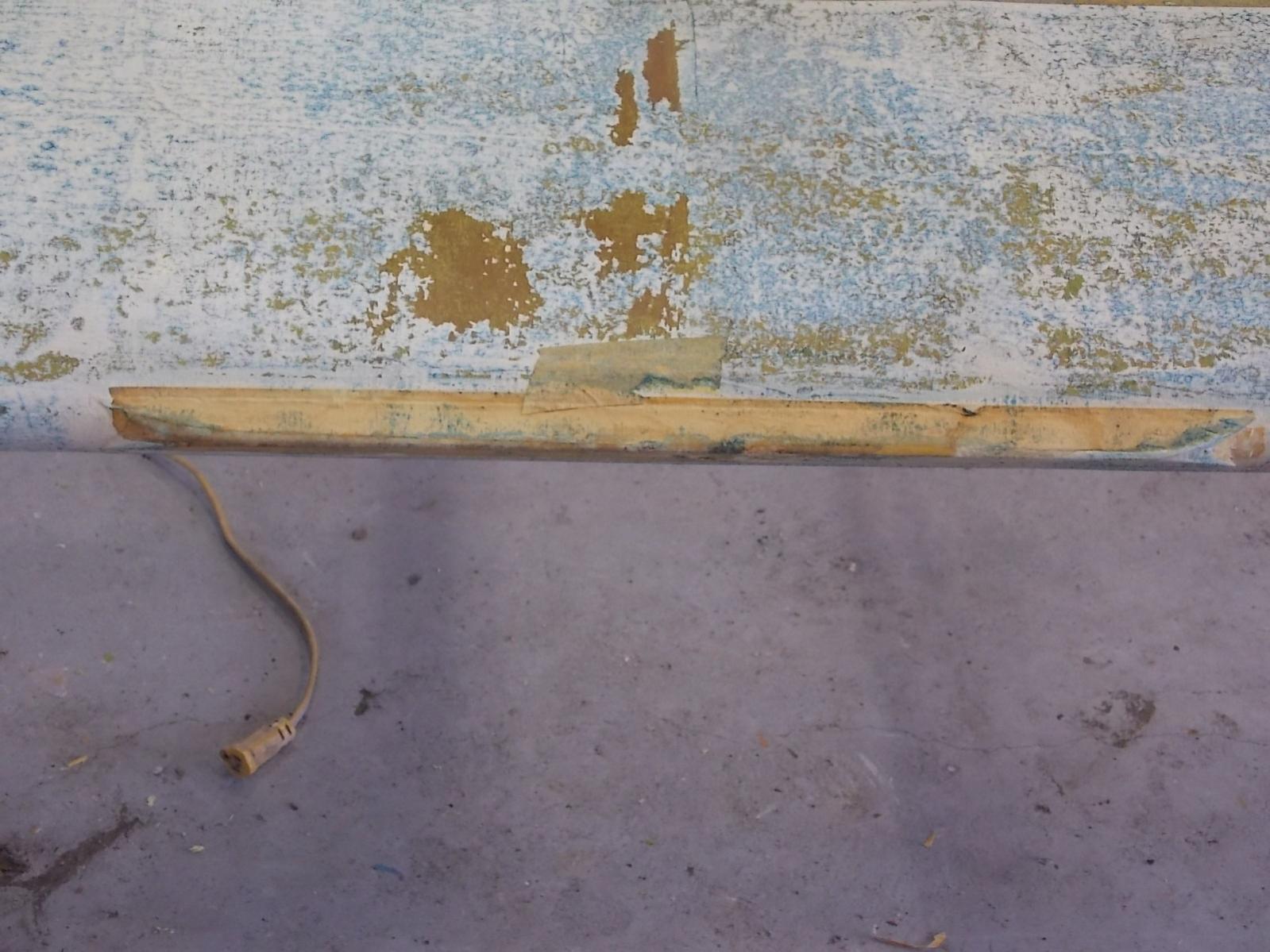

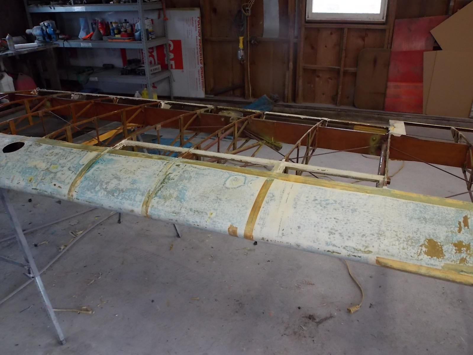

                  This is a wing that is original from 1943 it is off a L2M we went threw it and covered it for the owner the stall strip is located between the #8 and #9 rib bay and here is a photo of the placement on the leading edge.

                    Hank is right on, spanwise location is very important. But also important is chord location on the airfoil so the effect is proper as you approach and go through full stall.
                    Chuck, do you have a photo from the side to see if it is right on the leading edge, 0% chord or possibly slightly aft/down? It is a bit hard to tell from the photos.
                    When you bond them on you might want to make cardboard templates to help ensure you get them in the same spot on both wings if they are not right on leading edge.

                      See attached drawing for span-wise location of leading edge spoiler, still looking for other drawings.

                        Re: L-2 Questions
                        Looks like the span wise location is pretty simple. Put it in the last full rib bay before the aileron. That tells me they wanted to trip the flow just inboard of the aileron. Most stall strips are either at the root (because of a problem with the stall initiating too far outboard, which caused the plane to roll, sometimes violently, as the stall progresses outboard, or to cause teh stall to CONTINUE to progress outboard when the aileron is deflected. You usually see stall strips on BOTH sides at the root (but not always) and more often on one side only at the aileron.
                        The SERIOUS problem is how far around the leading edge you put it. If it is located too high on the leading edge radius teh stall will start early. Too low and it will start too late. NEITHER is a good thing. You want the plane to stall as close to straight ahead as you can and NOT roll off on one wing. Moving it UP on the left wing will cause a left roll, too low on the left wing will cause a right roll. The other thing is power settings can change when the stall starts and how fast it progresses outboard. Some planes become a real bucket of snakes when the stall strips are left off or set wrong. There SHOULD be a drawing that shows EXACTLY how far up or down the strip should go. This is NOT something to experiment with!
