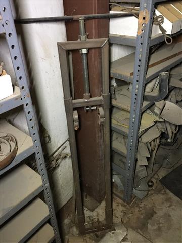

        finally posting a pic of my tool i built. its based off the b model tool.

          Mike,
          That looks a lot simpler than what I observed in a YouTube video. Drawings, by chance???
          • #35
            Re: L-2 Bungees and Tool Revisited
            Mike,
            No, but I could probably make some. I built it as I went using the "B" model tool as a guide

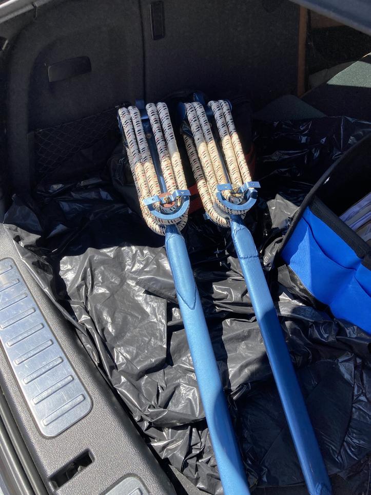

                        Just had the bungees replaced on my DC-65 by Calaveras Airplane Company located at CPU airport in Central California. My IA visited some You Tube videos and then built a jig that worked great.
                        Charles Rooks
                        DC-65, Serial 4025

                            • #44
                              Damn. I wouldn't want to be standing there when that cable breaks!
                              • #45
                                I built something like that in 1969 for my L2. I used an old car ratcheting bumper jack. Bolted the strut to bottom of jack and streached bungy as in video. Flipped strut over and slipped bungee on strut. Worked easily.
