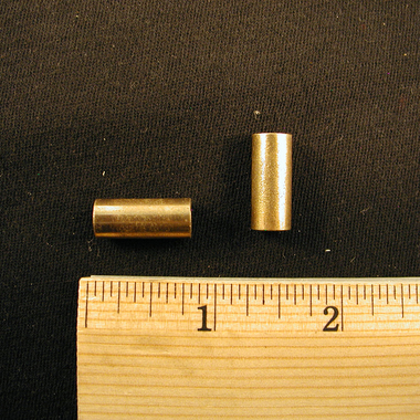

          Question: When replacing control surface bushings are they pre-oiled or just plain brass? I've replaced them on a few Cubs but not yet on my Taylorcraft. Usually just a drop of 20W non-detergent electric motor oil once in a while. Some like graphite or moly in the oil.
            I always made my own so they were Oilite, Gary. I don't know what "real" parts are!
              "real": https://www.univair.com/taylorcraft/...leron-bushing/
                I don't understand how you could make your own, John (unless you sinter them yourself in a mould?). Oilite is a sintered product, and machining them will seal the pores that give the material its oil-retaining abilities, surely? But I'm willing to be edumicated!
                  We've always machined it. Never had an issue.
                    factory said to press fit in, ream ID to final size
