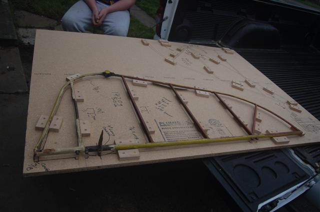

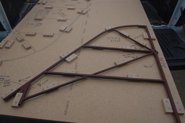

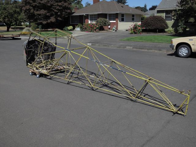

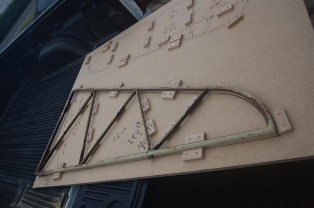

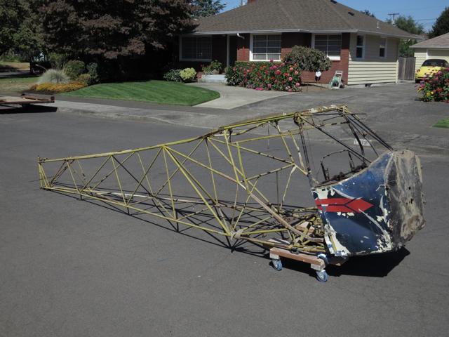

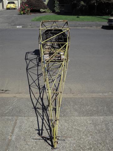

    I am starting with a 1938 Fuselage that has been on its back sometime probably before I was born. Then was stuffed in the rafters at the local airport, and forgotten about. I don't really plan on putting it back in the air, but rather using it to build a duplicate out of 4130, with any mods that need done incorporated. I made a set of jigs from a post war tail, and am looking for a set of pre war's to possibly blend with them. Big post war V.S., big pre war Rudder ??? best of both worlds, or worst of both?

    Oh yea, and Pics. Everyone loves pictures.

                          By the way, there is some serious talk about a fuselage fixture to repair and build new fuselages. That old 39 fuselage, DON'T CUT ON IT! It isn't much good for what you are building except as a pattern, but it has a lot of value to someone restoring a pre-war plane! It is also a gold mine of information for making the fuselage tool.
