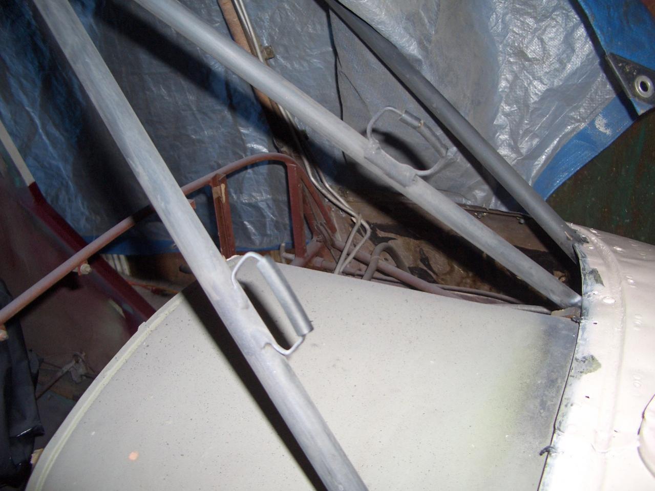

    Does anyone know where I can get new bumpers for the windshield? These are the tubes on the wire supports in front of the windshield tubes (see the picture). Mine are very hard and cracked.

    On my planes the tube was just fuel tube and the wire looked for all the world like coat hanger wire. It wasn't even very GOOD fuel line. Just rubber hose without even the nylon webbing imbedded in it.
    I wouldn't have used it to carry fuel on my lawn mower, but it worked great to keep the windshield from vibrating. Note that the bumpers are NOT to support the windshield. From what I have seen they just keep the windscreen from flexing as the pulses from the prop pass. More like a shock absorber than a support. Interesting that every one I have see was welded to the steel tube after the hose was on, so no one was worried about the heat damaging the fuel tube (and it wasn't burned or damaged). Slip the fuel tube on, bend the wire around, wrap the fuel tube with a wet cloth and tack the other end of the wire down. I am betting they added the loops because it made people nervous to see the windshield move.

      <snip>..Note that the bumpers are NOT to support the windshield. From what I have seen they just keep the windscreen from flexing as the pulses from the prop pass. More like a shock absorber than a support.
      I'm not sure I agree with that; the 1946 and on windscreens (sic) have quite a large flat surface that presents some significant resistance to airflow, so I think they do support it (in flight). My rubber mounts are about 1/32 or 1/64 away from the windscreen in the hangar, and in full bodily contact in flight.
      But I do agree with soft rubber hose, preferably not reinforced hose, so as to be as flexible & soft as possible.

      Edit: My braces are not welded at both ends (April 1946 BC12D); see picture without the hoses put on:

        I like the way your wires are attached much better. Looks much cleaner and no weld damage to the paint or potential to burn the tube. I wonder who decided to weld the second end on mine? I think I will go back to your configuration on the 45. The 41 doesn't have the wires or bumpers with the 4 piece flat panel windshield.
