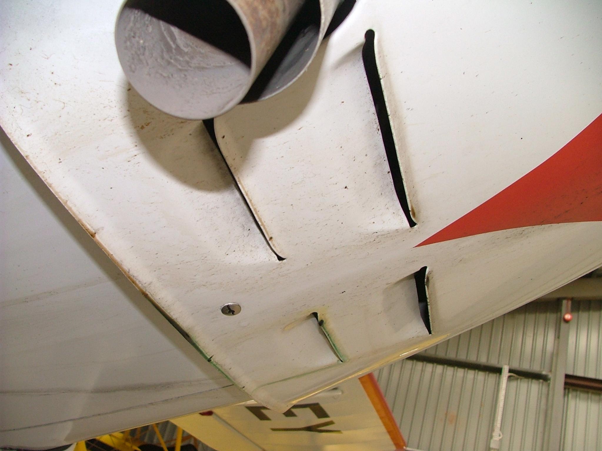

    Hi Josh,
    I do have the lip as well as the louvres. I think my engine runs a bit cooler than necessary, so iin the winter I have to block off the front air intake.
    Here's a picture of the lip (excuse the messy cowl!)
      Re: Louvers or Lip or Both?
      Thanks, Rob! That's just the picture I needed. I notice that the louvers also have little raised edges on the outside as well. That is a tremendous help!
      I'd be much more concerned if the cowling was spotlessly clean. That would indicate it isn't flying!
