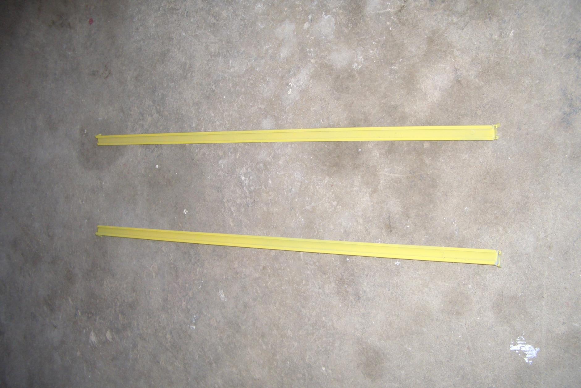

              3. I have two extra brackets (shown in the attached photo). Are they used in the tank installation? On the left wing, they are just placed between the front and rear spar right next to the root rib, top and bottom and screwed to the spars (see the second photo). Do I just put them in the same way on the right wing with the tank?

                Those parts shown in your pictures do not look like the straps that were used to hold the tanks on my airplane. My only experience with all this is what I learned on my airplane only. Those may be used on a earlier or later model, but they look like a homemade part to me. I would be very leery of screwing anything into the spar to hold the tanks in place. I don't know. That may be the way they did it at the factory at one time. But it looks like poor engineering to me.
                The straps on my plane were flat strips of steel. They had soft bends (1/4" radius) at each spar and a sharp 90* bend at the middle of the back side of the rear spar. Where the two ends came together at the 90* bend, each side had a hole in it for a long machine screw to draw the two ends together.
                I will see if I have any pictures that show the straps. I know I have pictures of cutting out the fabric and the aluminum. But I don't recall taking any of the straps. I bet Rob Lees blog would have better pictures than any I might have.

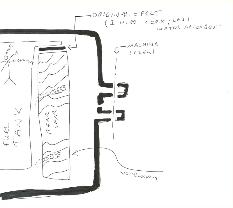

                  I have also not seen those items before (having fixed fuel tanks on both my pre- and post-war Taylorcraft).
                  But strangely, the pre-war one (the subject of the blog to which Lloyd refers) had what appeared to be home-made aluminium strips of about 0.040" thickness by about 1" wide.
                  The post-war Taylorcraft that I fully refurbished had steel straps of about the same thickness but only about 1/2" wide, but these had a "machine screw" (like what to which you refer) to perform the clamping action behind the rear spar.
                  Unfortunately, no photos. But the ends of the steel strapping, behind the aft spar, were bent double to allow the machine screw to pull the ends together.
                  I attach a schematic.

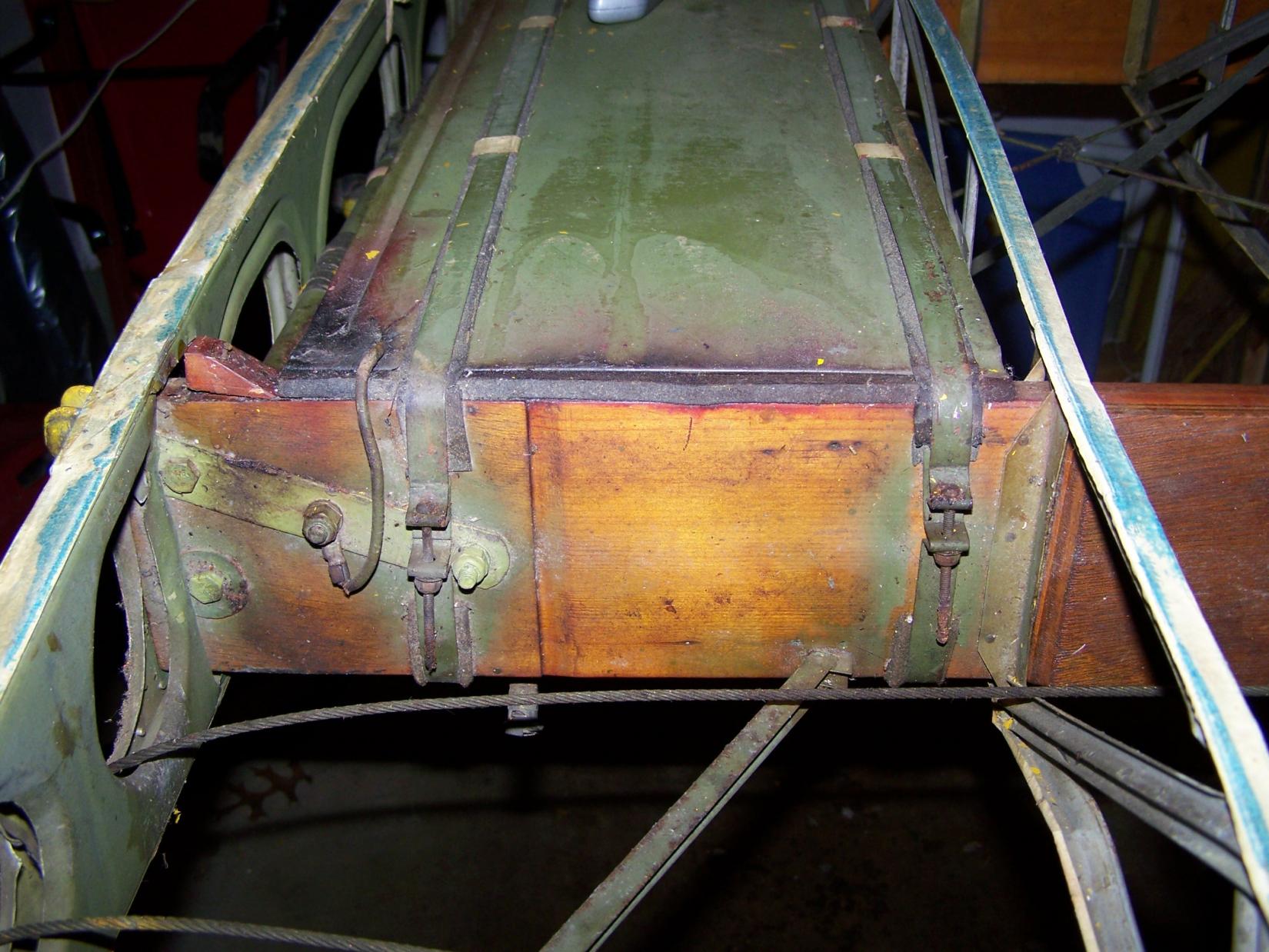

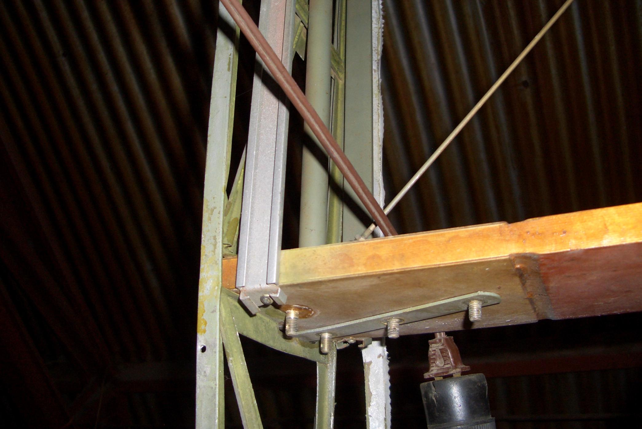

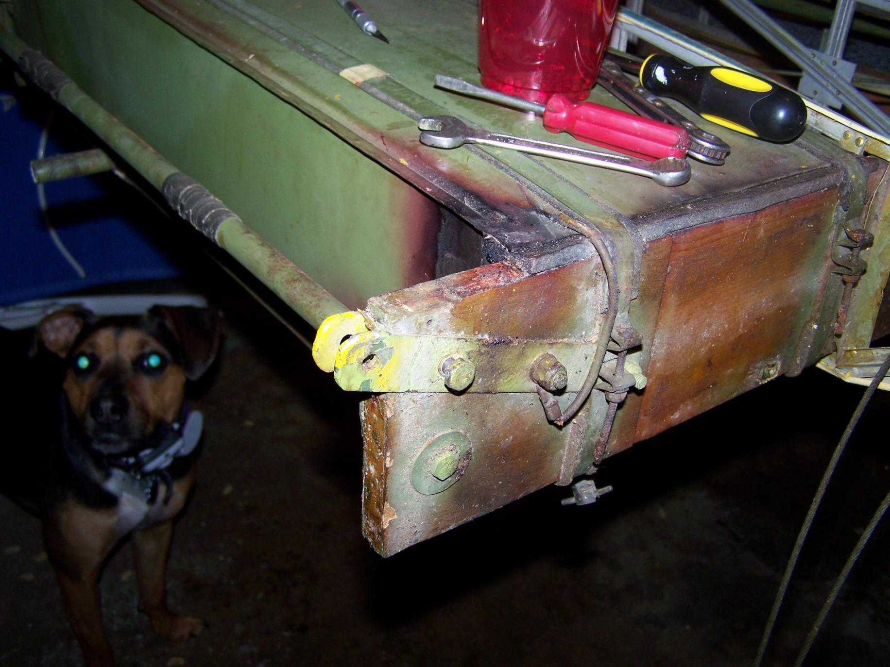

                            Here are photos when I took my wings apart showing the fuel tank straps. These were on a 15 rib truss style wing for what it is worth. My other wing was a stamped post war wing, and in eyeballing the other they appear to be the same...
