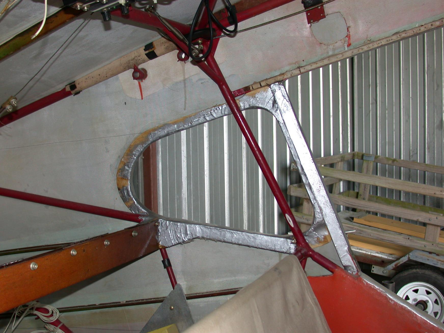

        Just send the photos to hjarrett2 at cox dot net and I will post them if you want. Hopefully I can drag out the pics of the other version for comparison.
        P.S.
        Photo of 41 wood frame. Got to take some of post war

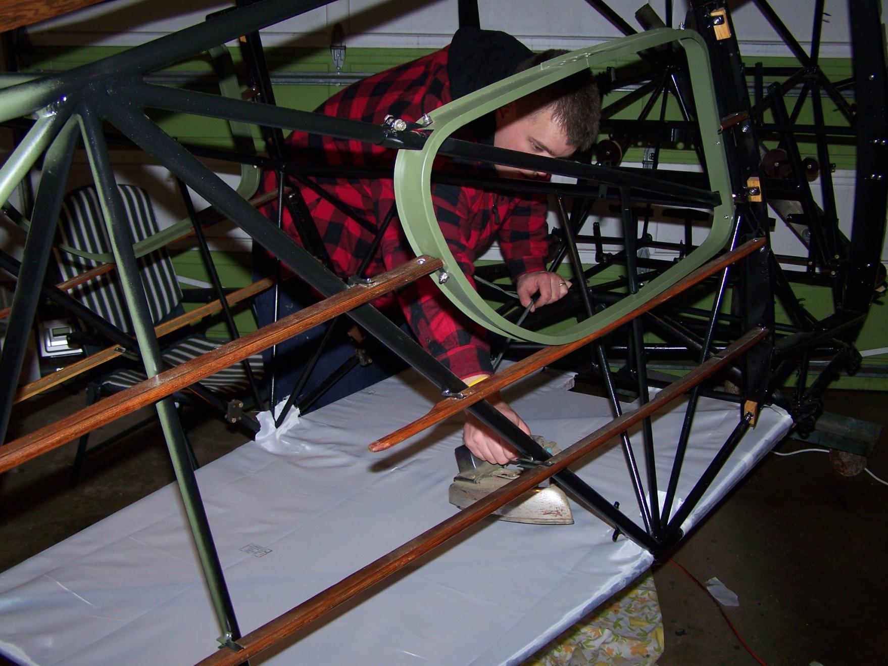

          Sounds like they might be model 19 windows. If they are,we put fabric on the outside frame. The inner goes in after completed and just screws down. Hope this helps

            That helps a lot. That is exactly what we have,but the baggage compartment is completely made of plywood except for the top. Bottom is 1/4" and the rest is 1/16" with wood frames for stiffeners.
            These pictures are invaluable. Do you have others on a website? We really appreciate the help. Larry Huntley

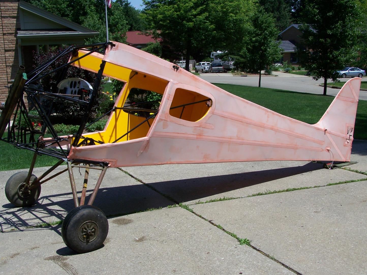

              There are some on my gallery page (around page 7 or 8 I think...). My Gallery is called Ryan. I don't have a website, but I do have pictures we have taken. Let me know what you need. Out Tcraft is still a 65hp so it does not have the extended baggage. I just used fabric to give it that appearance, open it up, and look nice with the large windows. I left the sling mounts for carrying baggage.
