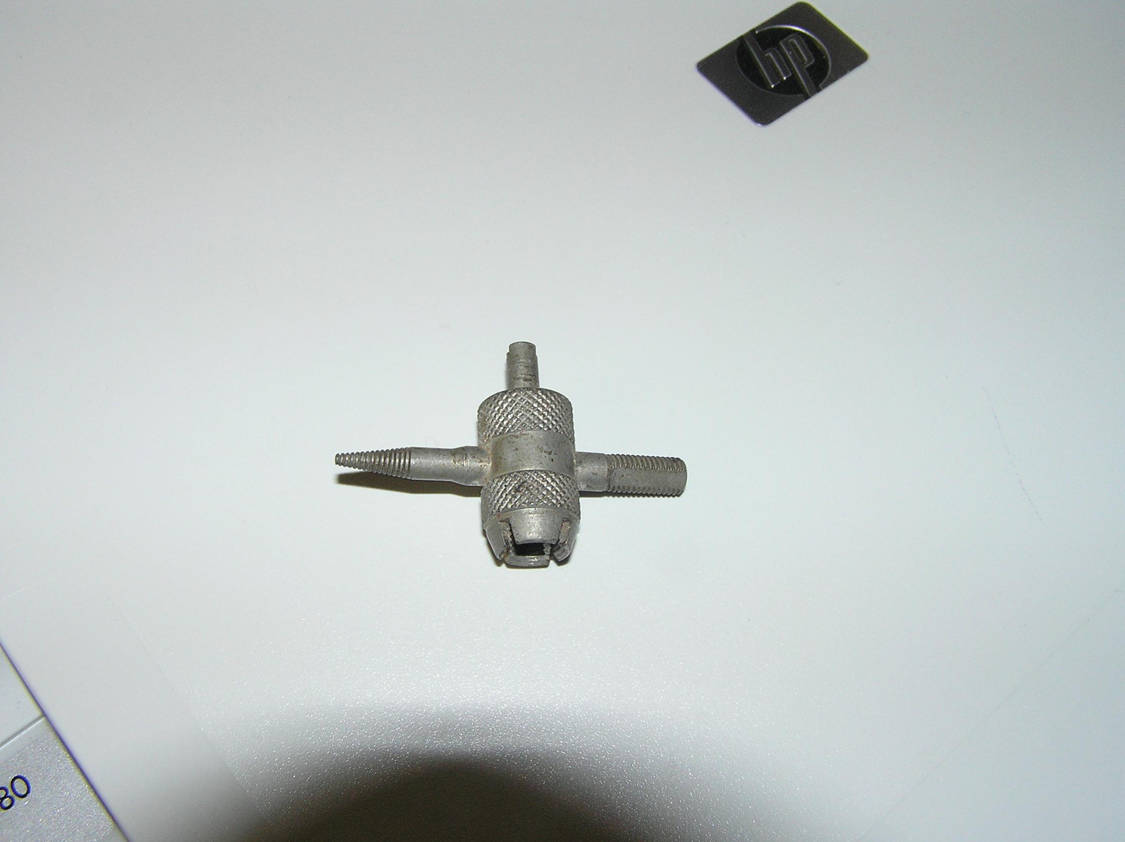

Here is a old valve stem tool that is for working on truck tires that I use to hold the valve stem thru the wheel while I put the wheels together. On one end it has threads to screw on the valve stem and a valve core removal tool on the opposite end. You can probably find one at an automotive supply.

COOL Buell! That's different than the one he used, but looks like just the ticket to work. I had something similar made of plastic that stripped out (tried several of them and they all just tore the threads out). I never thought to look harder for a metal one.
