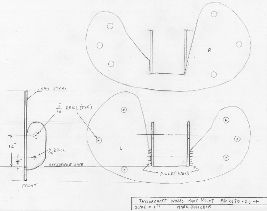

        The mounts are not difficult to weld up. in the past, drawings have been posted here for these items. If you can't find a drawing, I can probably trace my set of wheel pant mounts for you and you can get them built fairly easily. It is a simple weldment.

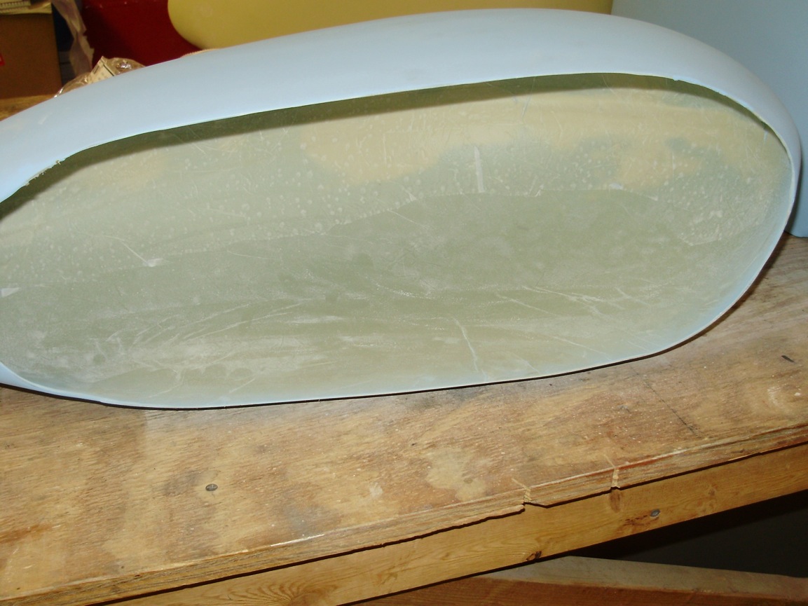

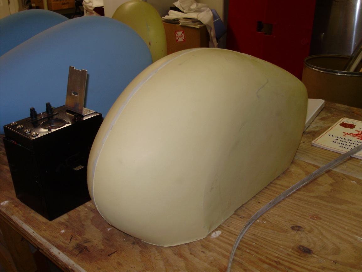

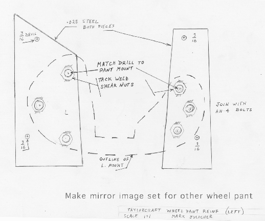

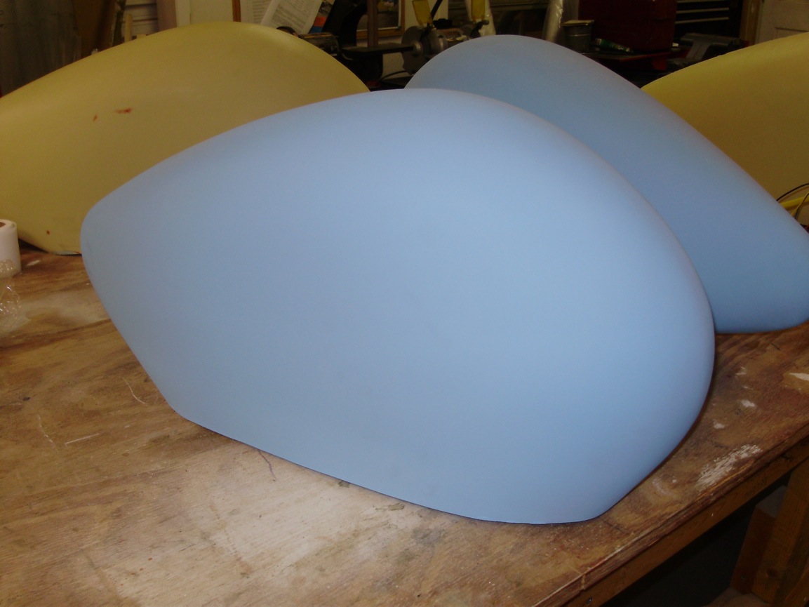

                          The local aero fabricator wants $550 per set to make wheel pants, and maybe a discount for a quantity order. This is a very good composite mfgr here, however, Wag Aero and others are asking less than $400 for acceptable wheel pants.
                          Wag also has a hardware mounting kit for the reasonable price of $119. You can make your own set from my drawings, but it will be tough cutting .090 steel in most of our personal garage-shops.
                          The yellow pant is a factory original smoothed with Bondo to make the mold. Note the chrome trim piece which covered the weld line. The blue pant is a new fiberglass fabrication. Very fine quality and very light. It will need some reinforcement added to make it stiff enough to suit me, but I will do that when we mount it.
