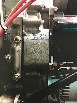

    The attached pic shows the left side of the C85 Case, with the "Transfer Plate" noted.
    Once the Transfer Plate is removed, two holes in the Case are exposed. Oil can then be squirted into the top of the two holes which then goes directly to the Oil Pump.
    Trust this info is useful !

      -12 engine
      Sully
        C85-12 for sure !
        How can you tell from the pic ?
        Jack
          the -8 doesn't have the oil transfer pad.
          Sully
            Thanks Sully !
            Got that Hank ?!
              Yes, mine doesn't have the transfer pad either. So far I have had pretty good luck with lifting the tail, but she has been parked for a long time while I flew the 172. I want to get back to flying the FUN plane!
