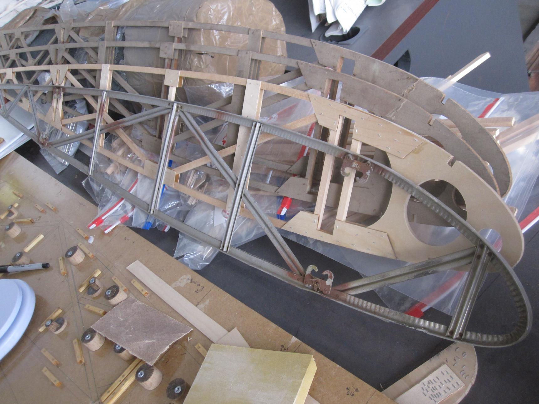

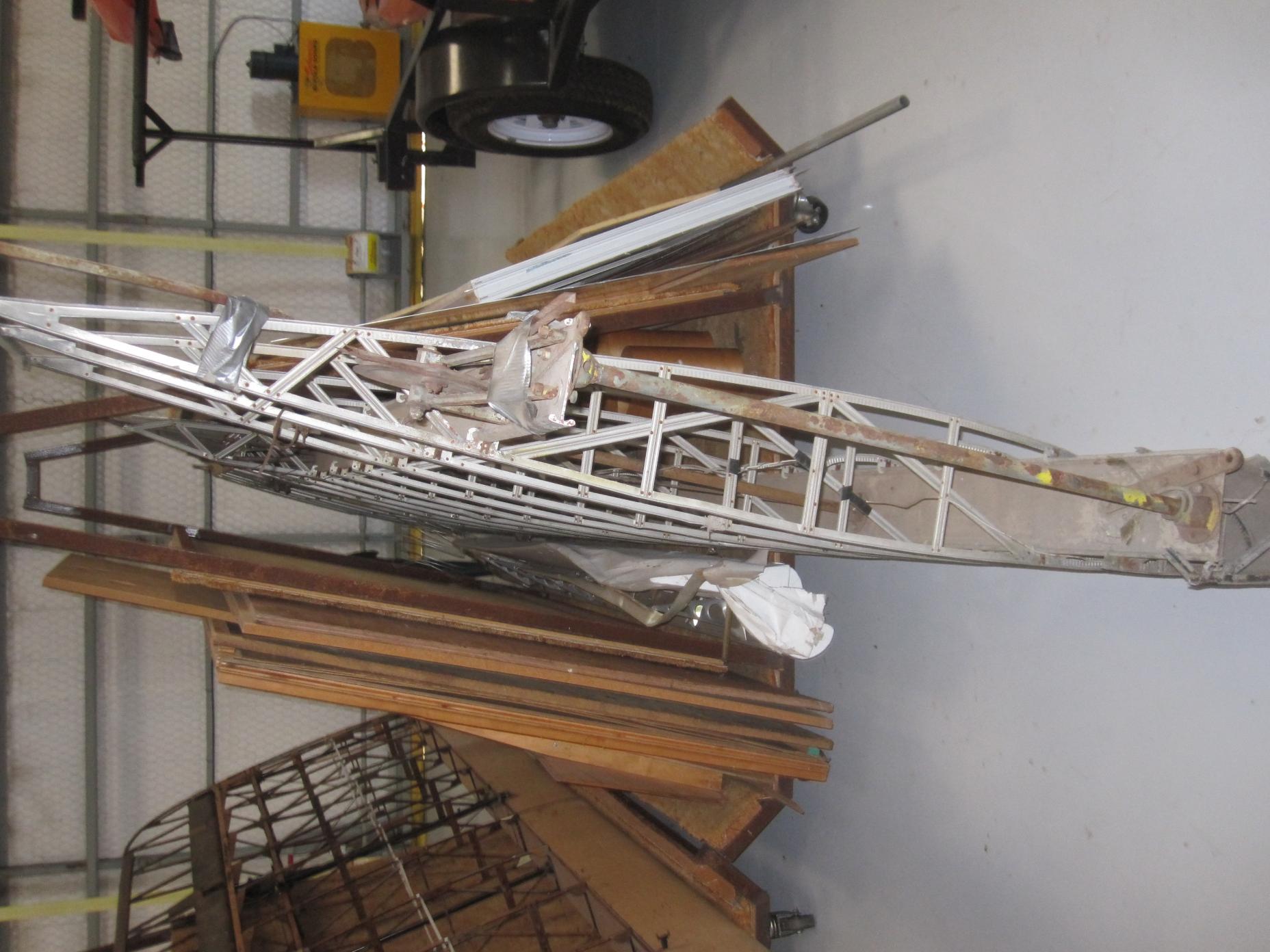

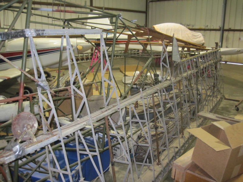

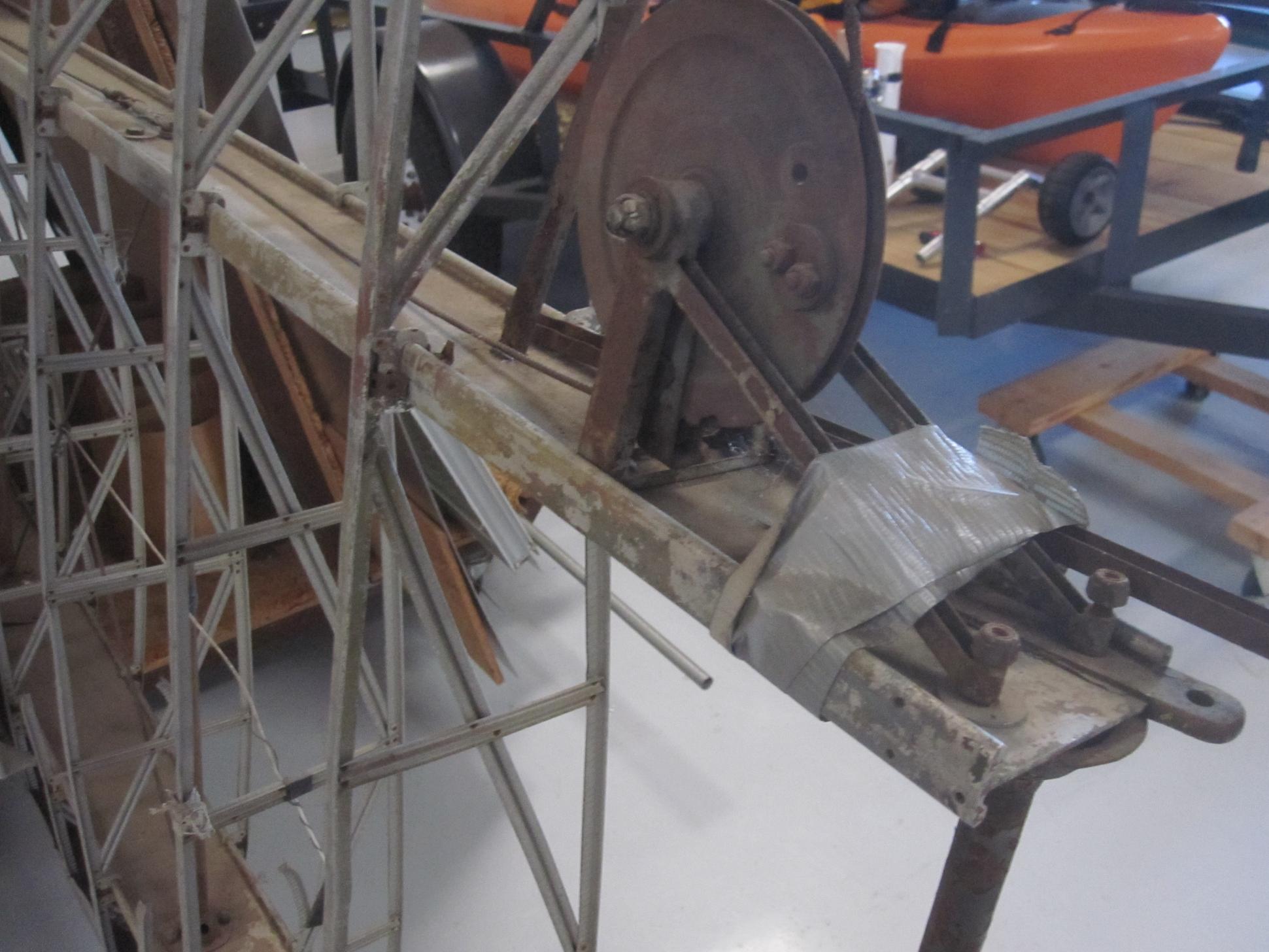

                    I don't know of any DC's but my YO-57, s/n 4008 has metal wings. Here are some pictures of the wings, obviously in need of restoration. The pic of the ribs shows how they attached to the I-beam type spars. The metal rib is from the YO-57, the new one is from a set I built for my TG-6/L-2 and the others are factory from another L-2A/B. As a matter of interest the metal is lightest. They weighed: metal - 23.2 grams, factory wood - 27.7 & 28.3, mine - 30.6 grams. Mine is probably heavier because I used 1/4x1/4 in some places instead of 1/4x3/16.
