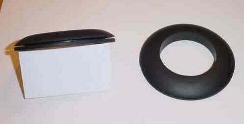

                        I just got this email below (and the picture) from David Jackson:
                        Hi Tim,
                        Thanks for your inquiry. The grommets I sell will work on your Taylorcraft, and I have sold them to many T-craft owners over the years for their restorations.
                        Dimensions for the filler neck grommets I have available are as follows:
                        ID: 2 1/8" (made to stretch over standard 2 1/4” OD filler necks)
                        OD: 3 1/2"
                        Thickness: 1/2"
                        Exposed Thickness: 5/16"
                        Groove Thickness: 0.032"
                        Groove ID: 2 7/8”
                        The filler neck grommets are $41.00 US each + $5.00 shipping / insurance each.
                        Payment may be made via PayPal, or by money order or bank cashier’s check made payable in $US to:
                        David B. Jackson
                        1200 Hudson Drive
                        Mansfield, TX 76063
                        USA
                        If paying via PayPal, please let me know your PayPal account address, and I will send you a PayPal invoice. My PayPal account is my e-mail address: (Tim deleted David's email address)
                        Regards,
                        David
                        Tim

                            Anyway, I placed an order. David said that it was OK to share his email address with the TCraft tribe. It's dbjack at swbell dot net
                            I wish I had gotten this before I reassembled the airplane. Do y'all think that it will be possible to install it with the fuel tank in place?

                              I installed mine on a completed airplane. I had to open up very slightly around the filler neck, do this slowly. I also had to barely open up the filler neck hole. Someone said to use a silicone spray lubricant, or similar. I had to open it up just a bit. Probably make up for paint thickness and or filler neck size variation. Do everything in small increments and you will be pleased.
                              I measured the slot thickness and used this as a basis for the opening in the boot cowl around the filler neck.
